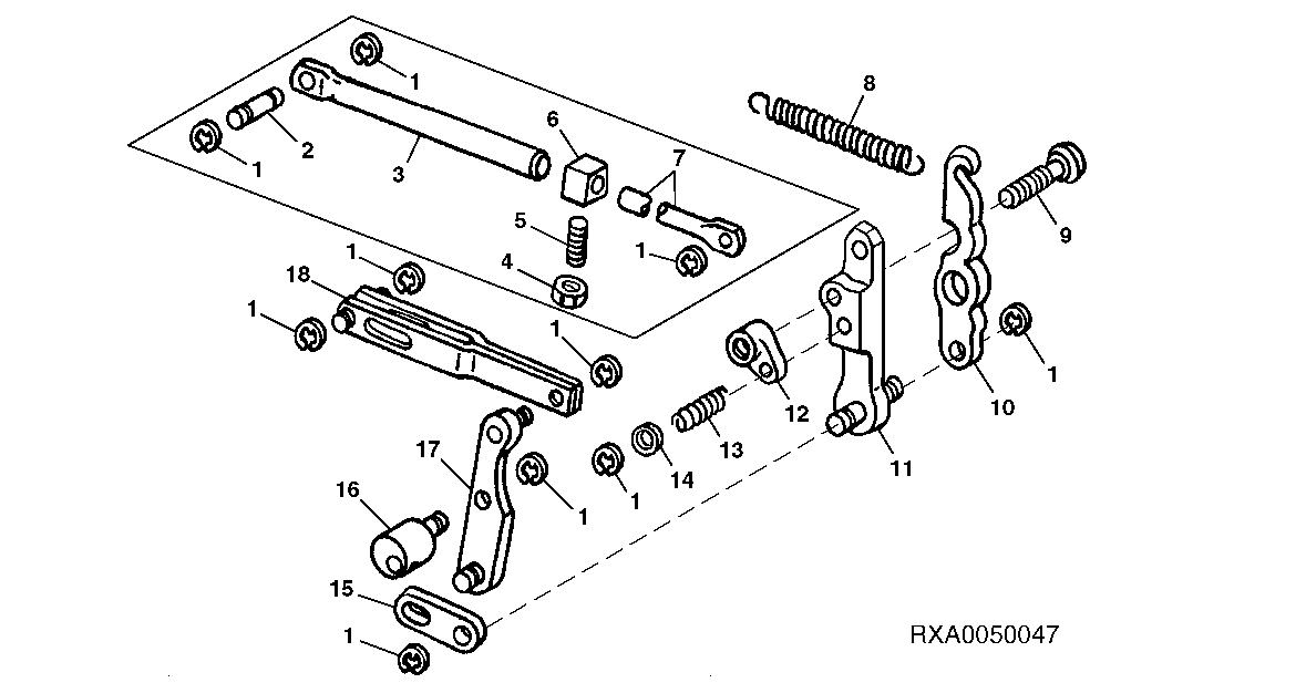

I have a john deere 2040 with a open center hydtaulic system. All hydraulics stopped working. So far I have split the tractor and verified the trans pump is good, changed fluid with filter and cleaned suction screen. I replaced the main pump. The steering is working fine now. The lift will raise and lower but when in the up position hydraulic pressure does not relieve so I lower the lift. The lift also can not be raised part of the way up or down. It is either all the way up or all the way down.
/ 2040 john deere lift #2
Where is L/D control never under seat setting? I'd recommend putting it in "D". The RS control valves may be adjusted too tight. You could try turning screw(parts key 9) CCW a little bit. It's also possible cam(parts key 9) &/or spring(parts key 10) is broken(2nd photo).
Tx Jim
I work offshore and won't be home for a couple of weeks. I will make these checks when I get home and let you know the outcome. I have also checked all the pressure safety valves and dump valve and all are in good condition. If you think of any other checks I can do please let me know. I am not sure I know exactly how the dump valve works and how to trouble shot it.
