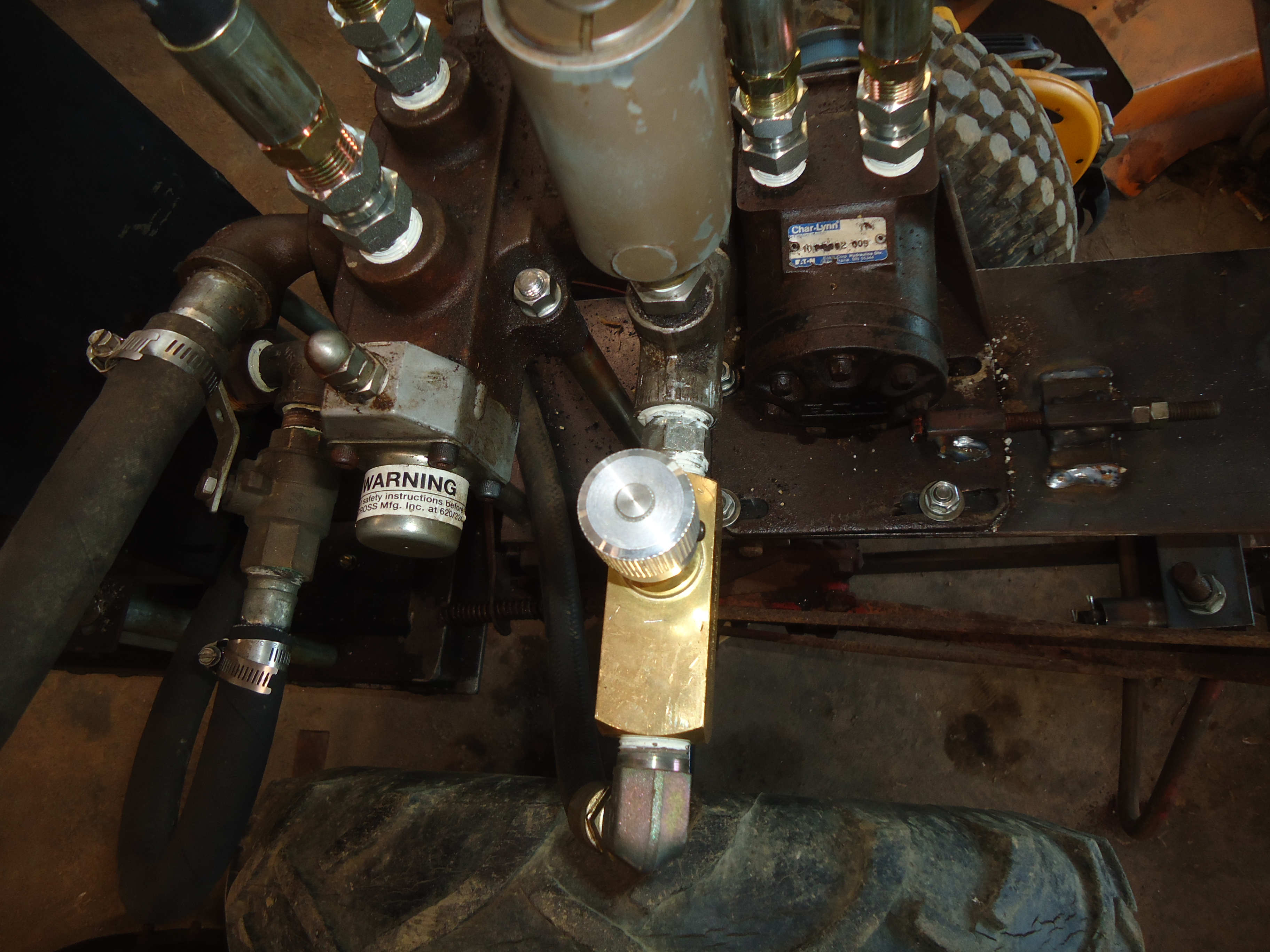

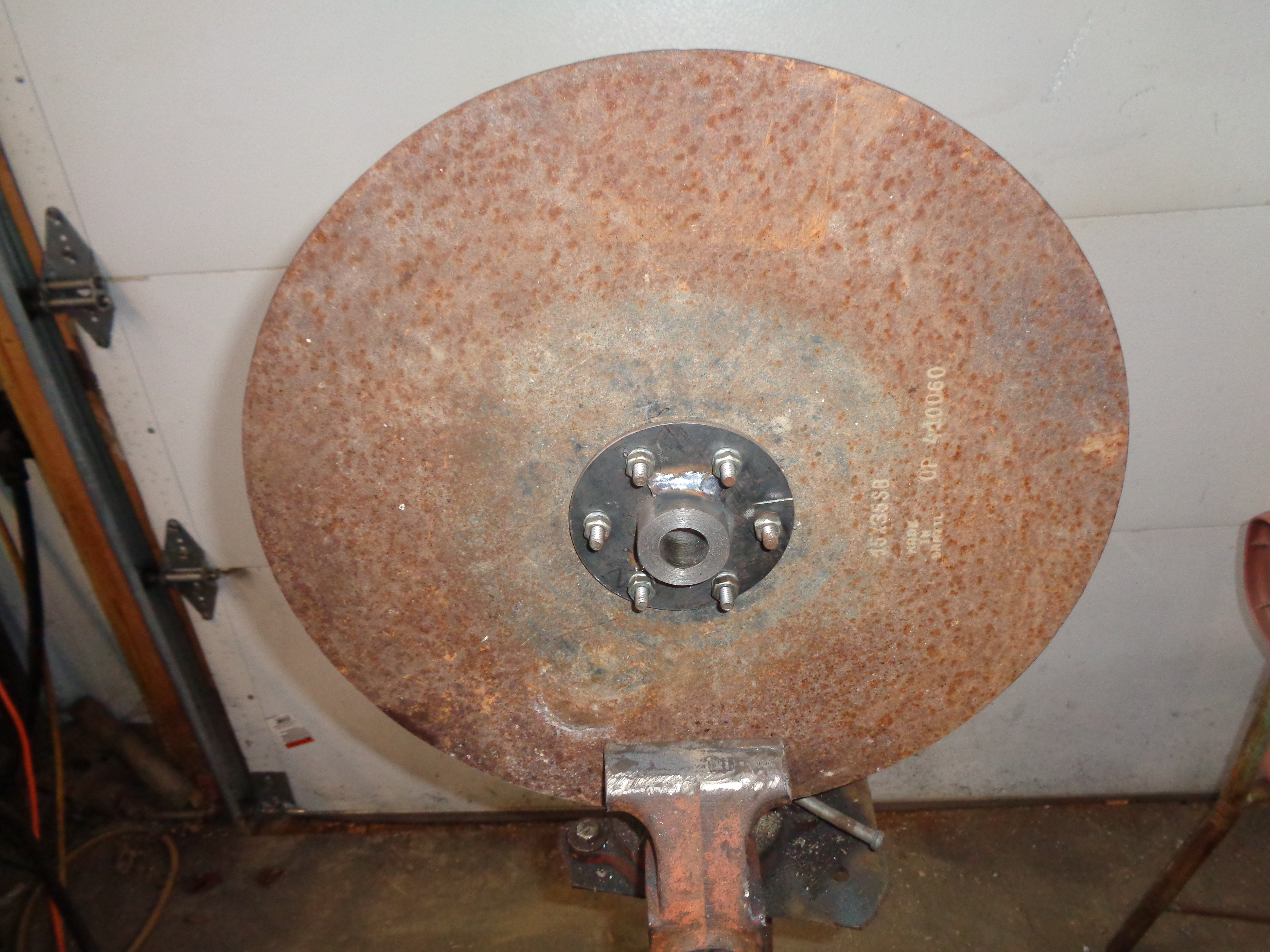

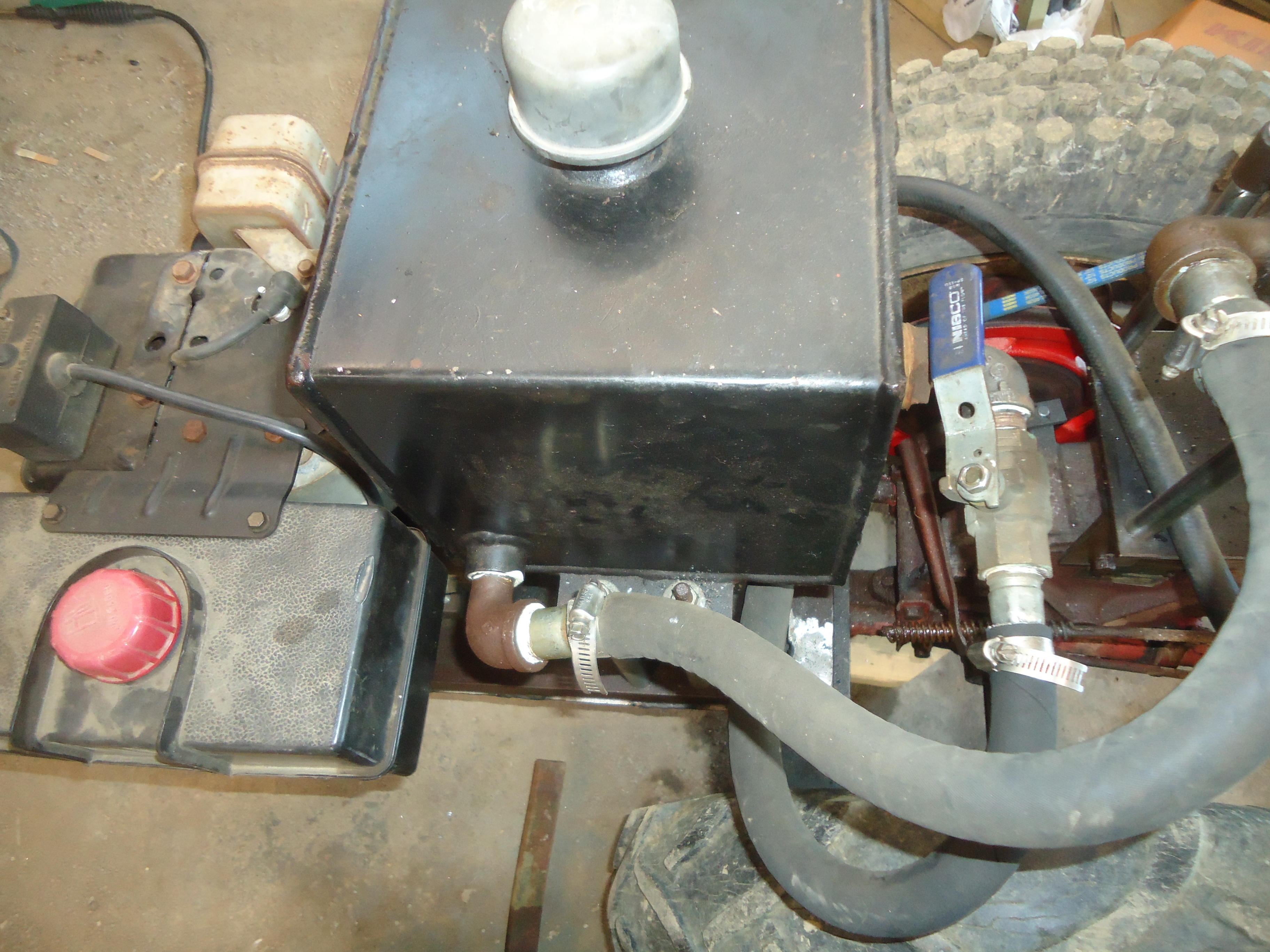

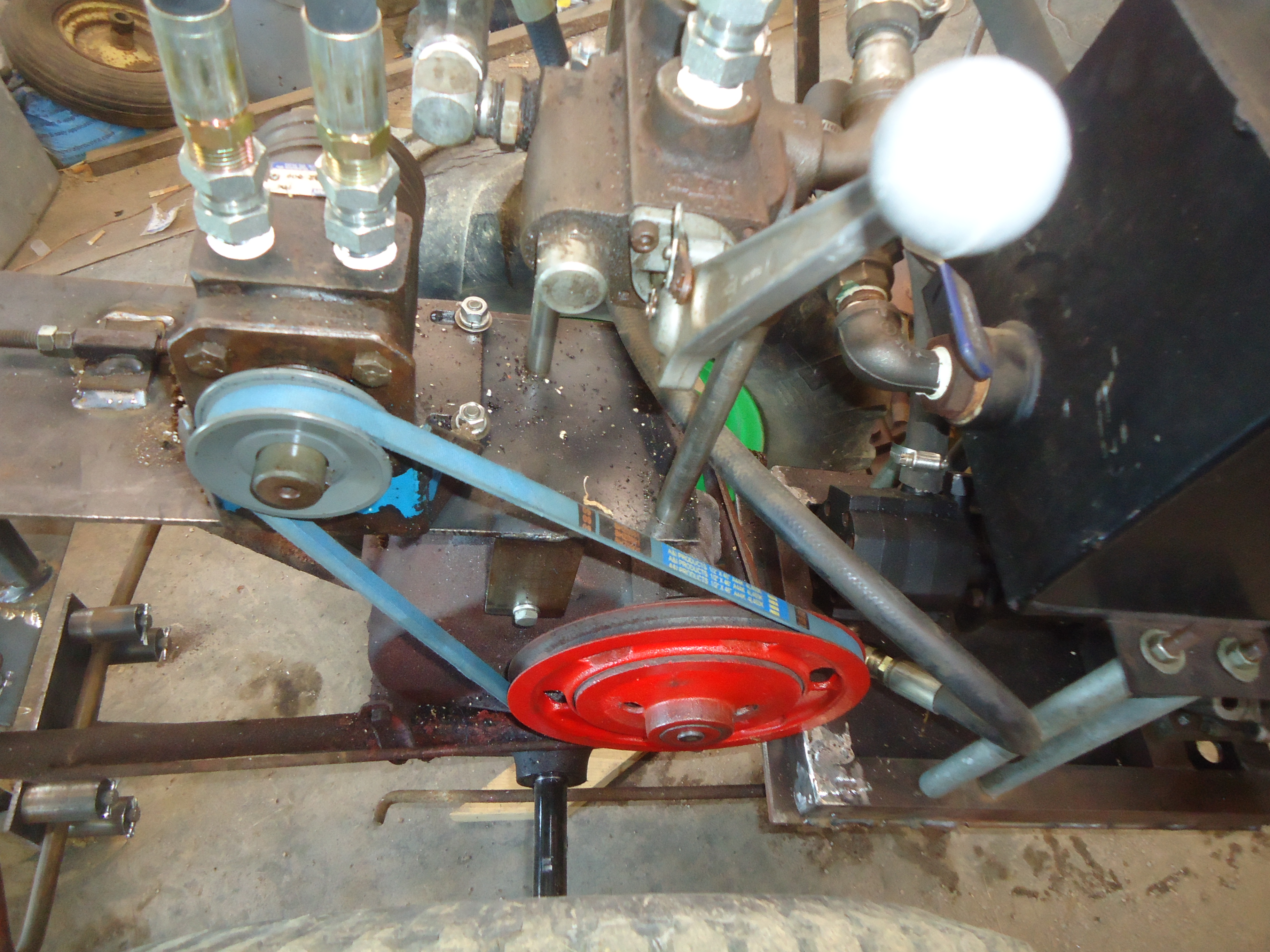

It's pretty crude actually. I took one of the spare David Bradley chassis I had, added the engine, (It's a Tecumseh 5 hp with electric start..!!) hydraulic pump, oil tank, hydraulic valve, and other misc. parts for the power unit. I did add a flow control valve for the hydraulic oil, as I wasn't just sure how fast it would move. It will make just a tad bit of difference, and mostly speed up travel when tramming backand forth to the barn where I keep it.
The hydraulic valve for the splitter is set in the detente/return position, for oil flow to the hydraulic drive motor. I also utilized the OEM DB clutch, so as to pause to drop a plant. The one video showing setting plants non-stop, but I've always put a tsp. of Epsom Salts under each tomato plant, to help prevent blossom end rot. This was the first year I used it, and was more concerned with setting plants. Hence the stopping for a few seconds to add the epsom salts, drop the plant, then move forward the 24" -30" spacing. To simplify adding the epsom salts, I got a hand squeeze sugar dispenser off Amazon. It has several different pieces you put in it to dispense a certain amount of "whatever". It just happened to have the piece that will dispence 1, tsp. of what you need. Sure speeds up the process.
In that video, it pretty well shows the framework. Furrow shovel, drop tube, hiller to cover the plant, and packer wheels to tuck them in. The furrow shovel is what is called an irrigation shovel. Got it from I believe Norwest Mfg. They make all sorts of cultivator shovels, sweeps, etc. This works perfect for what I had in mind. 3" PVC for the drop tube, and a 3" to 4" adapter for a funnel top. The hillers are actually a middle buster for a tiller. I took the plasma cutter, and split it down the center. Welded some small angle iron on the back, so as to attach to the shank. Packer wheels are just some spare lawn mower wheels I had laying around. Tabs the wheels are mounted to are bent at a slight angle to pack the dirt inward, and give some spacing back away from the plant. I've found it worksbest to soak the plants well with water, while in the tray. Just the little bit of extra weight at the bottom,makes the plant stand pretty well straight up when you drop it down the tube. Occasionally I need to take my toe, and straighten one up, if a small clod of dirt rolls inwhere the plantwill drop,and make it fall over.
I built the frame, (way over built..!!) and used a set of depth gauge wheels from a bent up set of DB cultivators. Frame was bent, but the depth gauge set up was fine. I did make a larger set of wheels for it, as the OEM DB wheels didn't give enough space below the furrowing ahovel when tramming back & forth like I wanted. These are worn out opener discs for a no-till planter. I made the hub from 1-1/4" round stock, and bored the 3/4" hole through them on the metal lathe. The smaller disc that is welded to the hub, that bolts it to the "wheel were cut with a 4" hole saw on the drill press. And just used the holes that are in the wheels to bolt them on.
No plans were ever drawn up. No fancy computer programs involved. I just had a picture in my mind of what I wanted to build, and this is the result. Sometimes it's good, to have a good imagination, even better if you can build it. The only thing written down was some measurements for this & that, and degreeof angle needed to make the drawbar the same as other DB attachments. I do need to add one more thing at the moment. A tool box to hold several wrenches,pliers, and a hammer to make depth adjustments on the furrow shovel, hillers, and packer wheels. Other than that, I'm happy with the results, and works very well for me.

DJ,
All those hydraulics to drive the planter ?

DJ,
Probably looks like a lot, because it's so compact in one spot. Supply line to pump. From pump to valve, valve to motor, with flow control before motor, then return. Probably should have put a filter on the return line, but to be honest, not that much room, and not like it's going to have much of a chance to get dirty, or contaminated. It was a home made woodsplitter I used for parts, and it didn't have a filter on it. I figure the damage is already done if there is any.

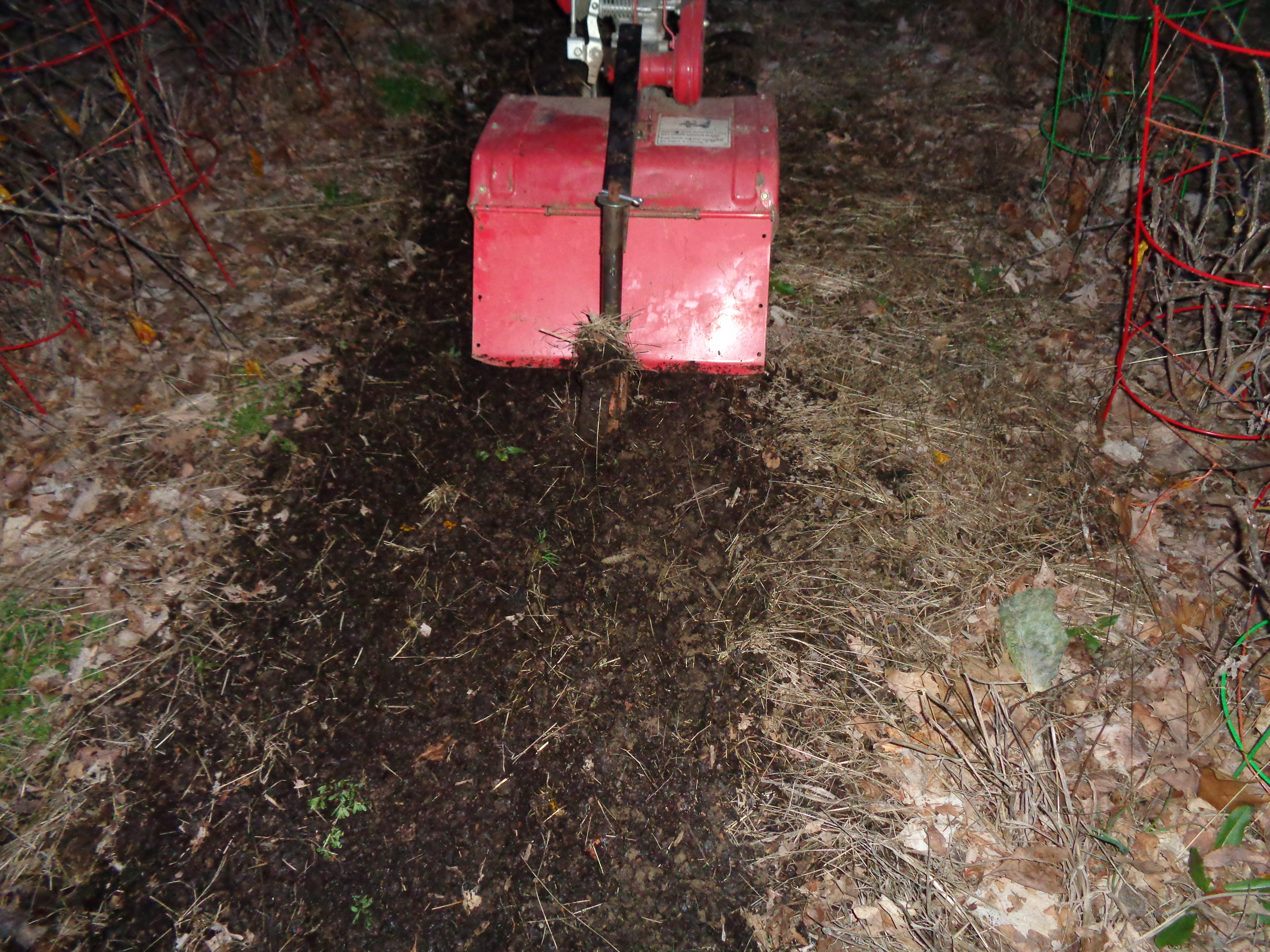

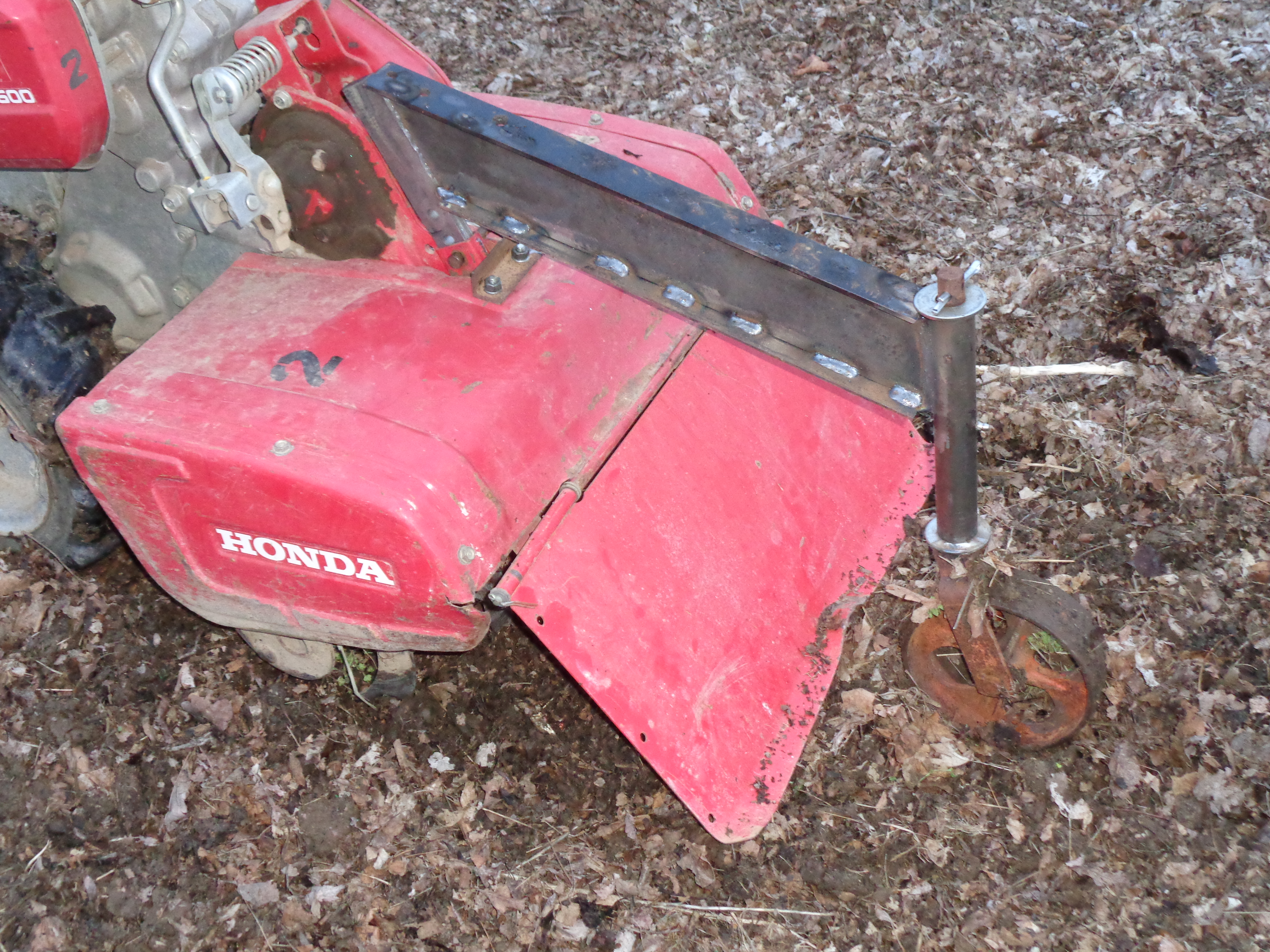

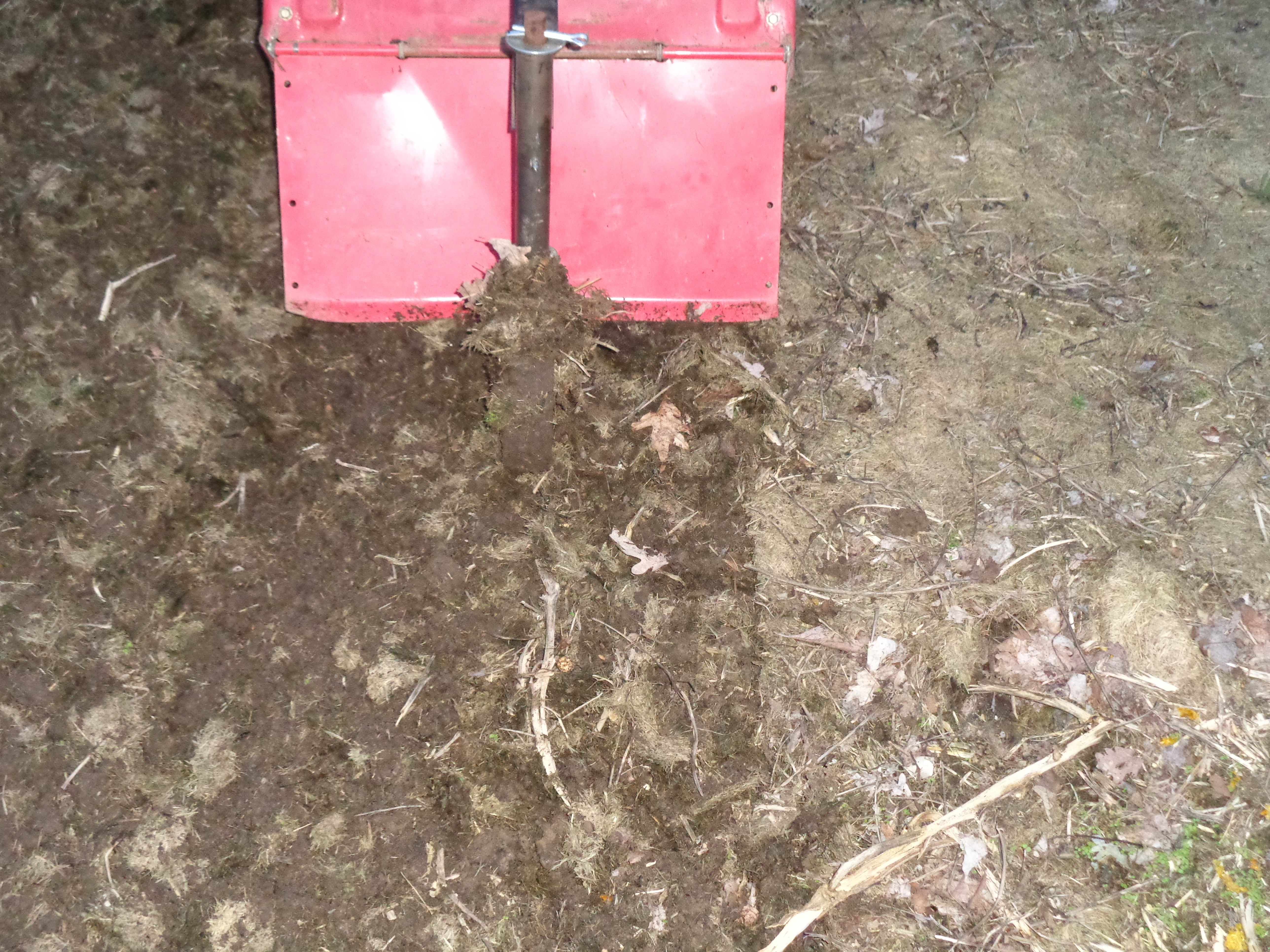

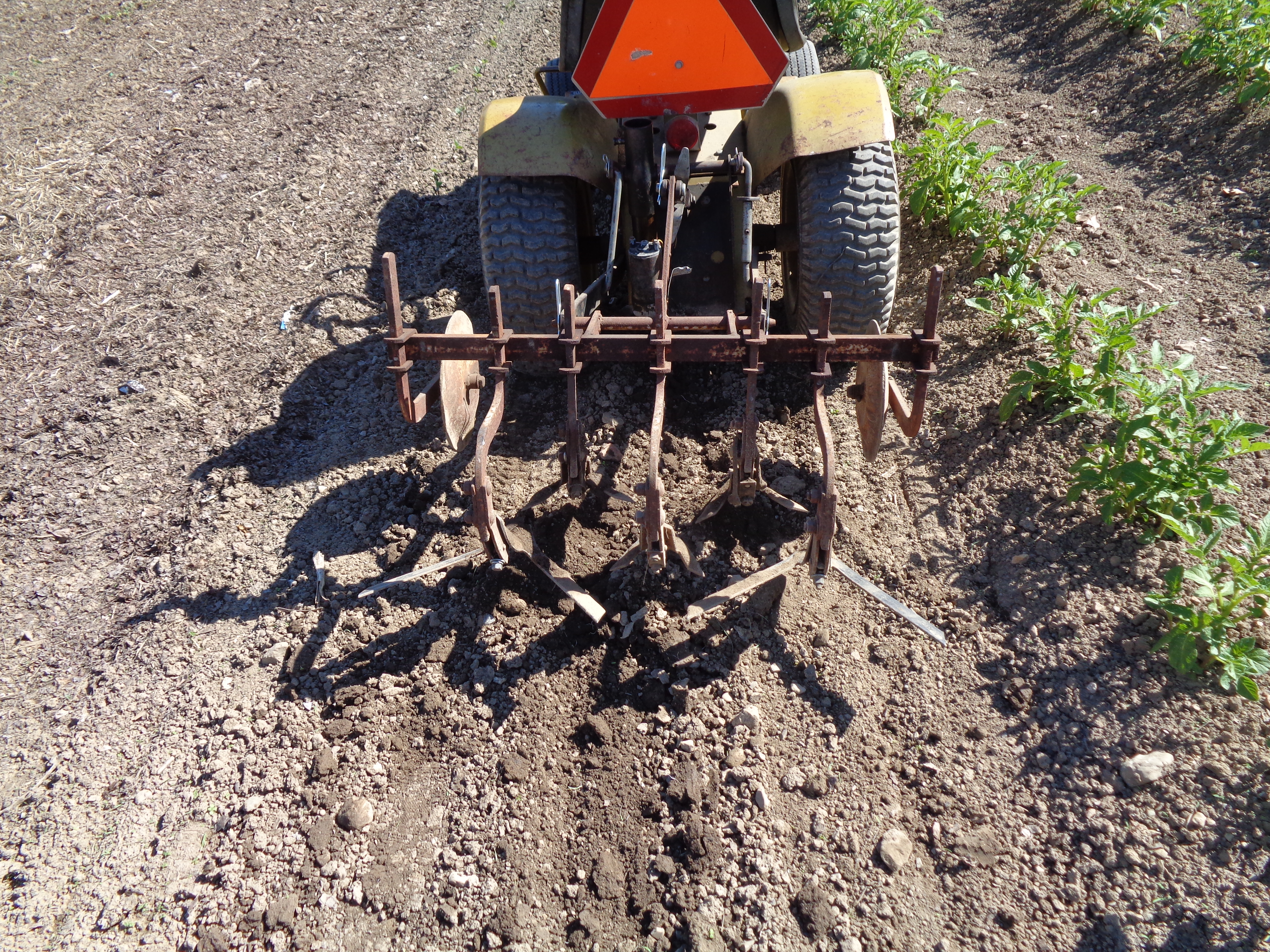

Here's a picture of my latest weed slayer, for between wide rows for the tomatoes & potatoes. Narrow sweeps in front are the OEM Sears sweeps, and are 7-1/2" wide. Rear middle one is an OEM Sears/David Bradley sweep from a DB Southern cultivator for a walk behind. The large 14" sweeps are from Agri-Supply. I could have set them wider, but I have them set as wide as the tires, and use them to gauge distance from plants. Worked great..!!
And, a short video of using the tail wheel on the Honda tiller. Man, I'm loving this thing. Got the depth set to just scratch about an inch or so deep, to turn those litle weed thread roots up. The wheel allows it to float across that leaf residue I put down, and not gob up/drag along on the drag type depth gauge. MAH00553 - YouTube
