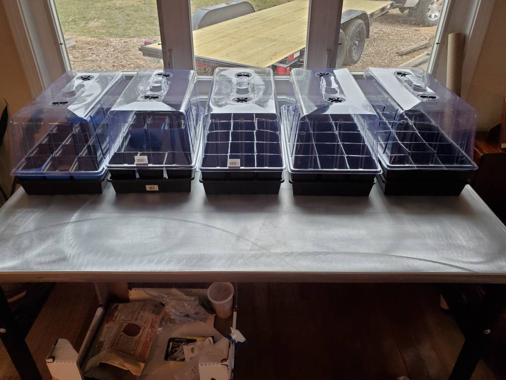

Red kuri squash just sprouted, only waiting on the litchi tomatoes now. More seeds will be planted soon. Need to separate the other squashes. Do you separate your onions and shallots? JPEG_20200330_101620_8623091345137379991.jpg

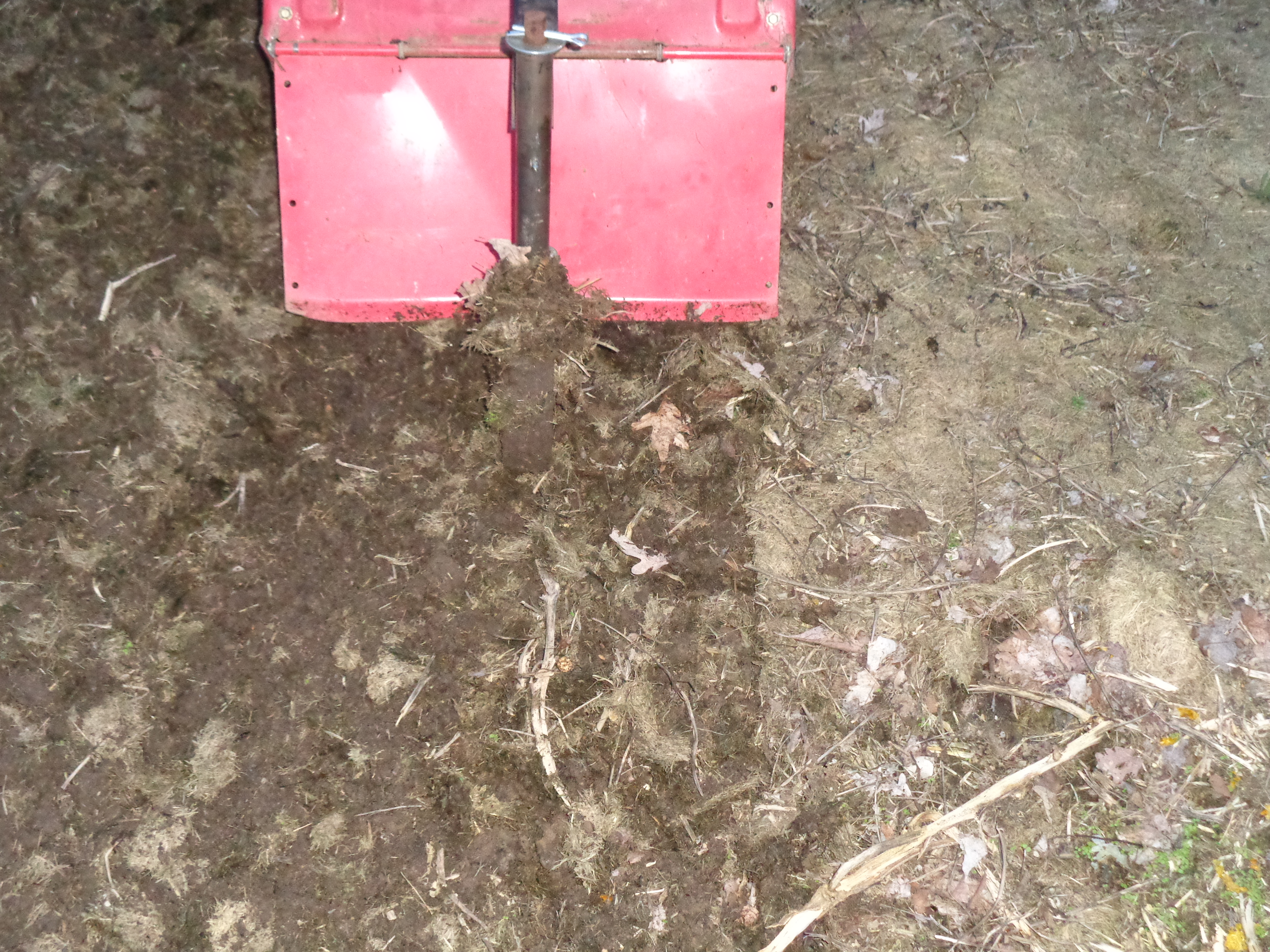

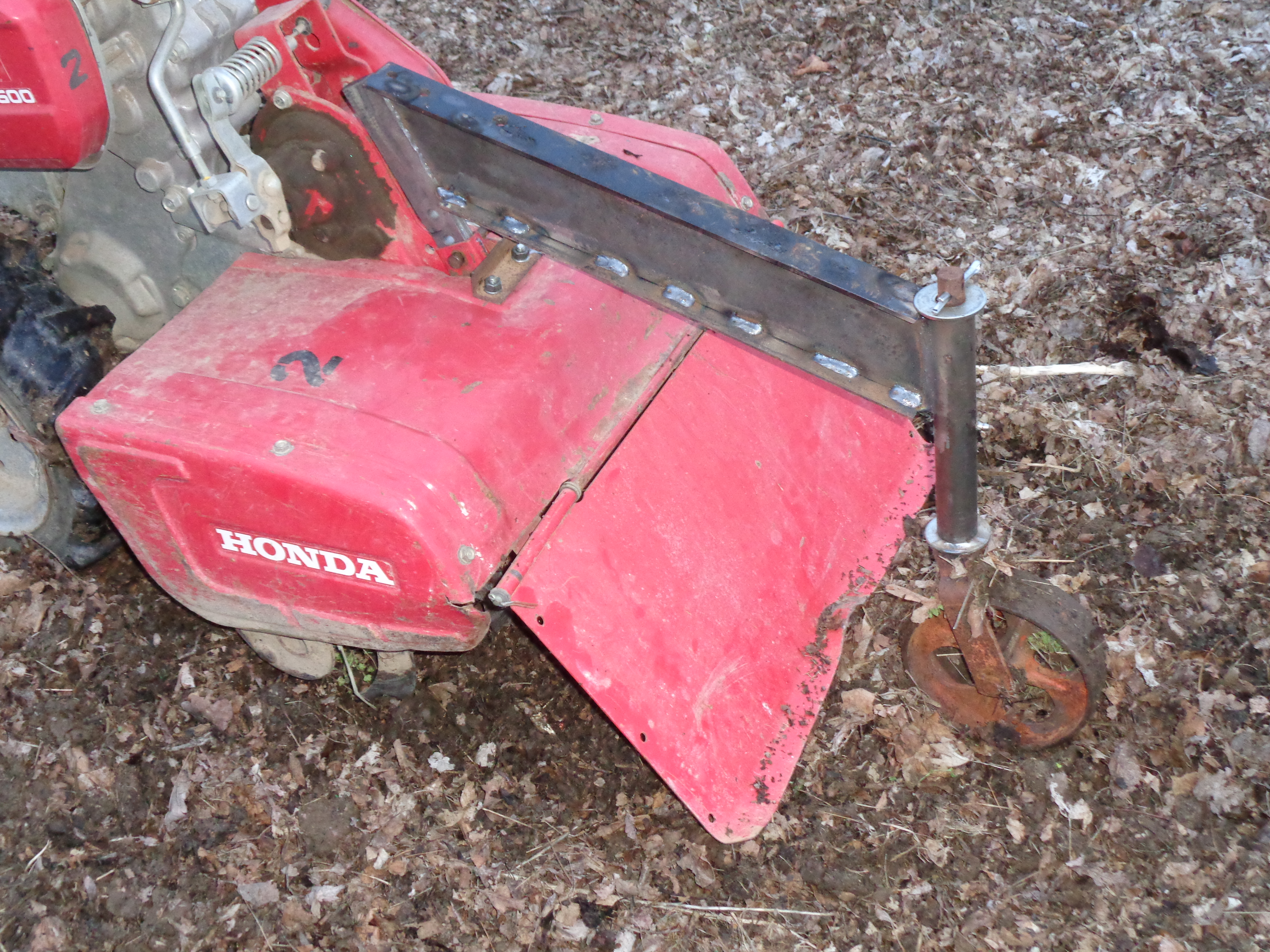

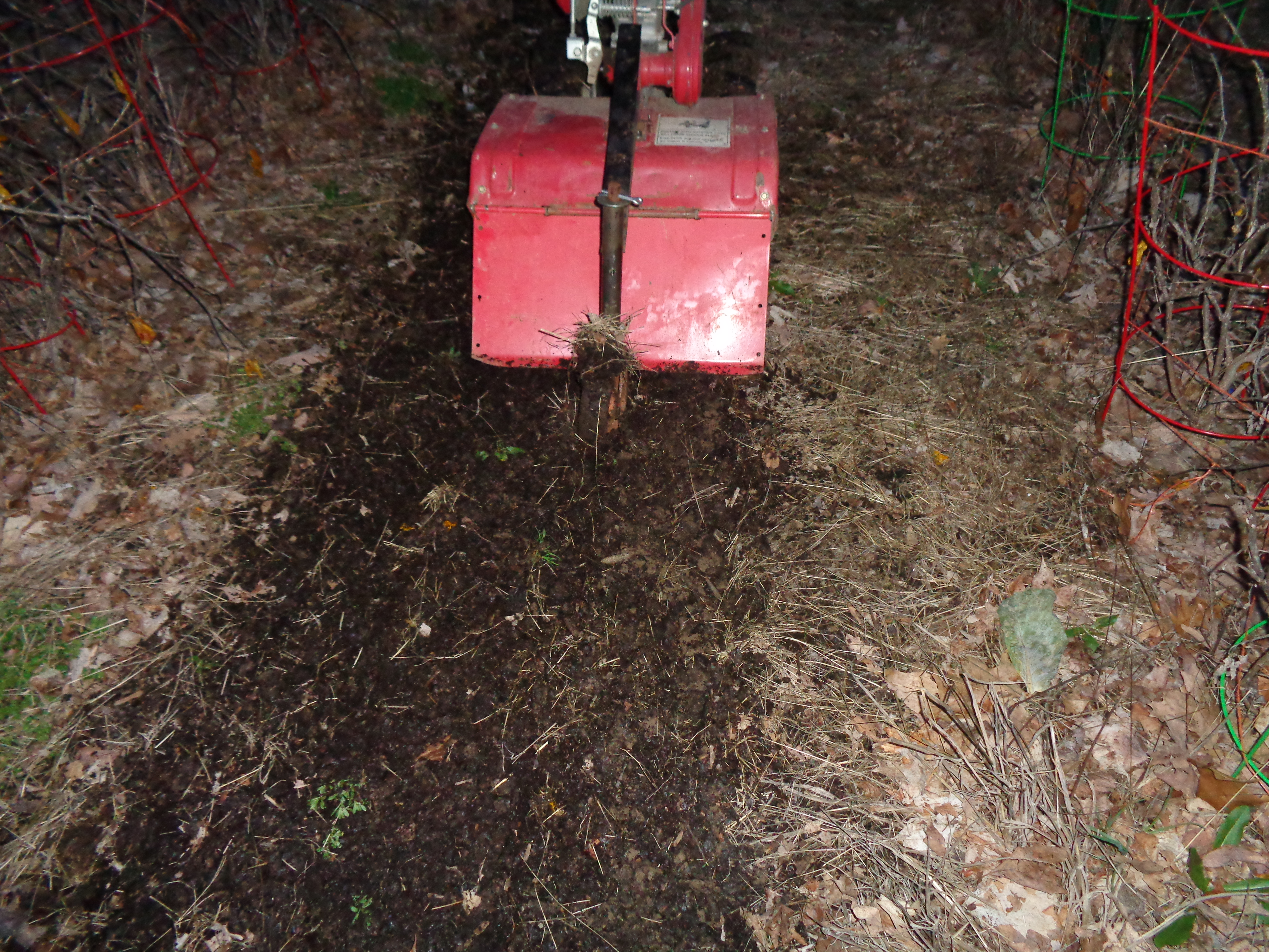

Latest shop build, tail wheel for the rear tine tiller. Being I plant in leaf mulch from previous years, and also mulch around new plants, had problems with grass/Foxtail sprouting up in the leaves, with all of the rain the past 2 years. Using the tiller, with the depth bar, it drags leaves along, leaving bare spots, and gobs of leaves when you stop to clean it. Decided last year, maybe a tail wheel would be better. Really wanted a larger wheel (6"-8" like off a Woods mower deck, but saw this one at an auction last Fall, and got it for cheap. It works much better than anticipated..!!
Finished it last evening, and decided to take it out for a test run, before painting it. It has 5 depth adjustment holes, and this is in the middle hole. Did a great job of just skimming about 2" deep in the compost, flipping out chickweed that starting, and small clumps of grass that had started last Fall. Beats grubbing it out with a hoe, of chemicals. Setting the wheel an inch or two deeper, should justflip the deeper leaves enough, to get an weeds grass that may start on top of the leaves, and fluffing them up.

Might want to add a scraper to keep the mud from sticking to the wheel. ----The wheel would then roll better. Otherwise it should work.

**Might want to add a scraper to keep the mud from sticking to the wheel. ----The wheel would then roll better. Otherwise it should work.**
I intentionally let the mud build up, to see if it would stop the wheel, but it didn't. It was way wetter than when I should be using it. I figured if it will work in these conditions, it ought to work anytime.
Got a couple coats of paint on it today. Also started another build, for a hiller behind the little Sears tractor. That 3 pt. hitch will spoil a person..!!
