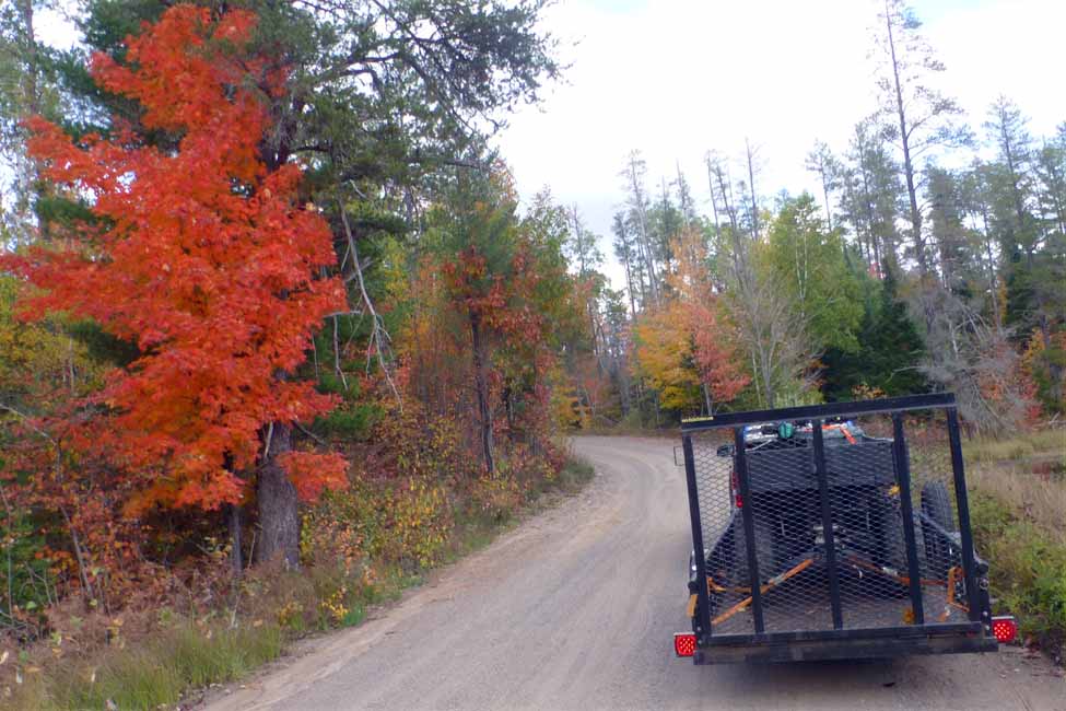

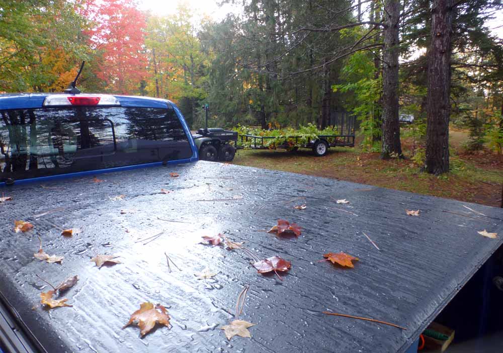

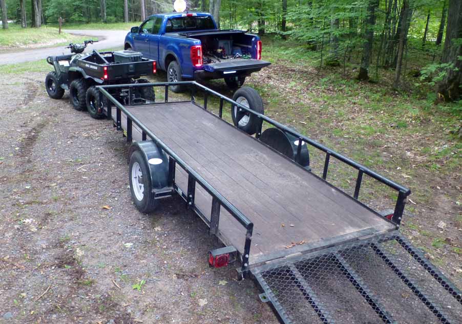

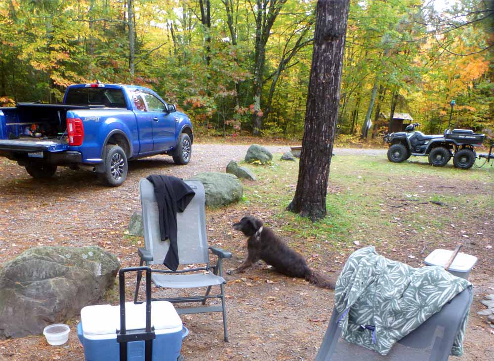

Here are photos of da Ranger this fall. Anyone else have some to post?? Any questions about the truck??
