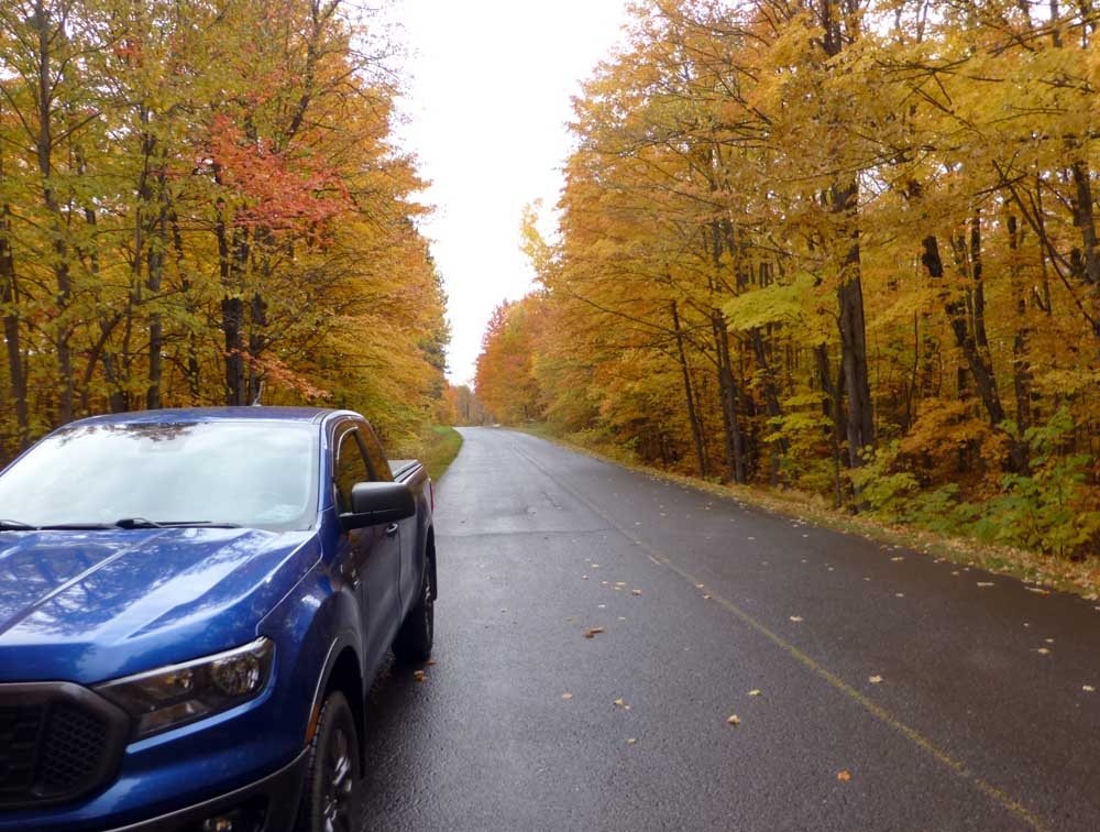

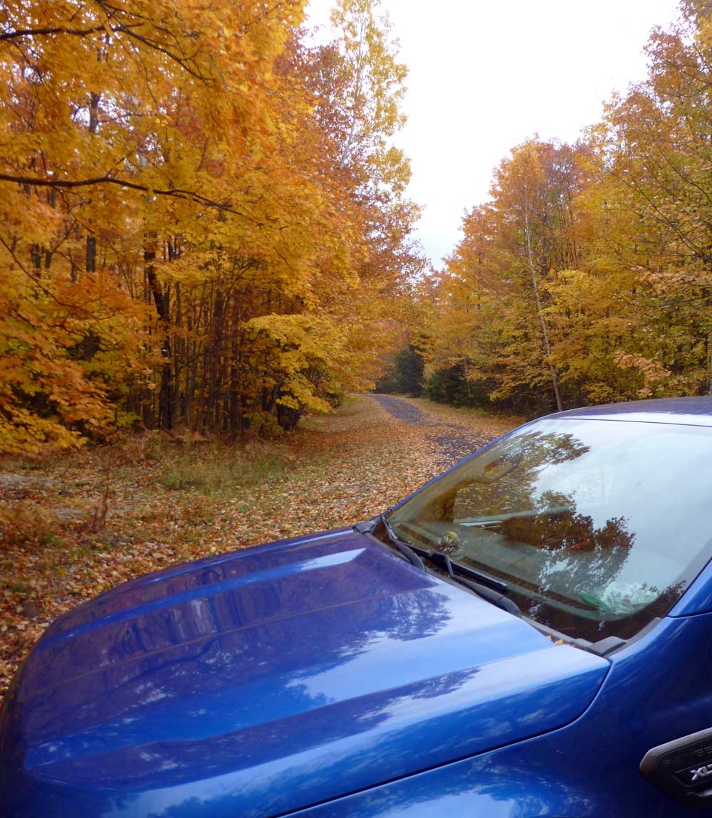

Our ranger out over the weekend in fall colors.
