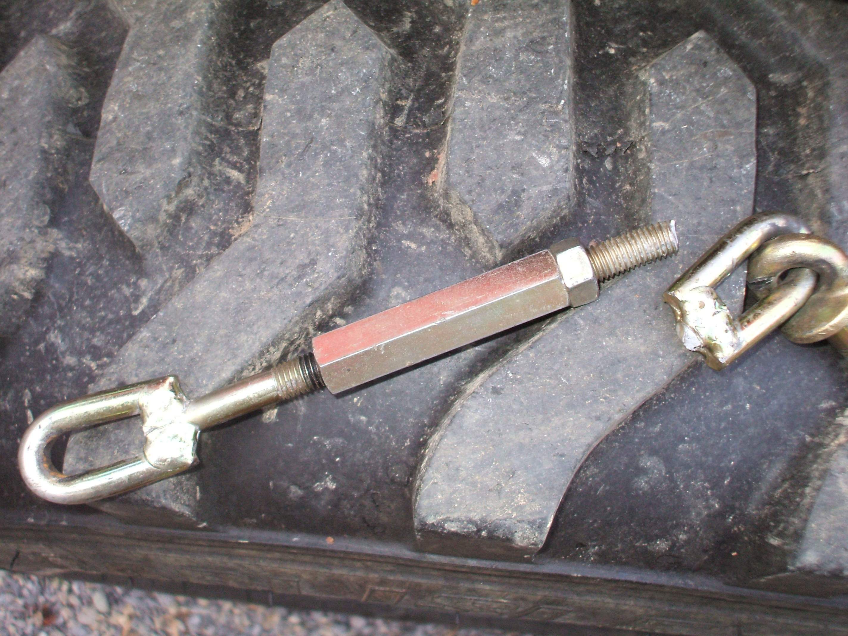

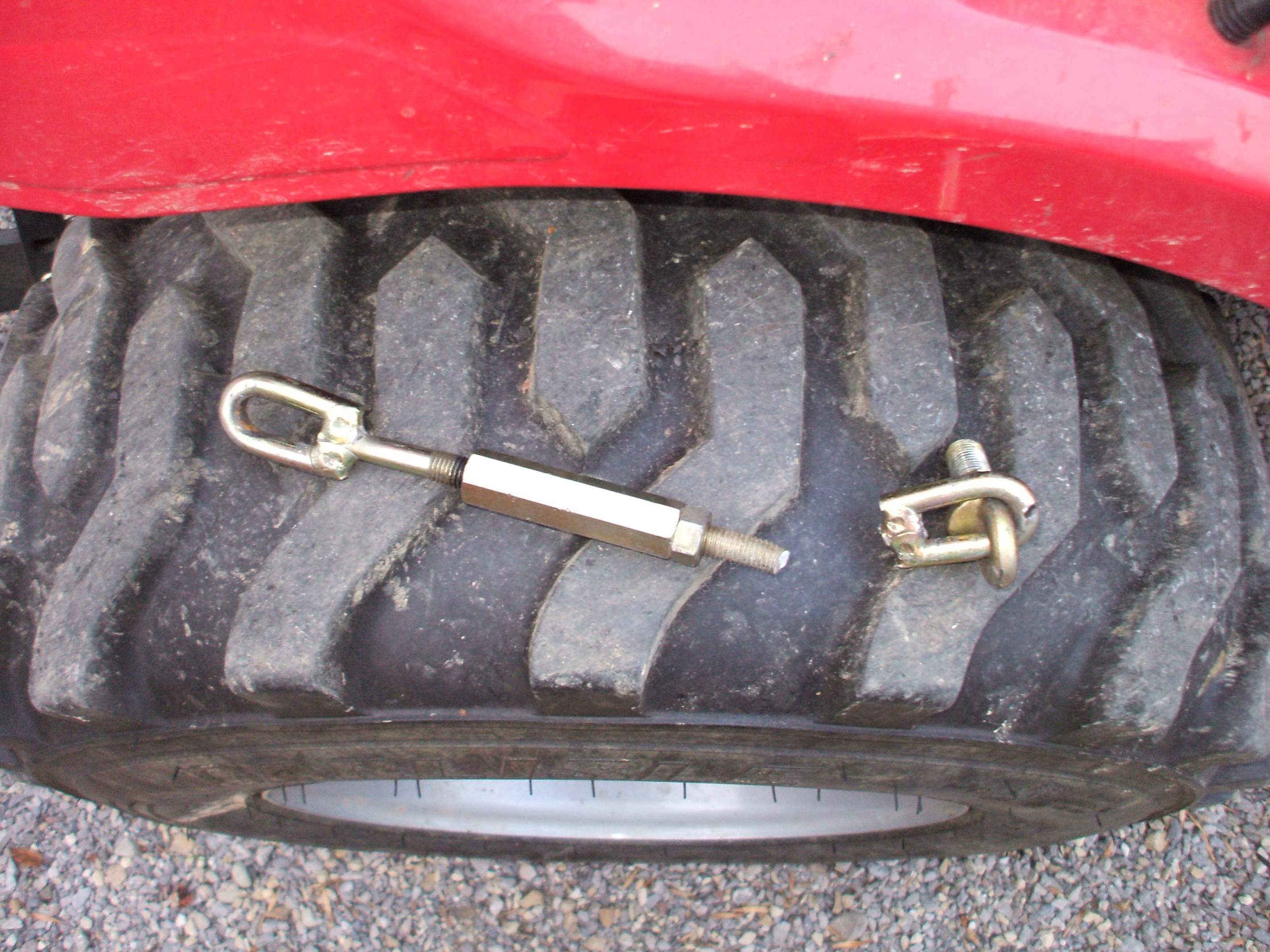

I was using a single blade plow to put in my underground dog fence today and was down to the last 20' when I heard a snap. One of my 3 pt. stabilizers broke in two.:eek:
Anyone know where I can find one of these and what the cost might be? TCS didn't have anything...

If you can post a pic of what broke I can help with a part number but you'll probably have to go to the dealer to order it. You could also have one of our Mahindra dealer members order it and ship it to you.
/ 2015 stabilizer broke
Here it is. It's the stabilizer that keeps side movement reduced. Anchors the RH lower link to the tractor.

My suggestion would be take the broken stablizer to a welding shop and have him to re-weld where it broke at the weld point rather than purchase a new one.
/ 2015 stabilizer broke #5
Same thing happened on a new Kioti CK20 I bought. 5 minute welding
job, and I am slow. Crappy weld at the factory.
/ 2015 stabilizer broke #6
You can buy just the broken end assy. you need and thread it into the turnbuckle. It is in the Mahindra parts book as Part# 1963 3018 000 and it comes ready to thread into the turnbuckle and has the eye bolt that goes into the lower link.
Or you can order the entire turnbuckle (called a check chain assy.) as Part# 1963 3016 000
I'm not a dealer so call them on prices for whichever # you want.
Or as suggested just have it welded back up.

Welded it up this morning and finished the job.
