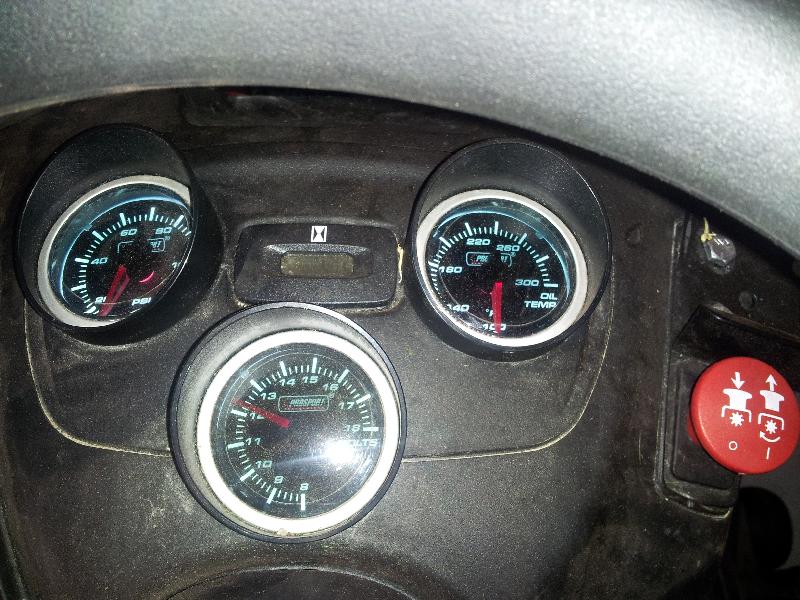

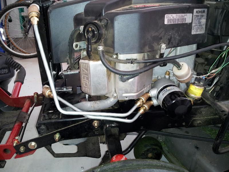

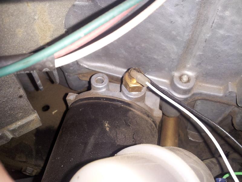

I have a 2011 GT6000, I won't bore you with history or complaints I've had but I have found solutions to some issues. There is no temp gauge, so I installed one (motor has 2 ports you can use, very easy install) and found this thing runs HOT! When pulling the sweeper or mowing uphill on a pretty good grade, I would regularly hit 300 degrees and if it was in the mid to upper 80s, I could easily exceed that. My solution was to install a sandwich- style oil filter adapter and run tubing to an oil cooler. Found most parts on ebay and I'd say the total cost was around $80. Now doing the same work even on warm days I stay 60-70 degrees cooler.
One other issue I've found is when there is any load, speed up hill drops big time. It still climbs, but pulling a cart or after snow blowing and coming back up the drive (again, it's got a pretty good grade to it) speed easily cuts in half if not slower.

I'll take some pictures in the morning and find links to the parts i used for the oil cooler. At first i thought there was a problem like i was low on oil, then i switched to full synthetic to get temps down but it wasn't enough. The sandwich adapter I found bypasses until the oil his 180 degrees, then opens to the cooler, so when snow blowing it does warm up. I've been considering throwing 2 small fans on the cooler for hot days, but so far i haven't needed them.

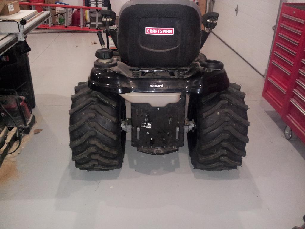

As for tires, i swapped the turfs for Carlisle all trails (HDAPs) and use them year round. No more scalping the lawn when the turfs would spin, and they do good in the snow until it gets hard packed. Then the chains come on. I went up to 26x12x12 so i went with wider rims, but if you stay stock size you should be able to stick with the original rims.

The bolt pattern is standard, before buying the tires we took them off my neighbors x749 and they went right on. I needed a little wider stance to mow an area that's steep and has to be cut side ways, so I added 1 1/2" wheel spacers. I'll add pictures of this too, they helped make a little more space so the deck height linkage didn't rub the tire lugs.

I do run the All-Trails all year, I really like them in the grass. My front yard is pretty sloped, and the turfs tend to slide too much. I did fill these with Rimguard and it really feels planted now. Before buying those I tried going with the bar-type lugs with OTR Tracmasters in 24x12x12 and while they worked OK in the snow, I still needed chains and the one time I used them in the grass they shreaded it with any wheel slip. In the areas what were softer/wet, I also found them leaving indents in the dirt. Not a big deal, but I didn't like it. The All-trails have been great year round to the point that I'm going to sell the others w/ rims (both turf and the OTRs).

Here are some pics of the rear end with the spacers and OTR Tracmasters, the oil temp sensor, the gauges, and the oil cooler. I can take more, found these on my laptop.

That looks like a great setup there. The oil filter tap off with the integrated temp sensor looks ideal and OEM like.
Those OTR Tracmasters look near ideal for snow but you still consider the All-Trails as good for grip in snow? I can see the Tracmasters being too aggressive for lawn and many with the SCUT and CUT will also confirm these style tires offer good grip but they will rip up the lawn when the tractor is used as an earth works application.

I did use the OTRs all last winter and while they do self clean very well, I found once it gets hard packed or there is any glaze on the pavement they just spin. I went as far as loading them with rimguard, 55 lb wheel weights, and strapped 180 lbs to the rear and they still spun (not to mention the rear end just cried and crawled coming back up the driveway). Took the weights off the wheels and off the rear, then added chains.
