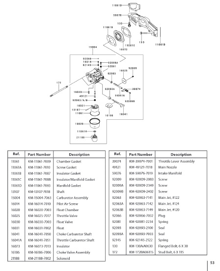

BUT, it does run for a sustained period of time now AS LONG AS I start out with a full tank of fuel. Once the fuel gets down to 1/3rd - 1/4th full, it stalls out as before. So, I guess a cheap repair would be just to keep the fuel leve up. However, I really would like to get to the root cause and fix this thing. Any ideas? Thanks.

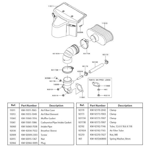

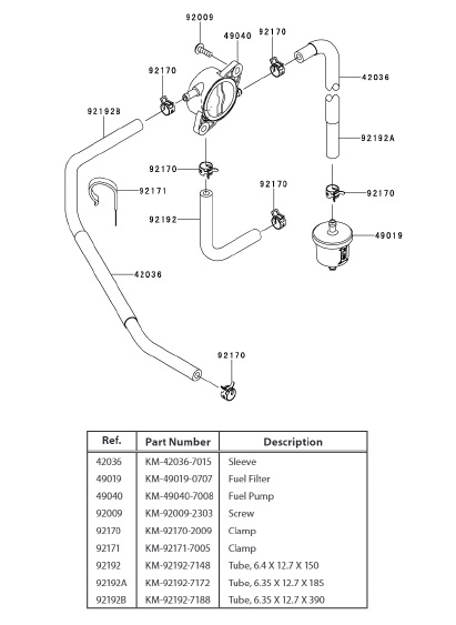

Thanks for the insights. I thought a couple of pictures might help.
I have replaced part 49040 (fuel pump) and tubes 92912, 92192A and 92912B.
I also swapped out part 21188 (solenoid).
Part 11013 (air filter) was changed and is clean. Question on the diagram with this part: Check out part 92066 (plug). What is its function? I can't recall the effect right now, but it seems to me that I ran the tractor with the plug both on and off.
I'm not seeing anything labelled vacuum line. Can you tell which part it is on these diagrams?
Thanks again.

Tube 92912 that attaches to the bottom of the pump is what some people call the vacuum line,it's actually a pulse line. As the engine crankshaft rotates and the pistons move up and down, there are pressure and vacuum conditions inside the crankcase. The pump uses these pulsations to pump the fuel. When there is pressure in the line, the pump forces fuel out, when there is a vacuum in the line,it sucks fuel from the tank.
I would check the fitting in the engine that the pulse line goes to, to make sure that it is not plugged.
