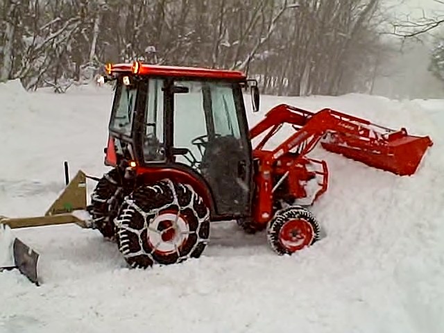

On my B3030 I tried to use the same type of chain and quickly found out that they would hit the inside fender of the tractor. I added the Kubota wheel spacers and the problem was solved, not to mention the improved stability. I got mine through the dealer.

I have one thing to say about chains: In the land of snow and ice, the man with chains is king.
