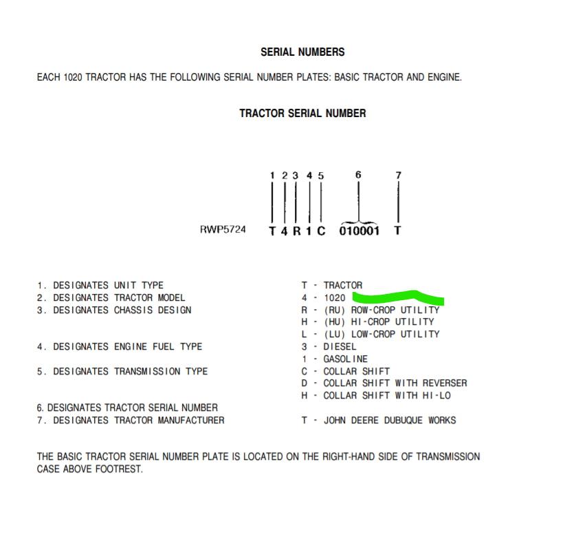

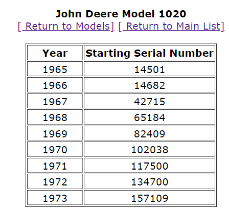

My vote is failed differential pinion shaft(item 13) &/or gears in lieu of failed rear axle. Are you positive about model #??? JD 2010 didn't have option of differential lock.
on the model. not 100%. i'm a oliver guy. This is the serial on the motor 41TR035663T and this is the one on the rear end housing 4R1C028077T. It could be a 1020 i suspect since it's a 3 cyl. The guy i bought it from doesn't know anything about tractors really. He just used it to brush hog and rototill a garden spot on his 5 acres. He had it for about 10 yrs. I got it because he couldn't keep it running. He had the carb rebuilt twice, but it would run till it got warm, then stop. I bought a new aftermarket carb and started right up and ran great till this.

3 cylinder engine narrows the model choices a lot. According to serial # it's definitely a 1966 model 1020

Thanks. Appreciate that a lot! Sorry everyone for my ignorance and thanks for everyone else's post.
