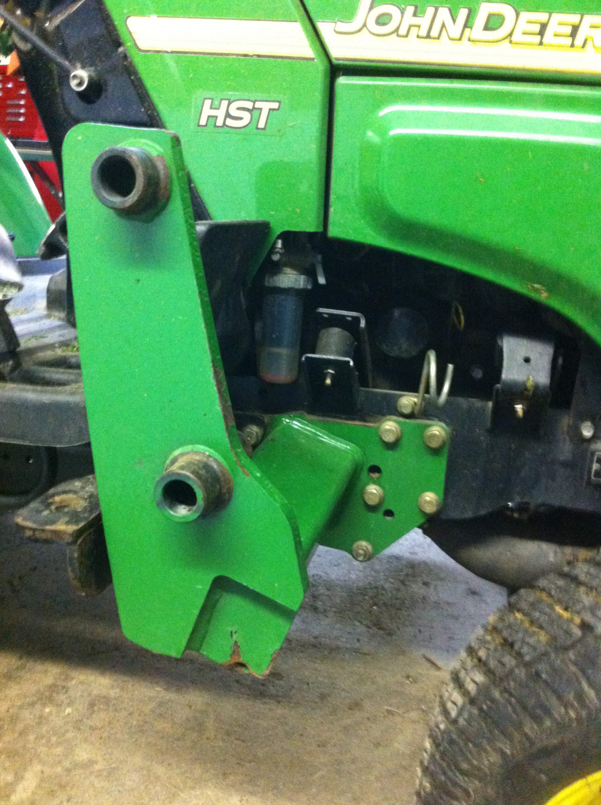

I want to be able to design a mount for my Kubota using the 2305 mounts I have and need the dimensions to ensure they are in the same spot as on a John Deere
Width of vertical arms
Top of uppermost round mounting feature.
Bottom of horizontal tube
And distance from front of tractor.
Thank you,
Rob
   / 200cx mount geometry #7

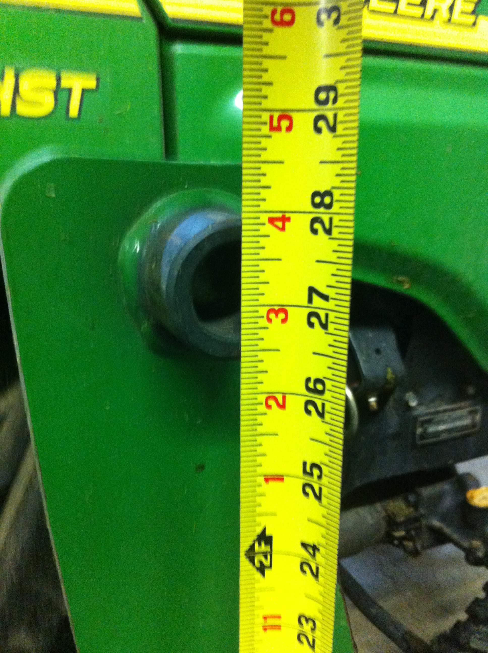

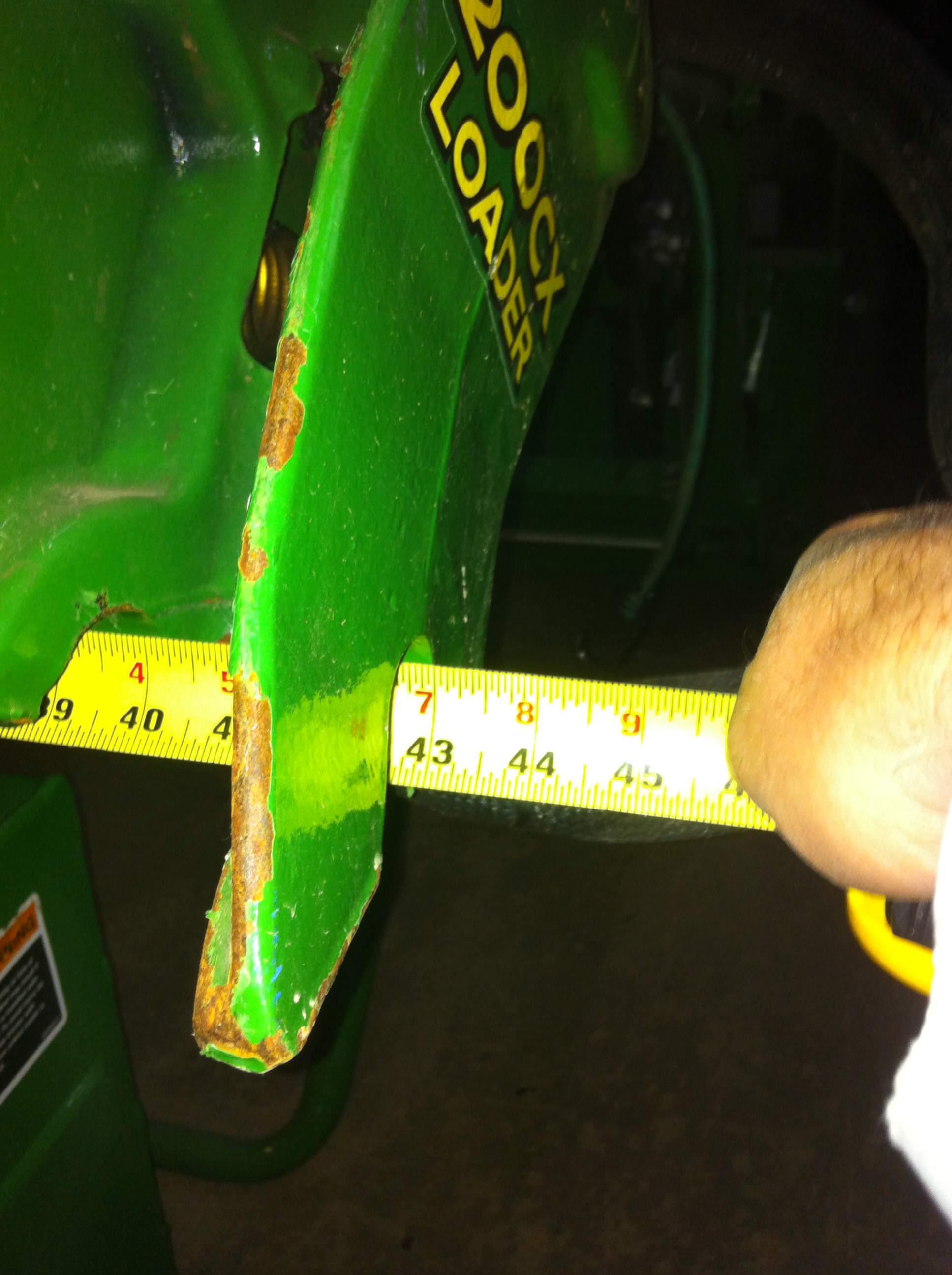

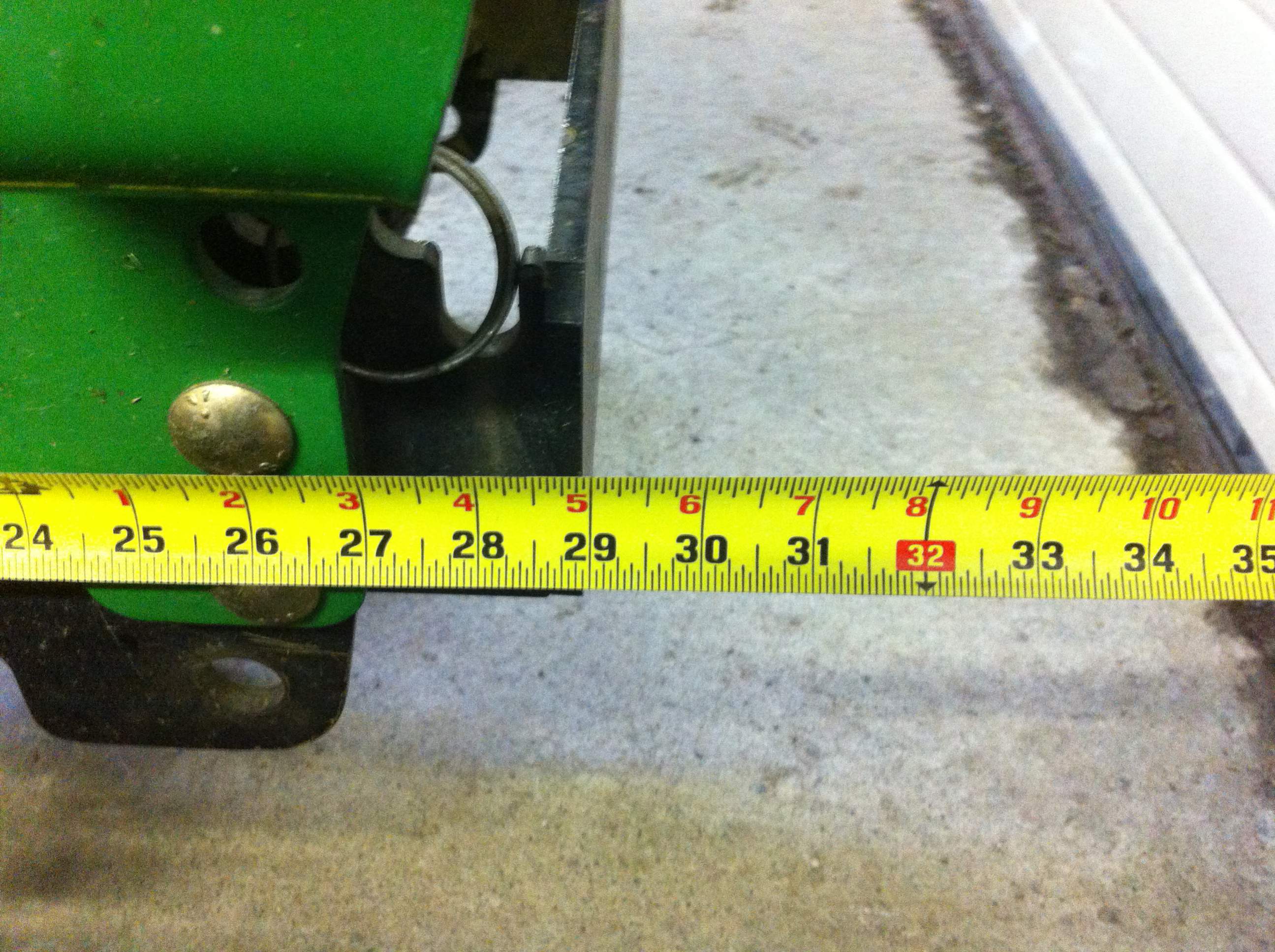

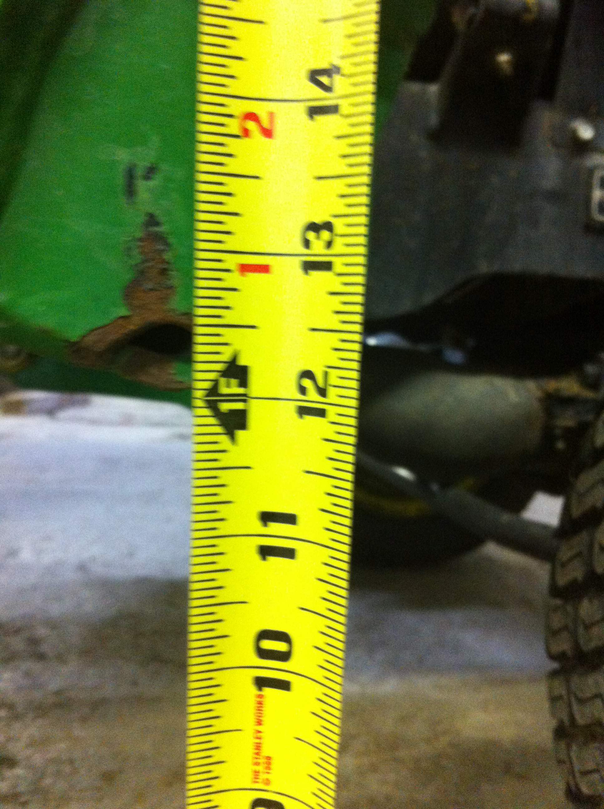

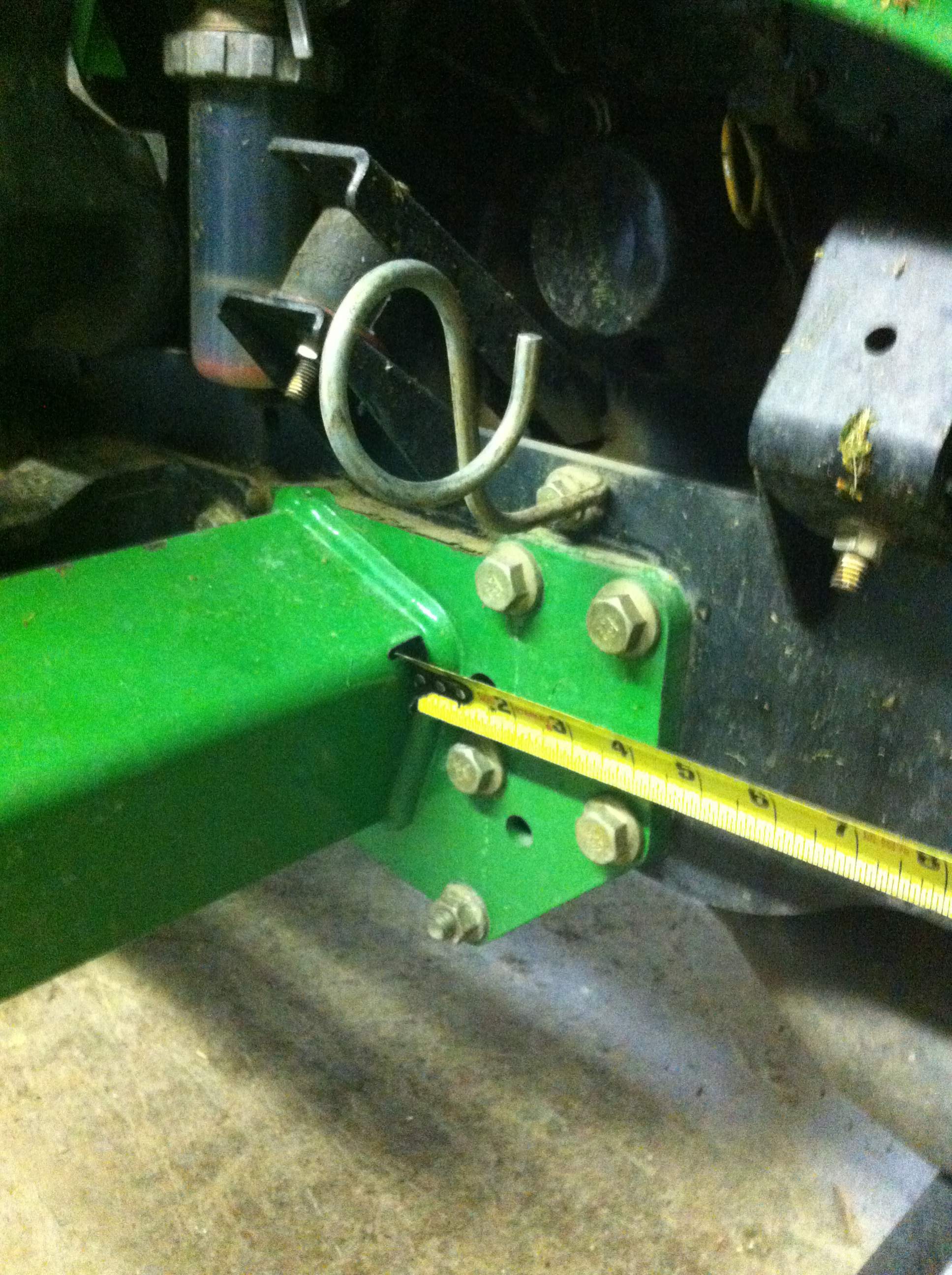

Overall width is the same as the width of the loader arms 43''. Iphone pics 083.jpg Top of uppermost round mounting is 28'' to the ground. Iphone pics 087.jpg Bottom of horizontal tube to the ground 12''. Iphone pics 089.jpg Distance from front of vertical arm to the front of the bumper 29''. Iphone pics 091.jpg Iphone pics 096.jpg Hope this will help. Henri
