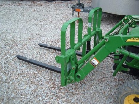

Does the bucket on the 200cx detach from the frame, to allow other implements to be used in its' place, ie;pallet forks?
/ 200cx loader #2
Yes, picture of pallet forks on 200CX loader attached.

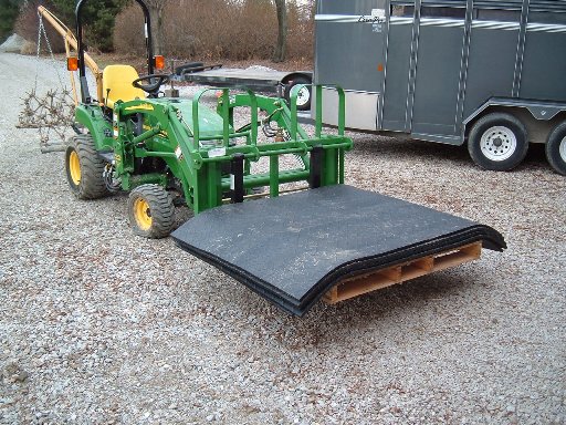

I don't know how much it will lift, but I think the pallet forks are about 250 lbs. compared to the J.D. ones which I think are more like 400.

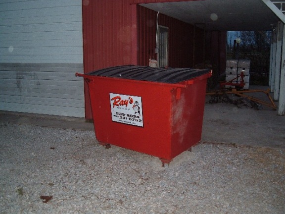

If you use a lot of ballast, my 2305 will lift quite a bit. I move my dumpster around when it is empty or has lightweight stuff like hay in it. Pallets with 10 bales of hay, stacks of rubber horse mats, landscaping material...they're pretty handy.
I will TRY to attach a couple of pictures.

This is the dumpster I move around.

Well, this is just an opinion, but I would be much more carefull if I were trying to lift near the maximum weight with the forks up very high in the air. If you lift too much close to the ground the tractor will "tell" you and if you keep your hand on the control, you can react quickly.
I probably wouldn't try to lift more then 400 or 500 lbs. off of a truck even with a lot of ballast.
