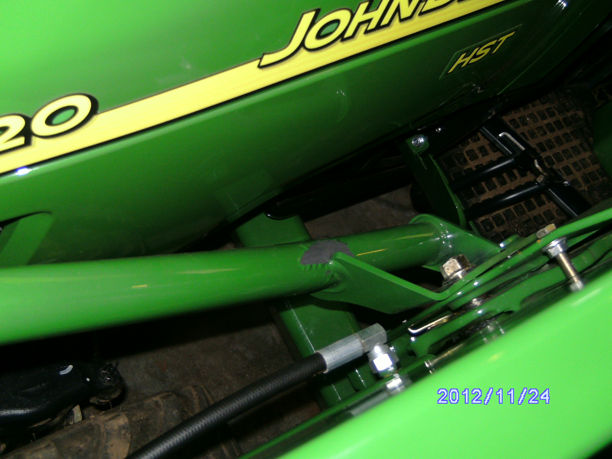

Your last picture that shows the paint missing is where I have seen these stands bend my old 200 cx included. The trick has been mentioned and that is to let the loader push the tractor so the stand doesn't slide. Not sure what the feet that were pictured would actually do.
Well Tuesday the dealer sent their representative down to look at my tractor and bent parking stand. After an hour of looking at it and taking FEL off and on he concluded that the stand did not hit anything and it bent at the welds due to bad manufacturing process. He even noted the bad looking welds and incomplete weld on the stand.
The dealer rep said he would go back and discuss his findings with the service manager.
