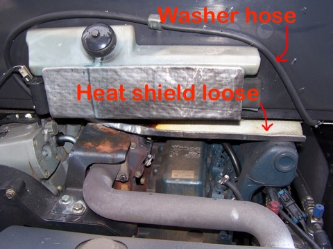

Well actually, if this is your engine bay, that turbo is going to be fun to get at from the intake side. Quick question on your oil type, I've never heard of running 5w-30 oil in a diesel, although it appears Kubota may have been pretty wide in their specifications for oil whether the oil is rated for diesel or not. Light oil can cause premature turbo seal failure from what I've read.

I've pulled the passenger's seat/engine cover to gain access to the turbo inlet and outlet pipes. I'll check for play on the turbo shaft both radially and axially. And I'll also check the manual tonight to figure out where the crankcase vent is so I can check that as well.

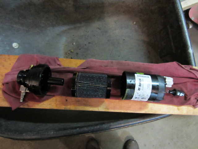

Me thinks I would tear that fuel filter apart to see what's in it. Maybe even suck fuel out of the tank to get a look/see for fungus or ?? Sure glad it is running for ya! :thumbsup:

I cut open the fuel filter and found nothing unusual. Hmmm.

/ 2009 5600D engine problem #18
I had to change my filter too mid winter....
