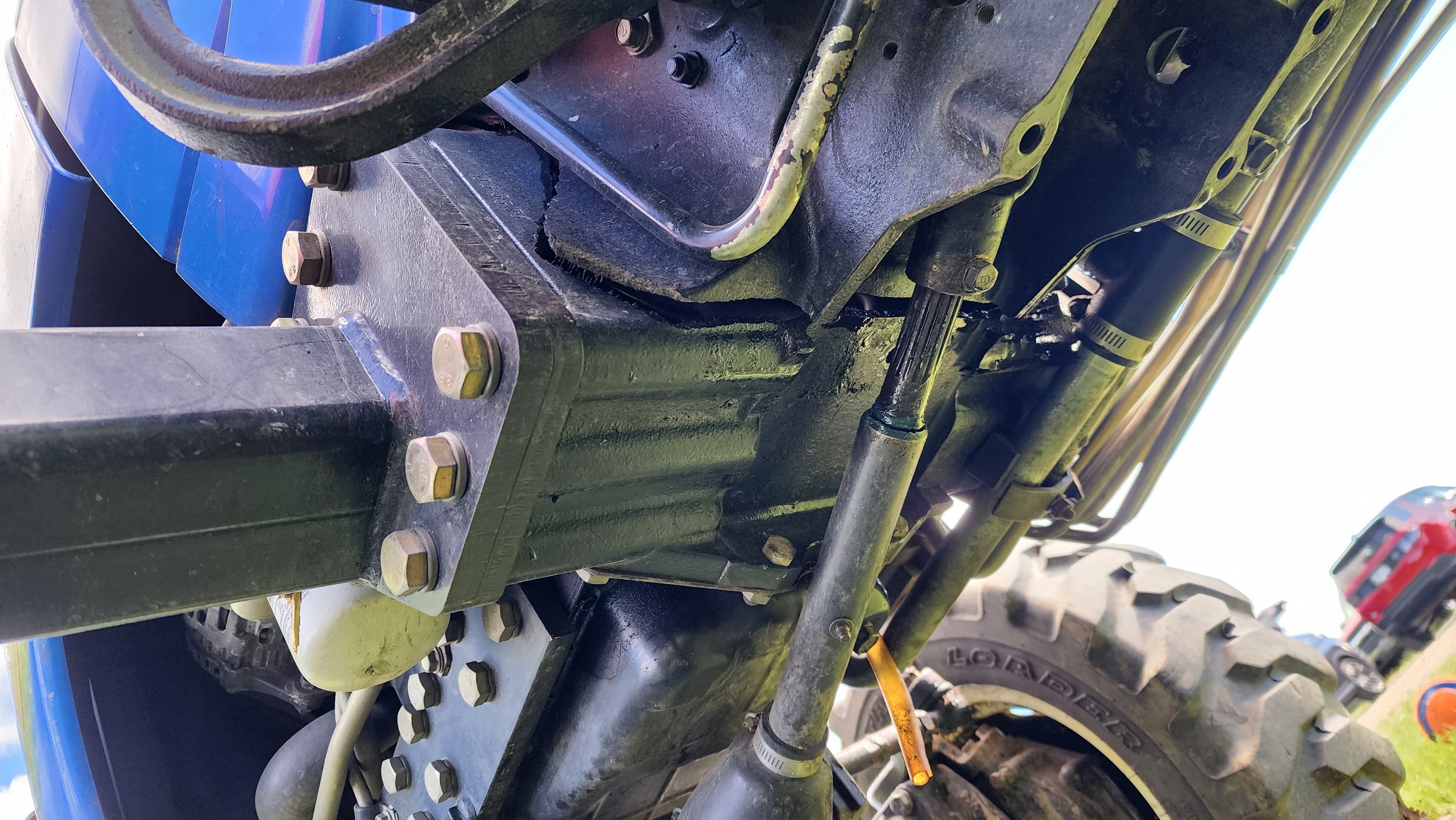

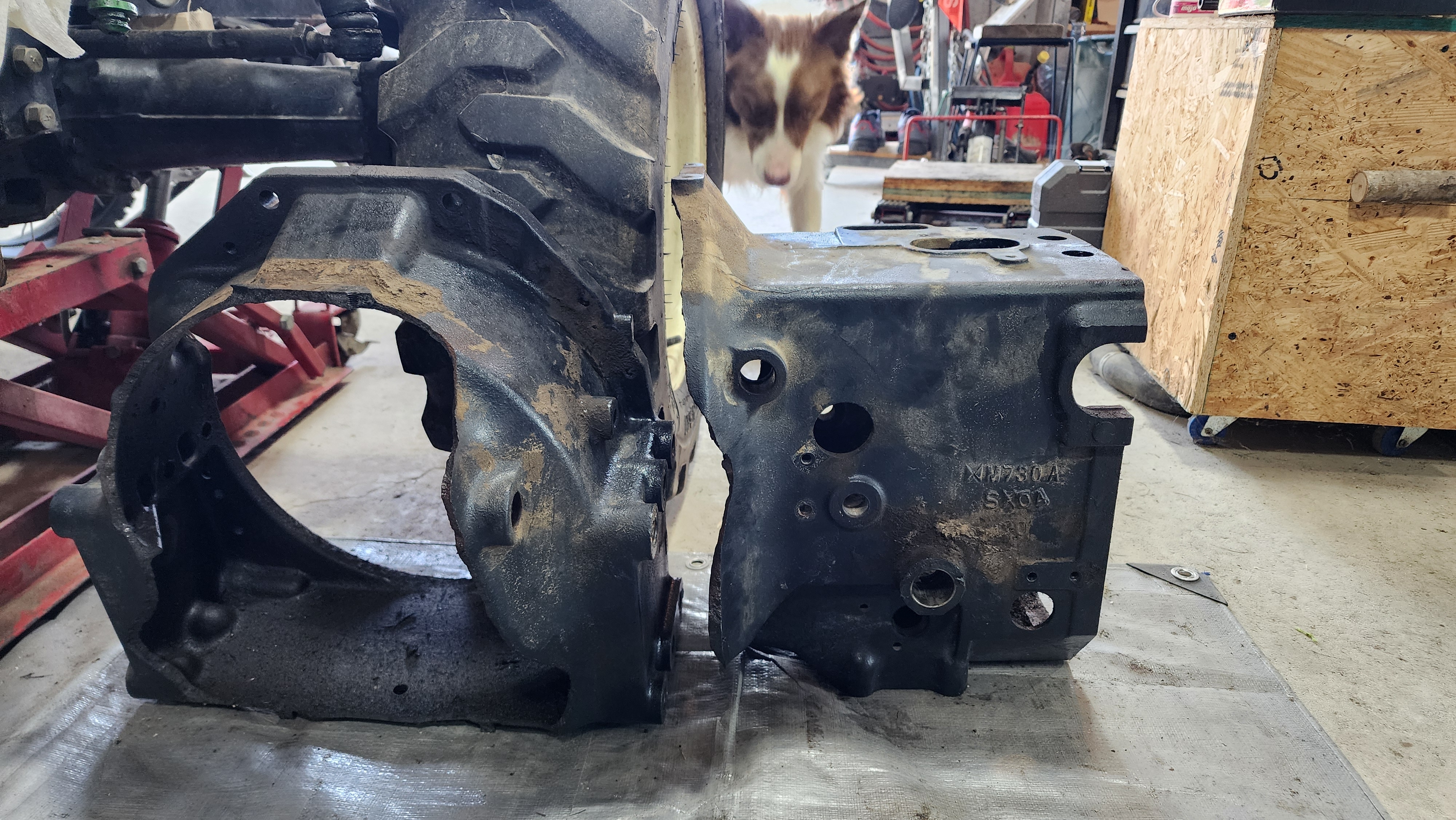

#12
OUCH!
Looks like you've got a winter project to keep you and your son busy.
Sigh..... I need it now for wood. :D
I'd have had it together today if I had the correct housing. :(

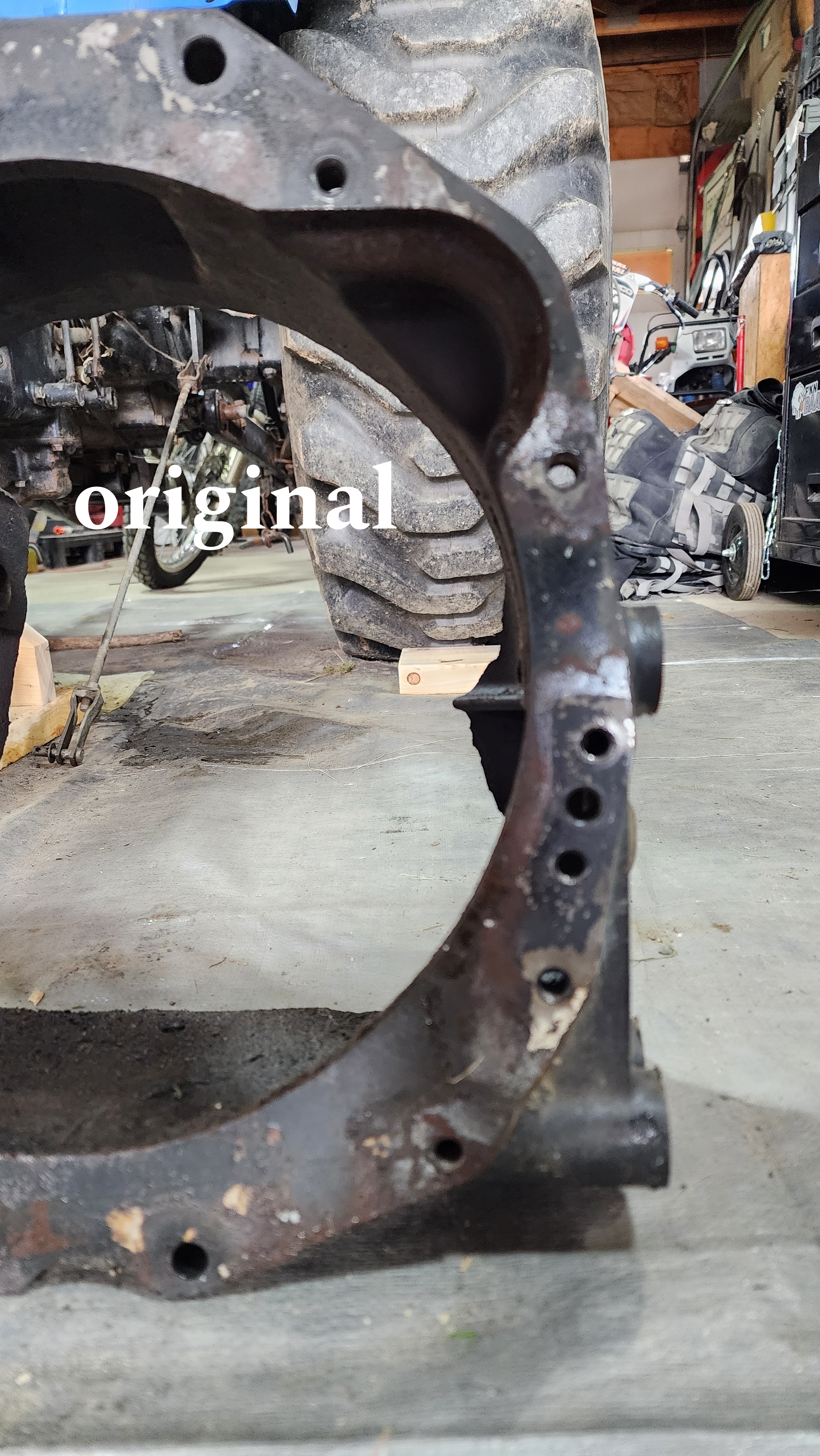

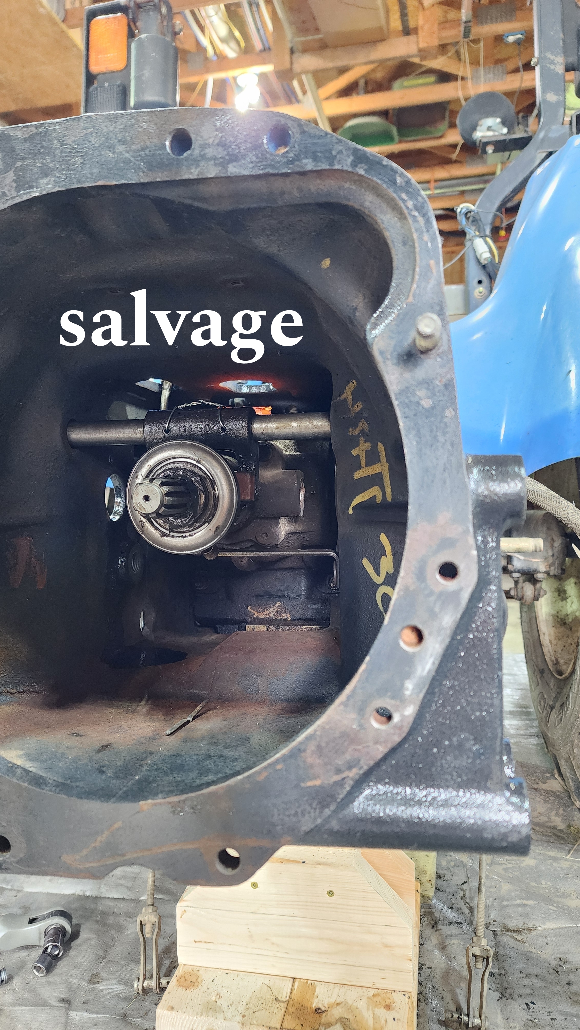

   / 2008 T2220 broke in half #14
Looks like you have the tools and space for the task. It's just parts, the right parts help. Not so long ago I went through similar with a broken front axle.
The difference between the original and the replacement meant I had to machine a new steering cylinder. Fortunately, I'm equipped for something like that. (Lathe, mill etc.)
When I put the snow blade on the antique Fordson, I ran the push bars all the way back to the rear axle. Including relay plates at the mid mounting pads. Breaking the casting is not big on my list of things I want to mess with. Though I have split that tractor twice in the 45 years I've had her. It's a wet clutch on the Fordson, so the throw out bearing should outlast everything else ;-)

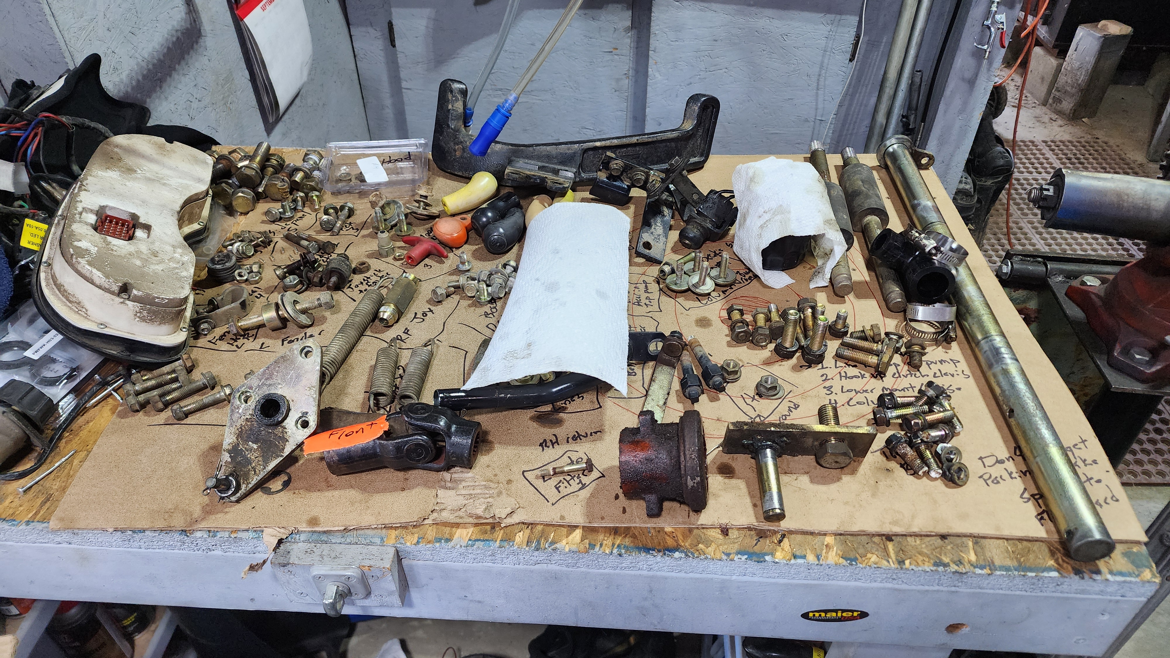

Well..... three months in.......
I found a local guy to weld the housing. He did an absolutely beautiful job.
It took me nearly 18 hours to put it back together. Zero spare parts, I left one fitting on the block loose. Not bad for no manual. :)
Now to figure out how to bleed the hst side of things. Everything else works, but it won't move.

I had do that to our Farmall Super M. My Bil had a large round bale on the aftermarket FEL. He was driving too fast, got to bouncing and the bell housing broke.
He was lucky he wasn't hurt much, as it was the steering wheel hit him in the chest and knocked the wind out of him.
