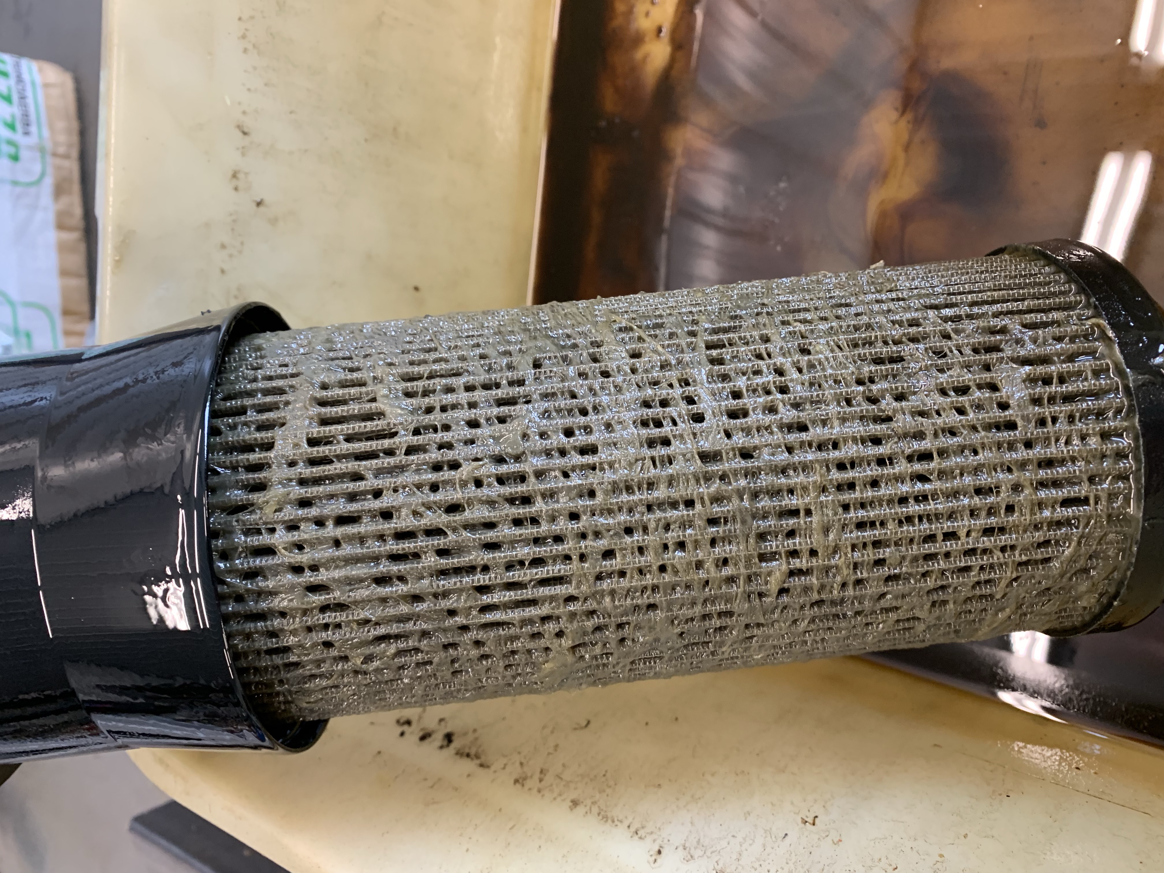

Here is the Hydraulic filter.
/ 2008 3320 problems #9
That looks like algae. You You will need to add a algaecide for hydraulic oil. I would recommend also treating the fuel system also.
/ 2008 3320 problems #10
You don't think you got one that has been in a flood do you? Hydro fluid shouldn't look like that at all with that few of hours.

You are correct, algae does need sunlight to grow... unfortunately many in the tractor/diesel community refer to a diesel biological growth as "algae". It's inaccurate, but there you go. :rolleyes:
A biological growth in the diesel tank (plus fuel system/fuel bowl) feeds on a layer of water, which is on the bottom of the fuel tank as water is heavier. If you were to put an inspection camera down into the fuel tank (which I recommend that you do), a biological growth will look like fairy-floss (cotton candy) mixed with phlegm. You will need to dose the tank with a diesel biocide, which is readily available at any auto-parts shop/store.
Then you'll need to drain the entire tank and wipe out the dead biological growth using a 'grabber' (auto shop again) and many CHUX (J-Cloths). The dead biological growth will be stringy and brown.
I'd also wipe out the entire fuel bowl assembly. Only then would I add fresh diesel to the tank (+ this "seafoam" additive) and fire up the engine.
I have no idea what has contaminated your hydraulic filter.
