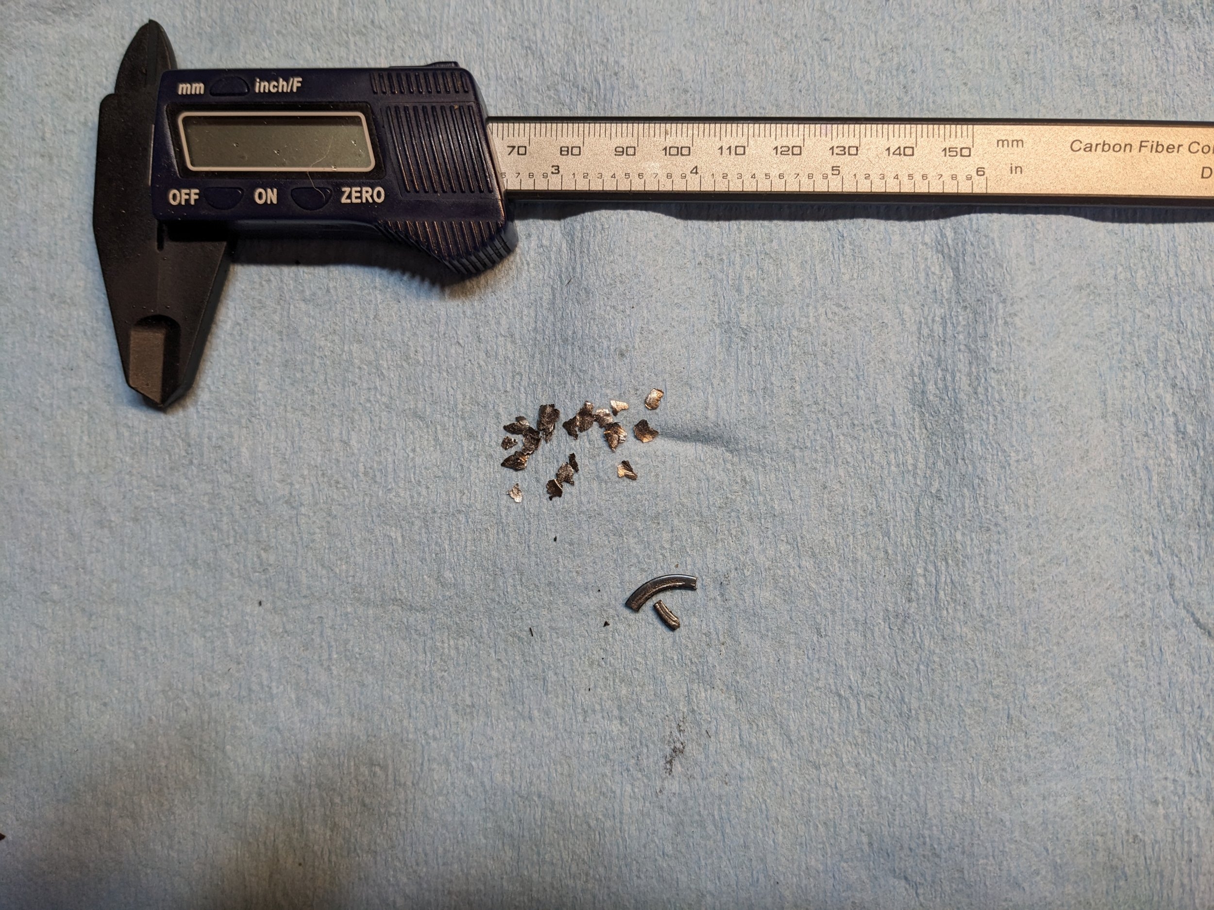

2007 Kioti CK20 hst 1500 hrs. Noticed a marked decrease in FEL and 3-pt hydraulic power; I changed the hydraulic fluid and filters (fluid and filters have changed according to mfg schedule) and found the longer pieces of metal (see pic) attached to the magnetic drain plug. The shrapnel was found in the Flow Priority Valve. The tested the pressure (after the shrapnel was removed) on the FEL is 1000psi. Any ideas of what is going on in the hydraulic system?
