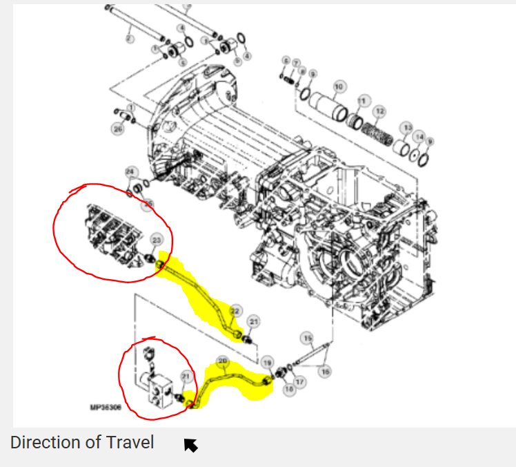

I have completely reassembled. The components for items 1-4 above appear very simple with no damage.
Current symptoms are as follows: no forward/reverse, and also no PTO. The PTO may have been not working originally - I did not test it before the first tear-down. This may be a clue.
Forward test port results per spec.
Reverse test port results per spec.
Lubrication test port reads about 35 psi with the clutch in and 0 with it out while the machine is in neutral. When the clutch is pushed in it jumps to 35 right away, but when let out is slowly drifts to zero. With the clutch out and the machine placed in forward or reverse, the pressure goes quickly up to 35 psi, then drifts back down to 5.
Does this data provide some helpful direction?
There is tube from the Reverser valve to the PTO solenoid valve. From the PTO solenoid valve a tube goes to the PTO clutch. Maybe connector(s)/wiring/switch/solenoid problem for no PTO?. Or no hydraulic pressure?, but since you have pressure for F/R clutches, I doubt pressure is the problem. More likely solenoid or switch/wiring/connector(s). I assume there is a PTO pressure test port, maybe in the PTO valve? Final thing could be failed PTO clutch pack

I hope the PTO is a clue. Oil to the PTO clutch passes through the reverser valve. Because of this, I do not suspect that the issue is with the drive clutch or something mechanical beyond it. Also, there is the low pressure reading at the lubrication test port.
Does tech manual tell what lube pressure should be? If low, maybe lube relief valve stuck or weak spring?
