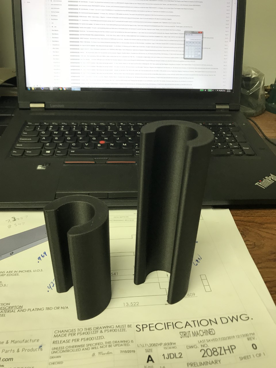

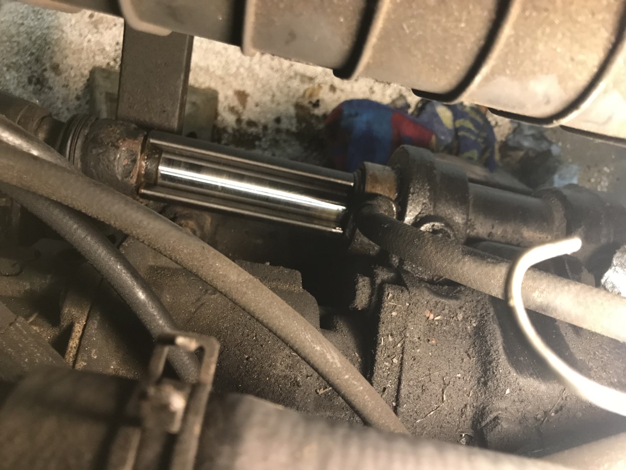

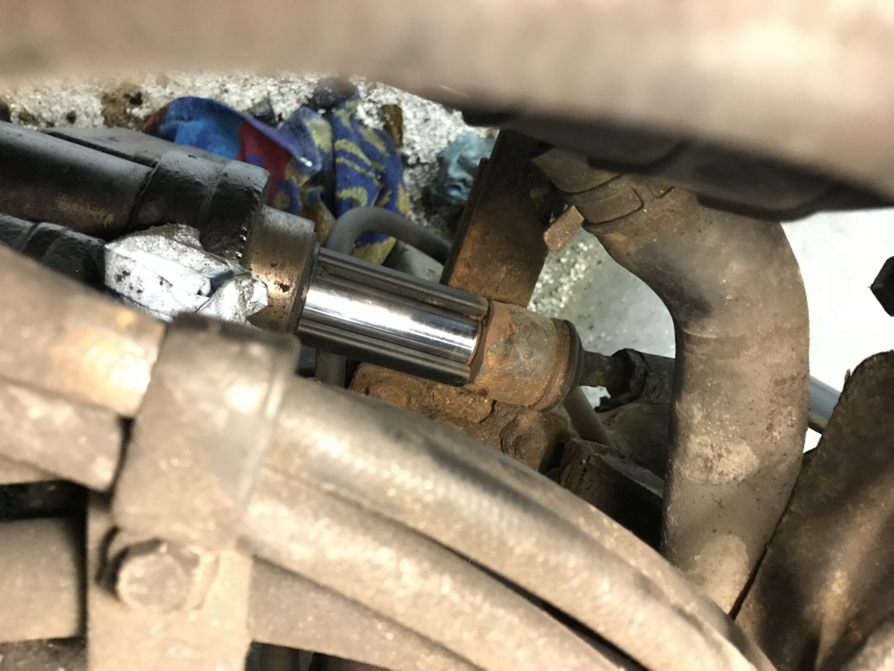

I cheaped out. I didn't want to waste time pulling and splitting the axle, so I compromised. I 3D printed two half moon shaped snap on sleeves using the length of the centered steering ram from the manual (90mm driver's side and 150mm passenger side). The printers at work use a material that consists of nylon impregnated with pulverized carbon fiber, and is extremely strong. These sleeves clip onto the exposed ram shafts on either side of the ram hosing, locking the rear steering ram in place. Then I looped the hydraulic lines with a junction, and used AN fittings to plug the axle ports
So now I have no 4 wheel steering, but it only took an hour and $30 to fix. I can live with that for now, and when the time is right, it is completely reversible when I have more time to complete the repair in full
   / 2006 Toolcat C Rear Steering Hydraulic Leak and Wandering Out of Alignment
here are a few crappy pictures
