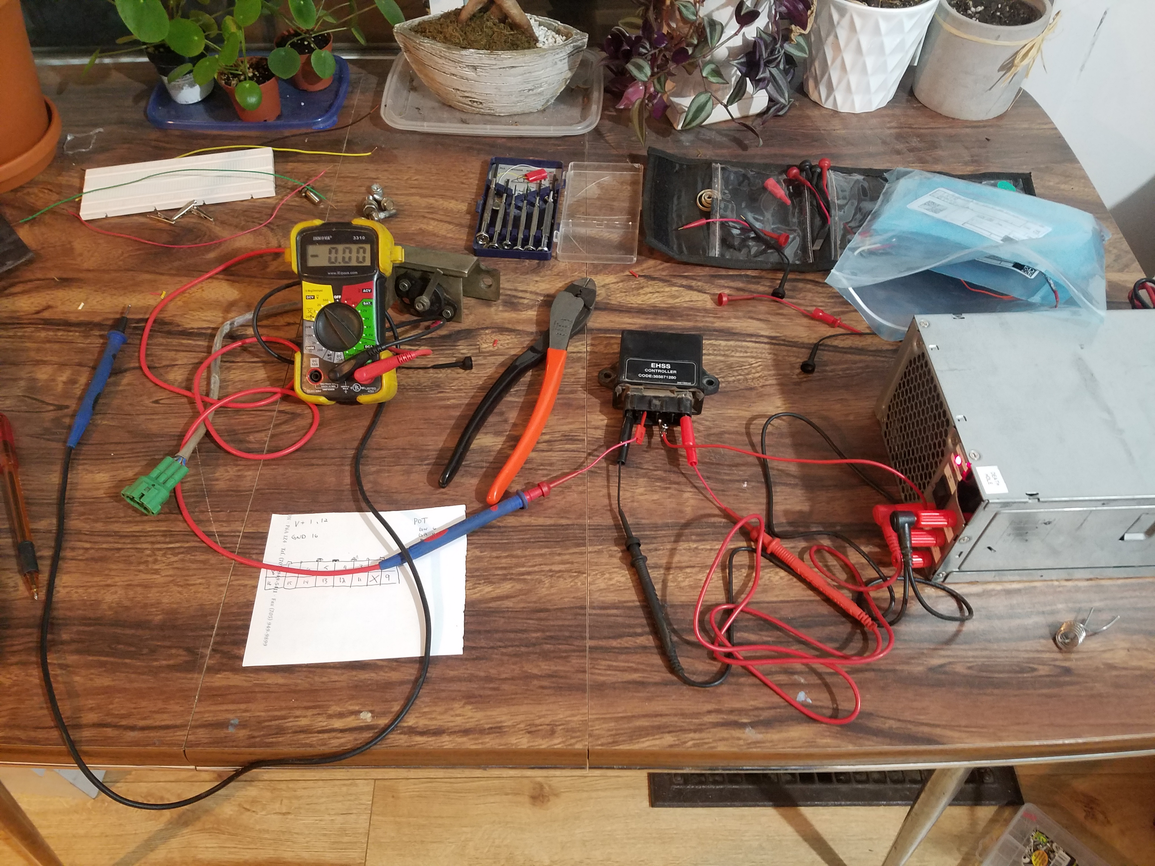

The saga continues.
Today I tried to hook up my snowblower but I never got it unburied before the clutch failed to engage. Of course it's in a really inconvenient location and it's raining today. The switch I replaced was not behaving as it should so I'm glad to have replaced it but there is obviously some other problem here.
One new observation is that the clutch seems to engage just fine for a short period of time after the tractor has been sitting for several days.
The next thing to check is the output voltage of the potentiometer. It's resistance seems okay but I have to check voltage in situ which requires I expose a test point. I'll seal it up with a blob of silicone when I'm done.
I'm also considering testing the EHSS control module on using my bench power supply but I'll need to find suitable connectors somewhere.
If anyone has a breakout box (380001351) for this, I'd be interested in buying it. PM me.
