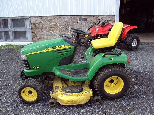

On my tractor the foot operated differental button is in a down position with the tractor sitting and in photos of new tractors the button is up. Is that a sign that would indacte a problem? I have never checked the positraction function but plan on doing so this Saturday, Below is the photo showing the depressed button

Probably the parking brake is set. The parking brake also engages the differential lock. That "button" should pop-up when you release the parking brake.
Also, once the differential lock is engaged it will NOT release if the differential is in a bind - so if the lock was engaged and the tractor was moved with the front wheels turned it might not didengage unless you streighten the wheels and move the tractor a little to release the bind.
