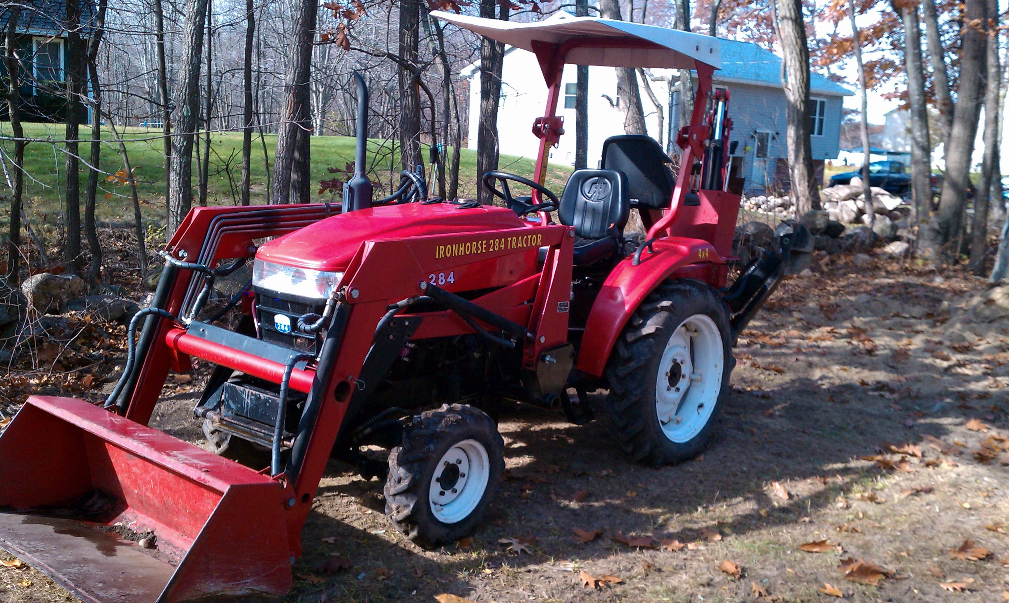

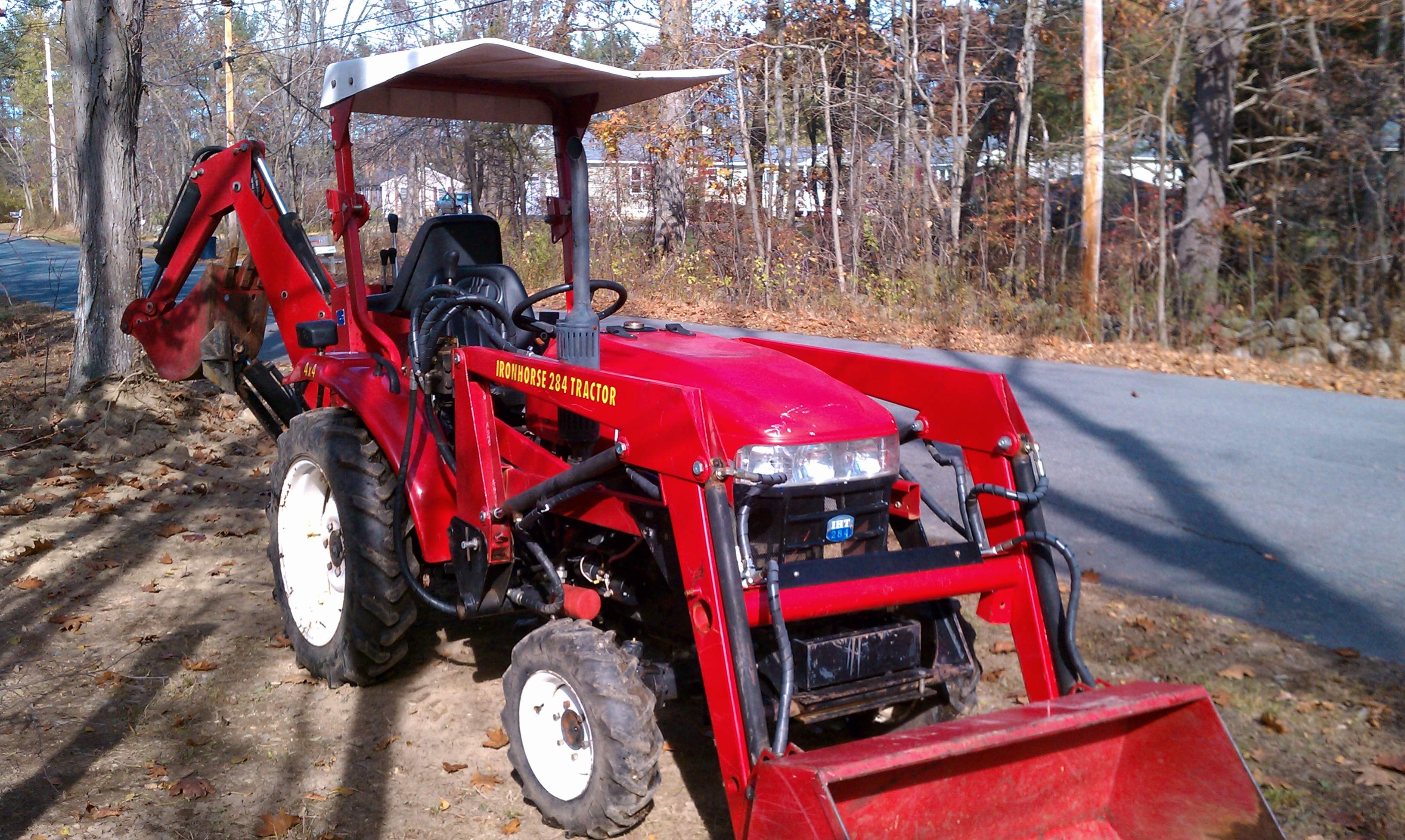

So this would be my second tractor (used to have a Kubota BX) -- found a guy locally selling a 2006 Jinma tractor loader backhoe with 28HP Diesel with under 200 hours -- this brand is new to me -- good deal or no? He sent me a few quick photos

How could I possibly tell you if its a good deal if I don't know the price? Not enough input, in other words.
For $20K it wold be a rip-off. For $100 I'd pounce on it regardless of condition. Somewhere in between those two extremes is probably a fair deal. It's all about condition - I've seen tractors that were nearly new but were trashed and I've seen antiques that were absolutely pristine.
If in good condition with everything working right, that is a good little tractor. Better if the backhoe is a Tomcat or Litw, better if the loader is a Koyker, etc. Lots of variables in the equation.

Under 7K was a good deal. If the loader was a Koyker, Spirit, or Great Bend and the BH was not a Jinma it would be a great deal.
Too bad you missed it.

Yeah, $7K was a good deal, but definitely not a great deal. The tractor and loader were about that, or a bit more, new in '06. The hoe, which looks like a Jinma, sold for another $3500 or so, which is more than it's worth based on reports from owner. So the deal was okay but not terrific and you'll find another in the same range again, I'm sure. That one didn't look like it was always kept garaged, judging from the rust I saw in the photos.

And the loader and backhoe appear to be Jinma based on the manufacturer's tags on them...

First off its not a Jap tractor, your Kubota was, this is a Chinese tractor.
The things I would check is all the fluids for one. It has engine oil, front axle oil, gear box oil, and hydraulic oil. There is also a seperate reservoir for the injector pump.
I would change them all along with the filters.
Does the BH run off its own rear mounted pump or is it plumbed off the tractors system? If it has its own I would change it also.

The Jinma loader and BH leave a lot to be desired. The loader is a easy fix using a upgraded valve assembly from Ranch Hand Supply. Check them out on the Web. The BH you will just have to live with until someone comes up with a fix for them.

Yep, not as refined as Kubota, but it will do some pretty serious work(heavy tractor, lots of traction). The chinese joysticks leave a little bit to be desired and are a little sloppy. There are a few fairly easy mods that can be done to refine them a little bit. I have made some mods to my Backhoe joysticks and they work pretty good now. Probably the biggest failing of the chinese valves, particularly on the BH is the lack of load checks on each circuit. This can make operating it a little unusual untill you learn what combinations not to use...

Diamond Pilot is correct, the Chinese loaders valves leave alot to be desired but they are useable,better with the upgraded loader valve.The Backhoes always seem to be a problem,but at $ 7,000.00 for the package deal thats a good price.
New Current 254 Jinma Tractors Are in the $ 7,000.00 range without a loader or backhoe
