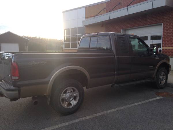

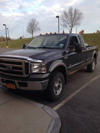

Found a local 2006 F250 Lariat Supercab 4x4 truck for sale. Haven't looked at truck yet but considering.
Truck has 112k miles, 6.0 PS turbo diesel, 6 spd manual, leather heated seats, 3.73 ratio, new tires for $11k
GCWR is 23,000, Conventional trlr. rating 12,500
What problems should I look for. I've read a few stories on the problems with a 6.0 PSTD.
