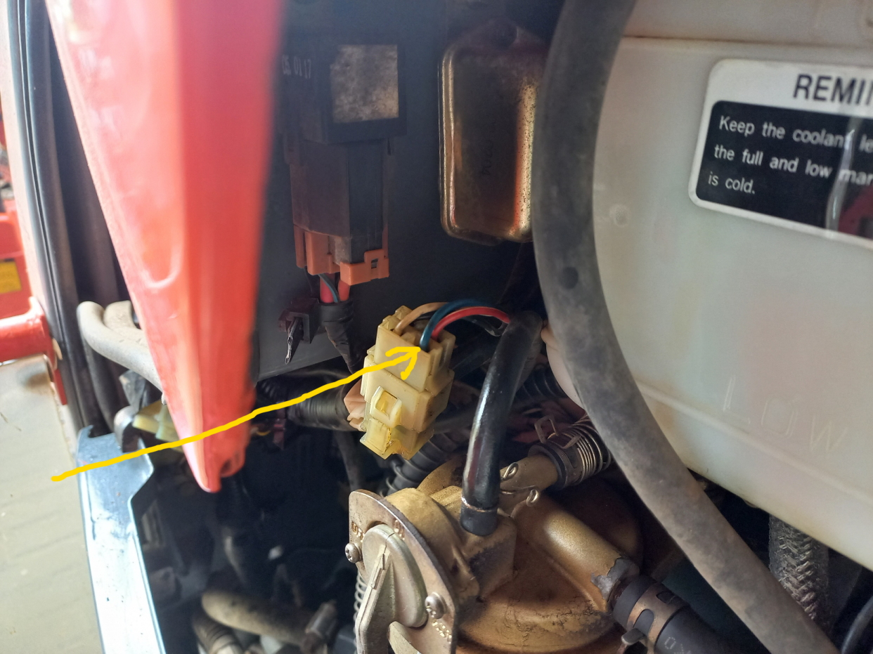

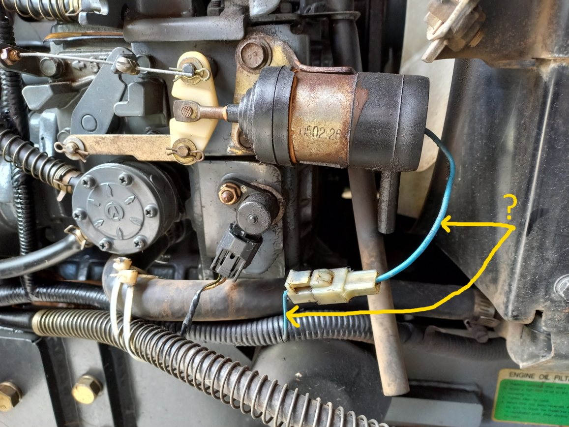

Hi folks,
My engine won't shut down with the IGN switch but stops OK with the stop knob.
The solenoid checks out fine. Operates with 12V but the blue wire shown has no power to activate it. Does anyone have a wiring diagram that shows where the blue wire goes so I can track it down.

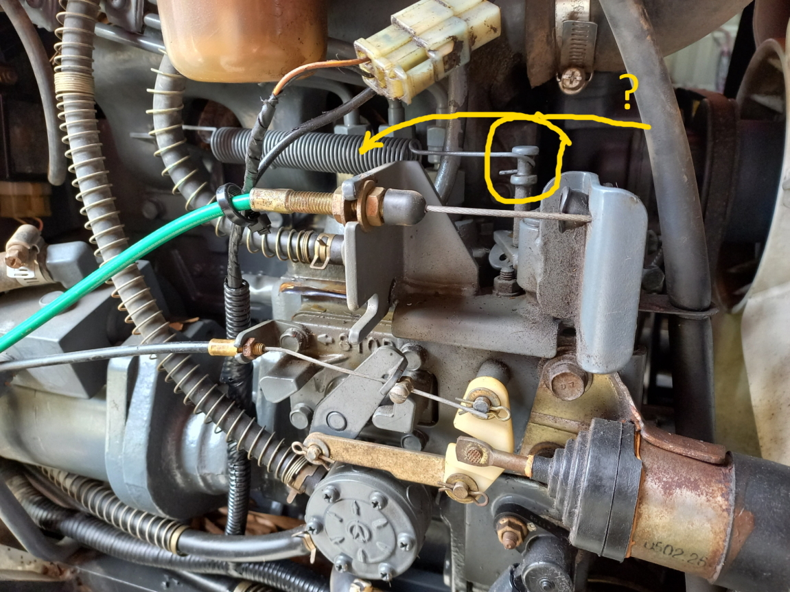

The other thing, is the spring in the other photo was just hanging down and I'm not 100% sure where it should be attached. Is the circled area where it should be?
Thanks.

Follow up,
Tracked the blue wire back to a dirty connector. All fixed.
