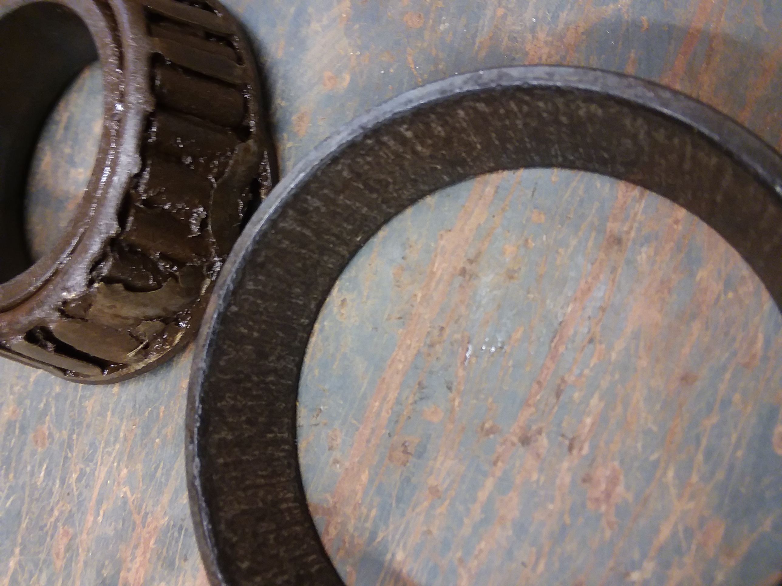

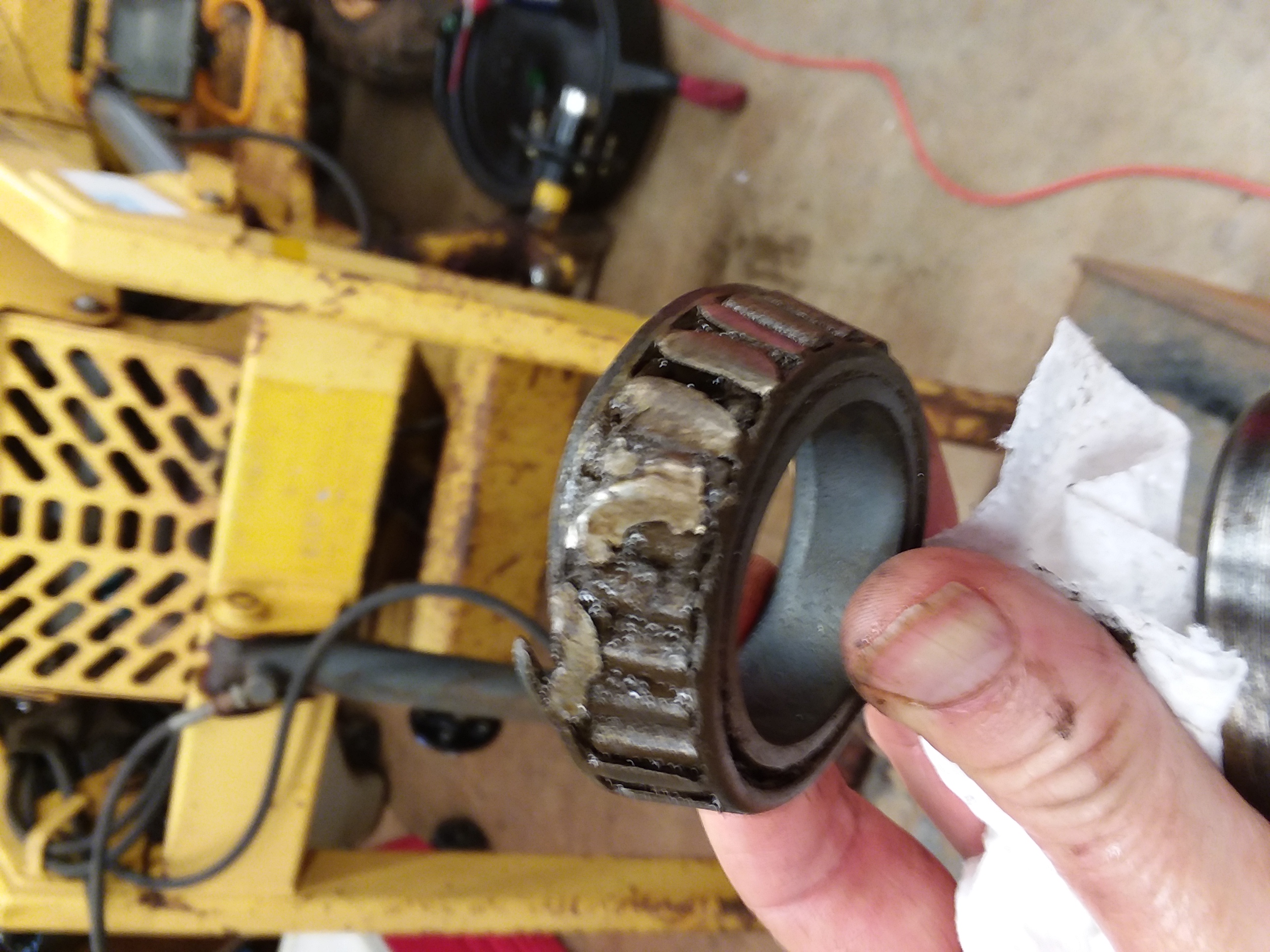

/ 2005 T5C Wheel Bearings
Thank you to DoubleO and Oldstuf for their information.
Oldstuf's post can be found here: www.tractorbynet.com/forums/terramite/380486-1998-t5c-frt-wheel-bearing.html
I completed the bearing job in about 6 hours or so.
I can confirm that on my machine (2005) the bearings are:
Outer Bearing L44649 Outer Race L44610
Inner Bearing L68149 Inner Race L68111
Inner Grease Seal 442251
Dust Cap Carry-On Part #120
I went to Autozone and bought the following Duralast Part #'s:
Part # SET4 Includes bearing L44649 and Race L44610 $6.49 ea
Part # SET17 Includes bearing L68149 and Race L68111 $6.99 ea
Part # 442251 Grease Seal $4.99 ea
Part # 120 Dust Cap $9.99 Pair
$50 out the door for the entire job, already had the bearing grease on hand.
The passenger side inner wheel bearing/race are pictured below:
It was obvious that the drivers side had been replaced before and they were in good shape, however went ahead and replaced anyways.
Thanks for the help and I hope that including the Autozone part #'s proves useful to someone in the future.
