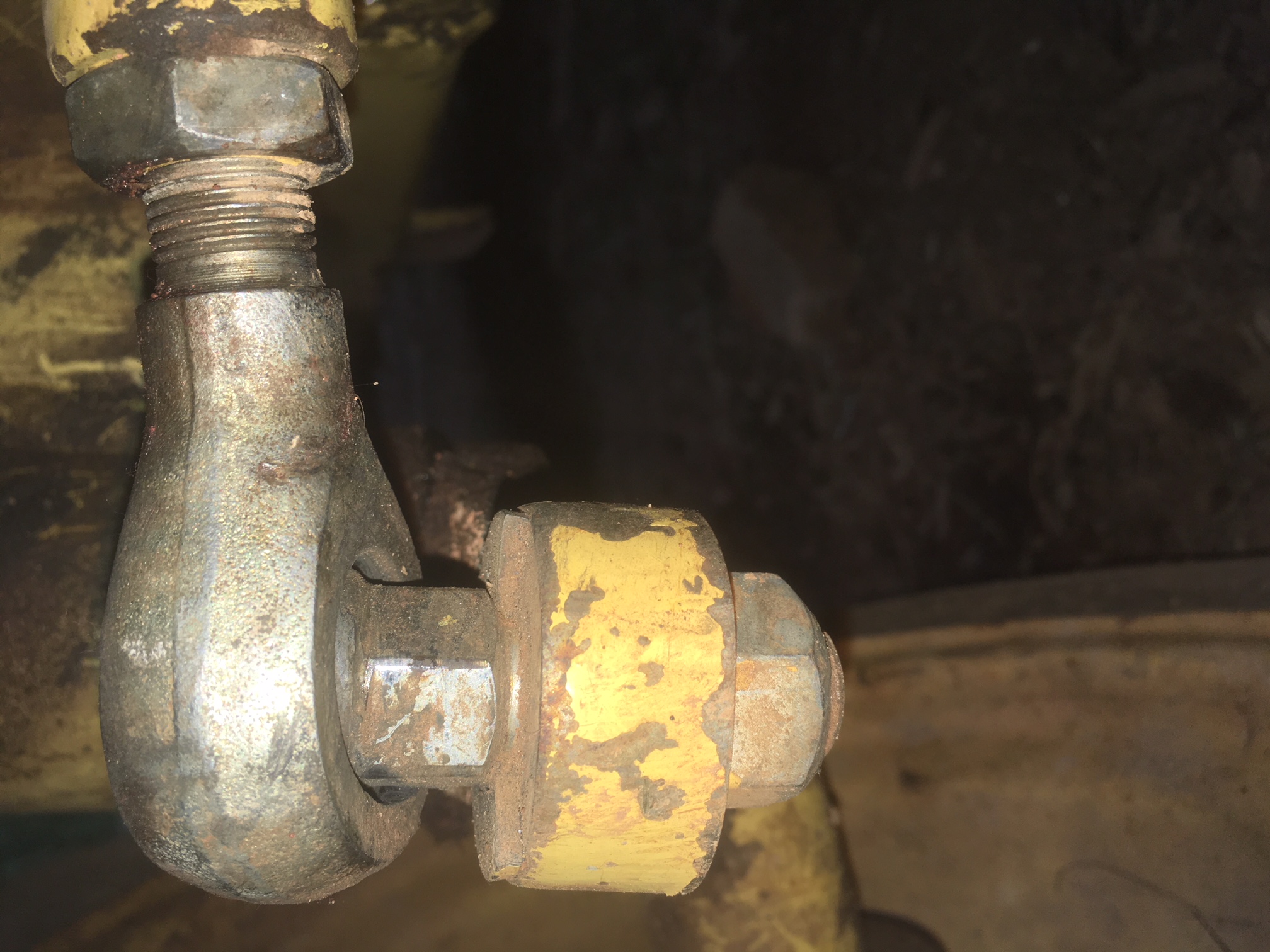

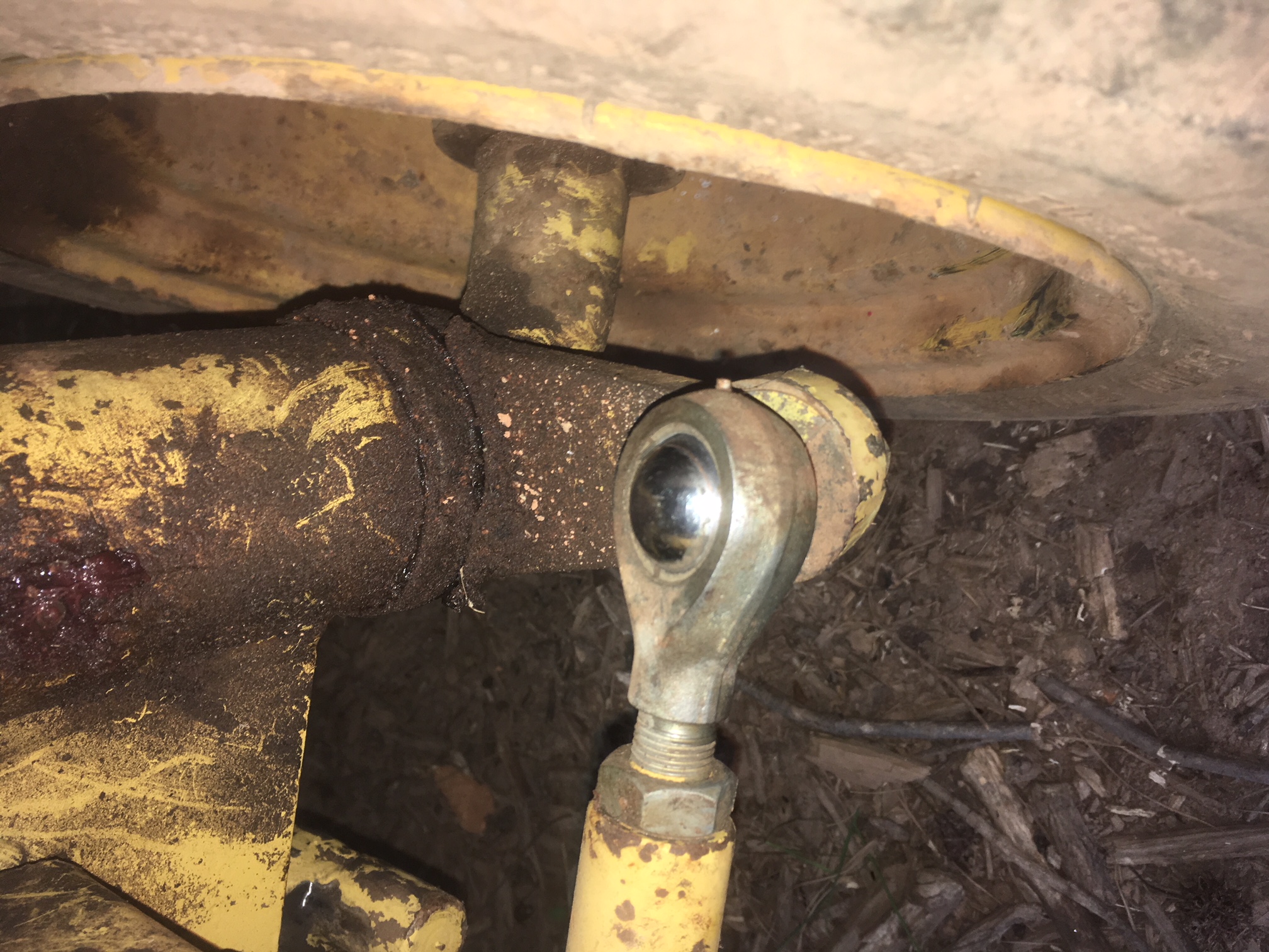

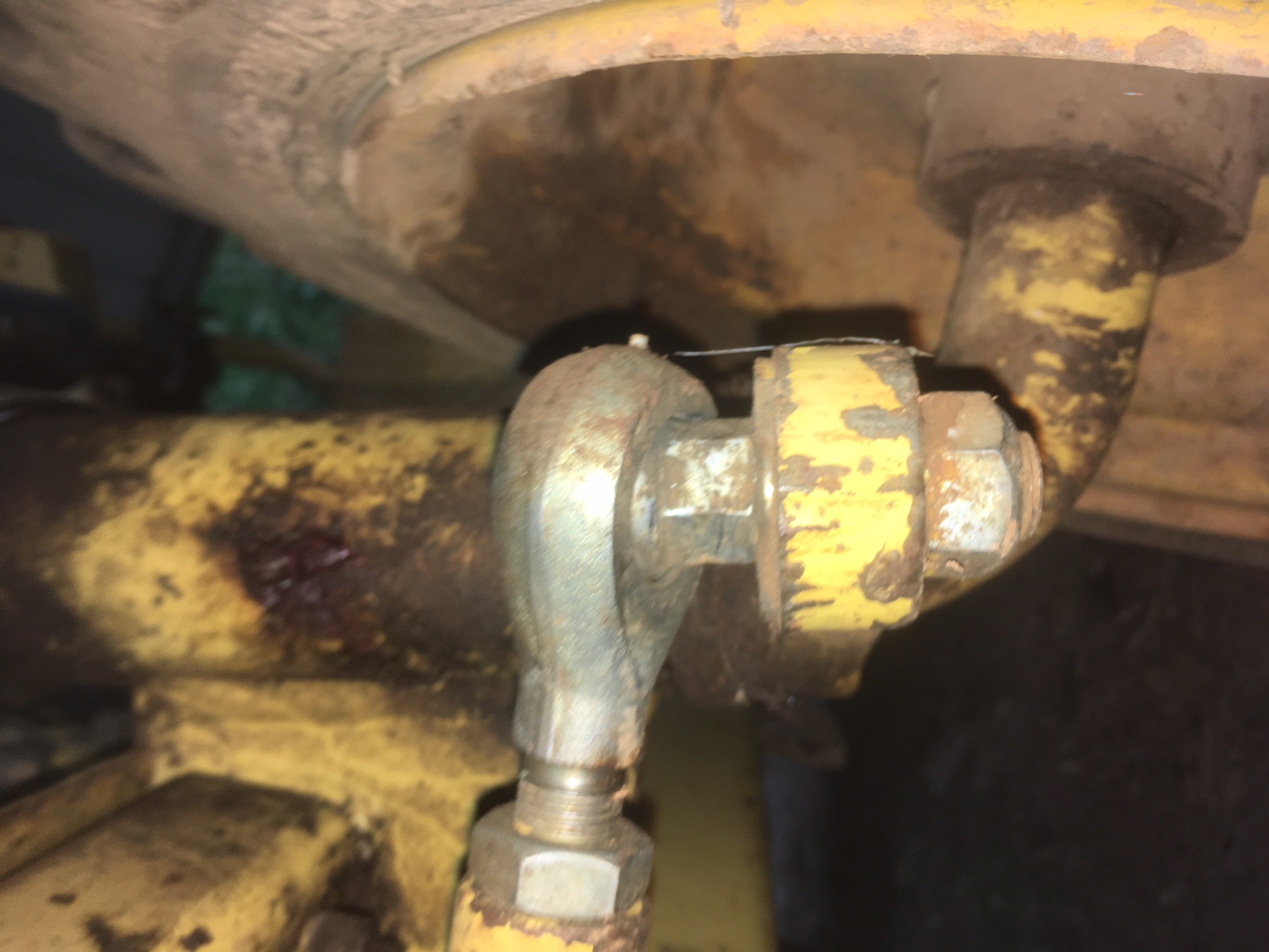

I need some assistance with getting part #'s for replacement tie rod ends on a 2005 T5C. I searched and only found part #'s for older models. Anyone have any info? Pics of my current tie rod ends are below.
Thank You

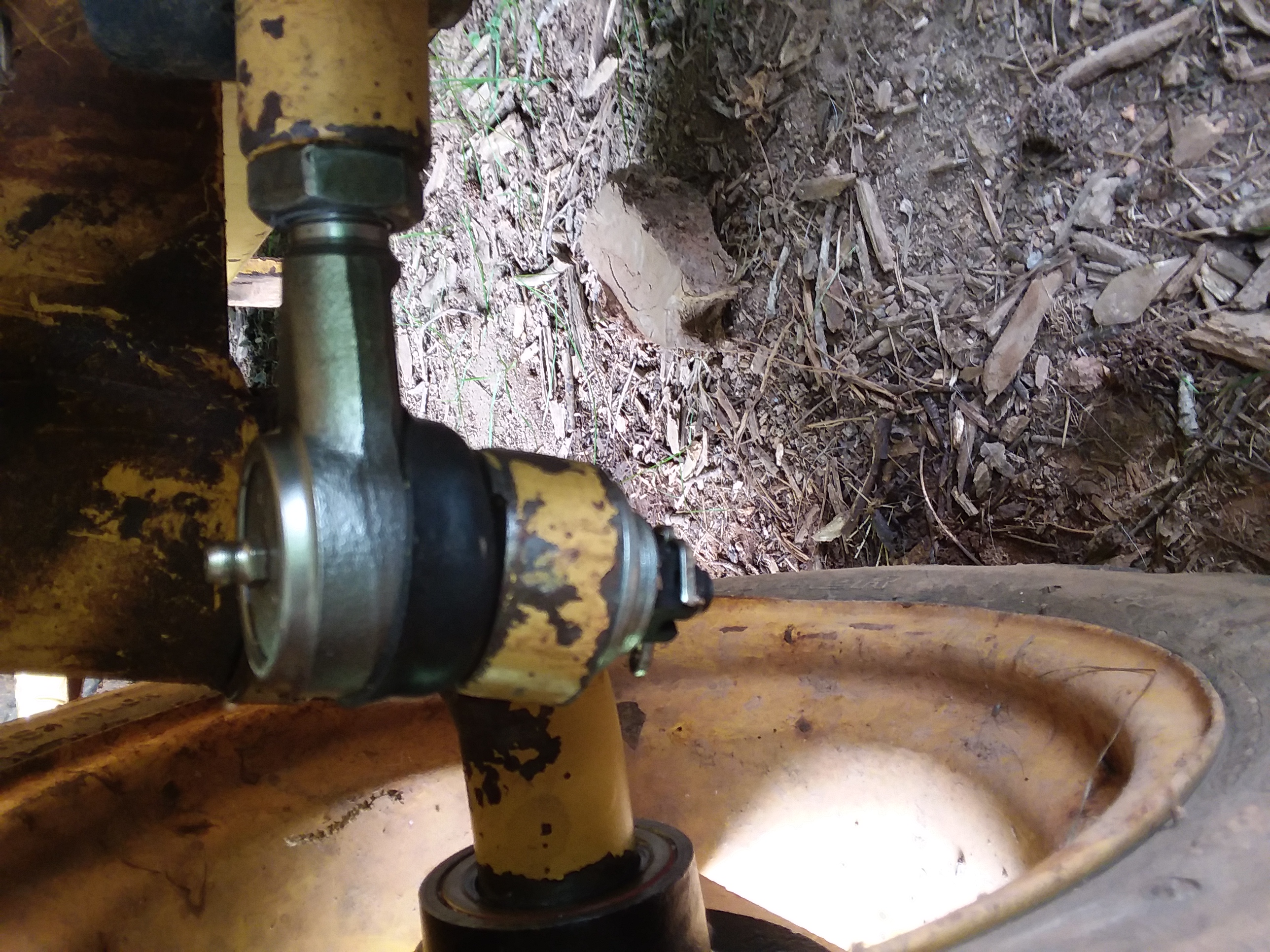

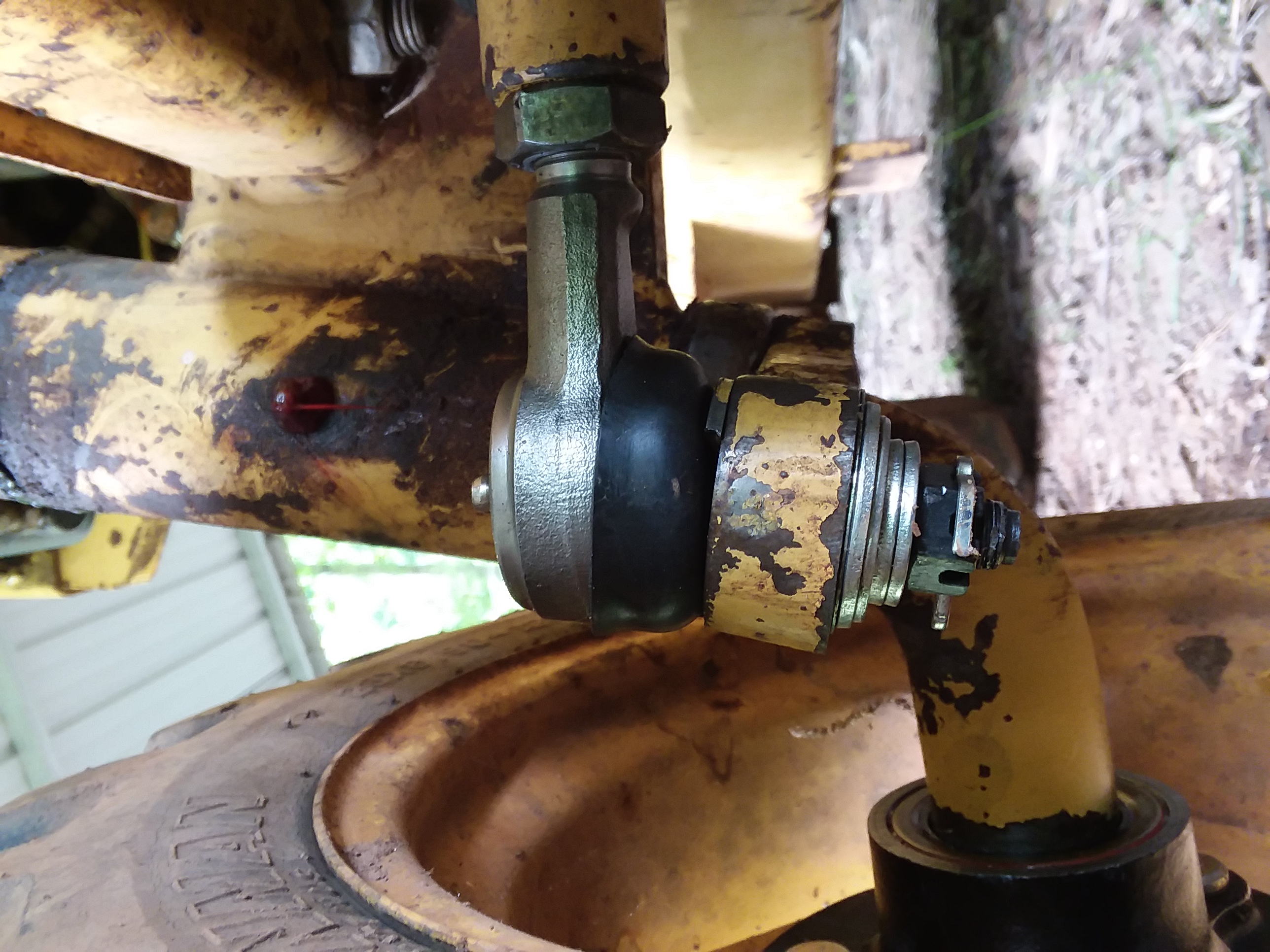

I received the ES323R Tie Rods that I ordered off of Ebay. Everything was correct with the exception of the part that fits into the spindle. It is tapered while the original appears to be consistent in width throughout, also I had to use some washers to act as spacers in order to snug it down real well. So far they are operating fine but I'll keep an eye on them. I would not recommend them to anyone else due to the issue of not being identical to the originals.

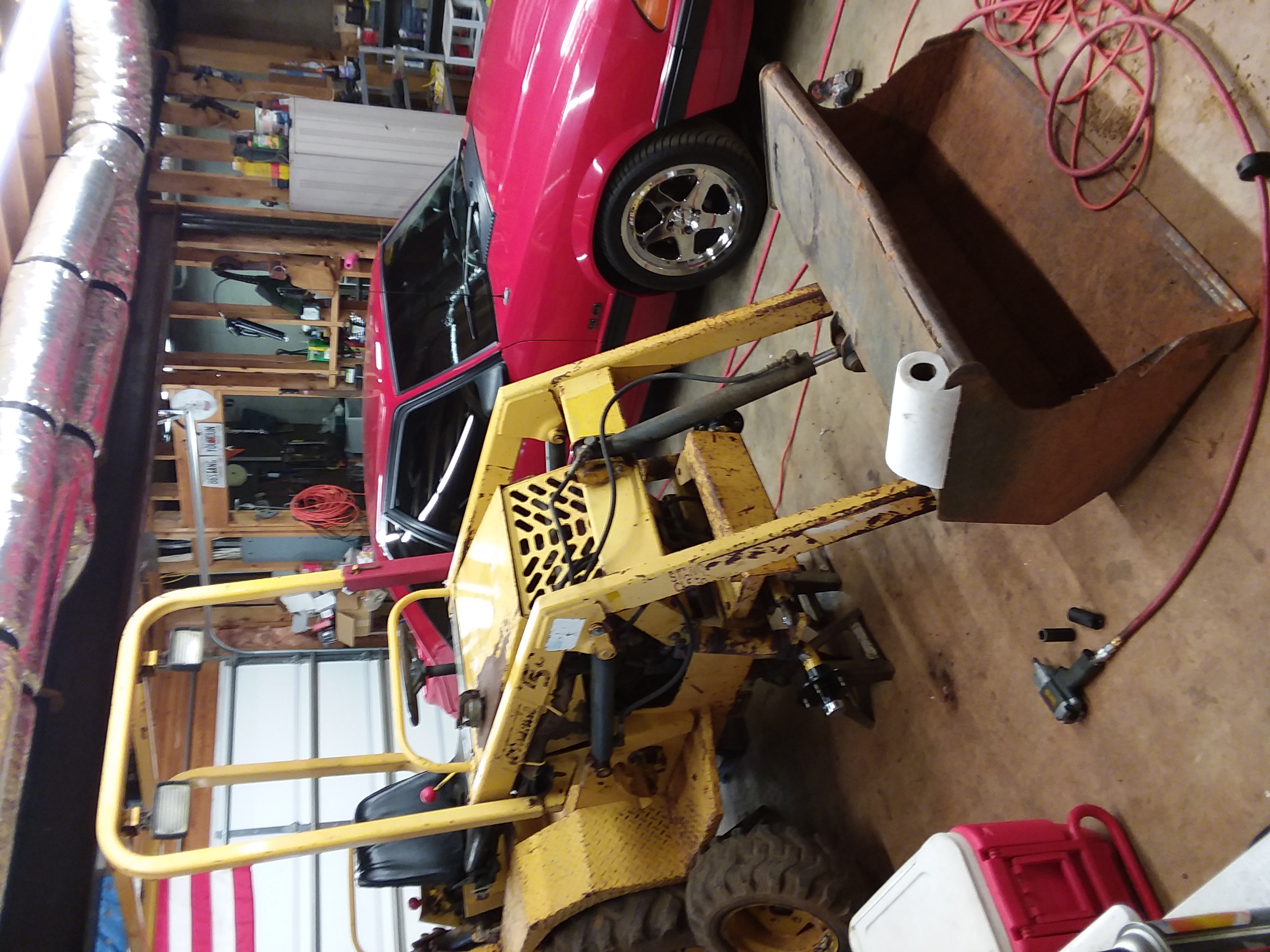

Gotta love owning a backhoe that you can drive into your home garage to work on!

Those look like the ones I replaced on mine years ago. They are the same as used on old Mustangs and Falcons. Been on for several years since and all good

Your originals are called ball joint ends or Heim joints. One source is McMaster-Carr. You just have to know the the thread size you need.
