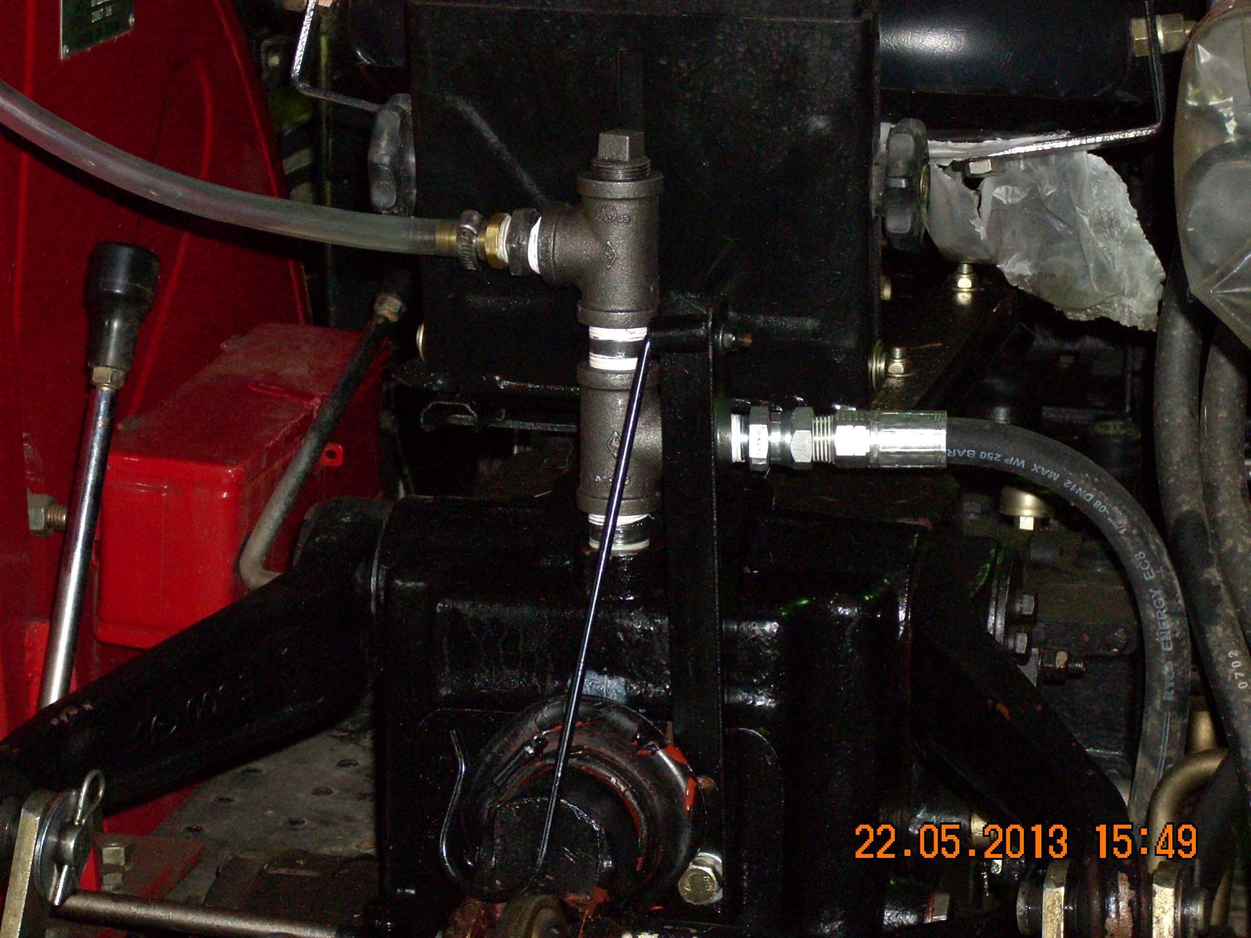

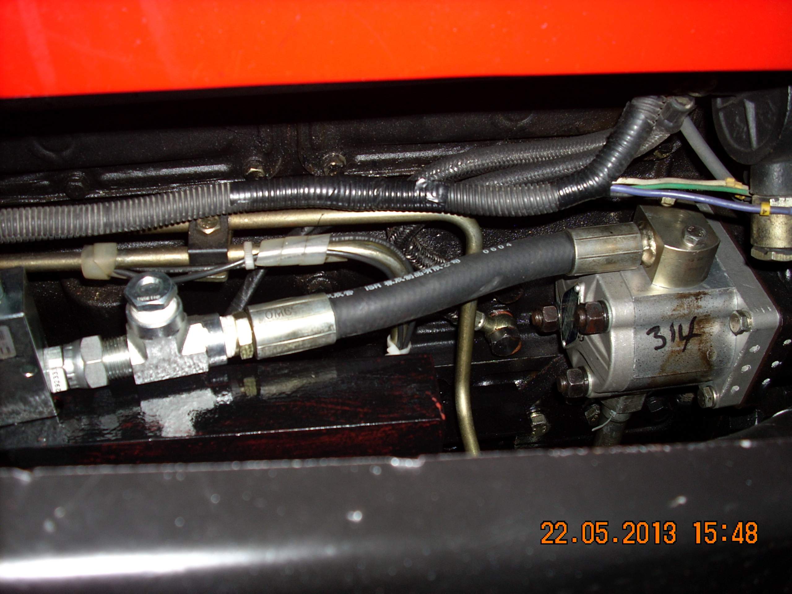

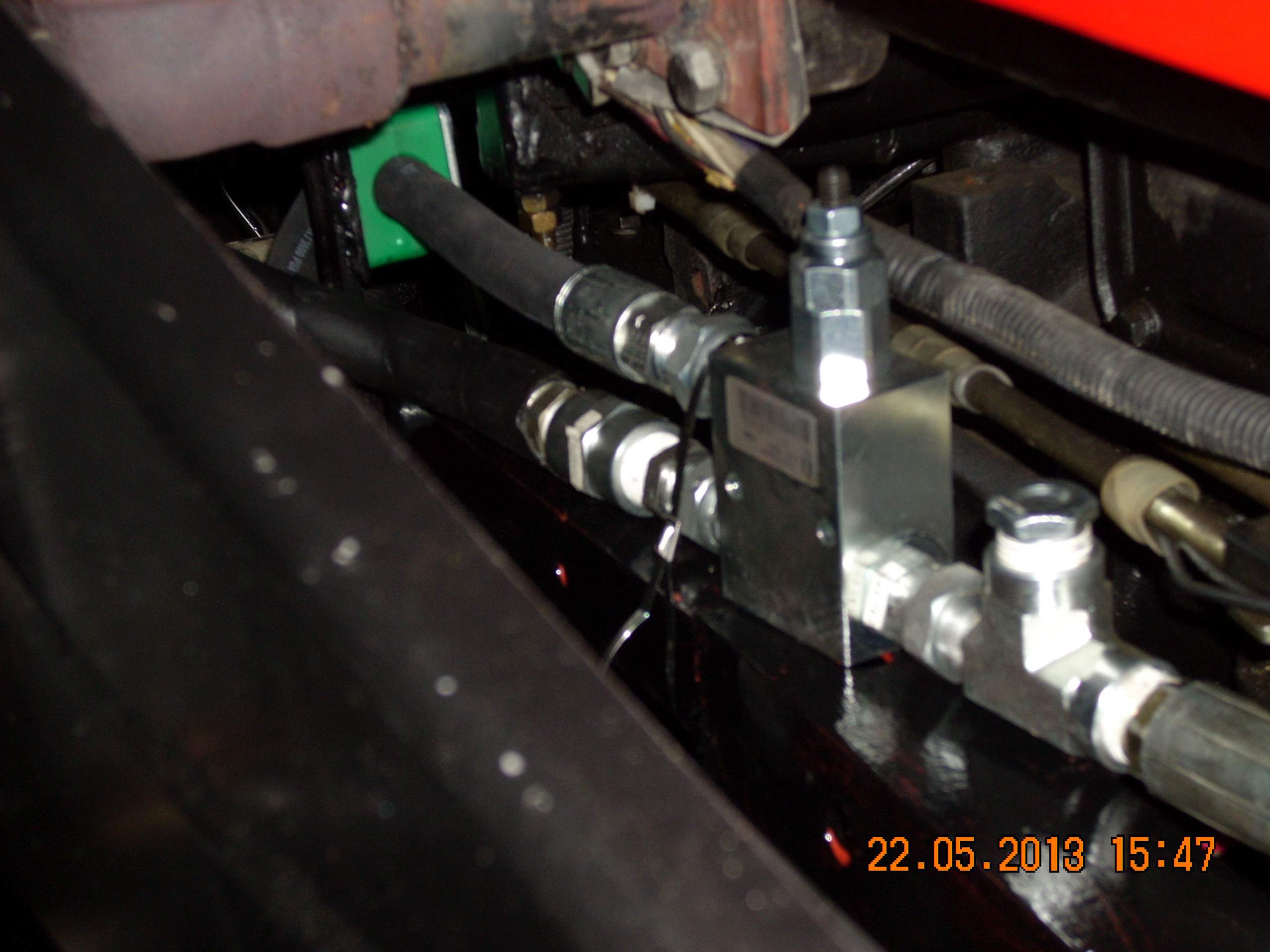

Can't help you on the TPH lever and valve, but I would recommend that you put in an external relief valve for the hydraulic pump. This could save you from losing the engine driven hydraulic pump.
I learned the hard way and it cost me a fair bit of money. The hydraulic pumps are around $250 each to replace.
If you find out what you have wrong with your TPH controls - please post as us others could learn from it.
Thanks.
PS - have attached what I did on my tractor for relief valve setup.
