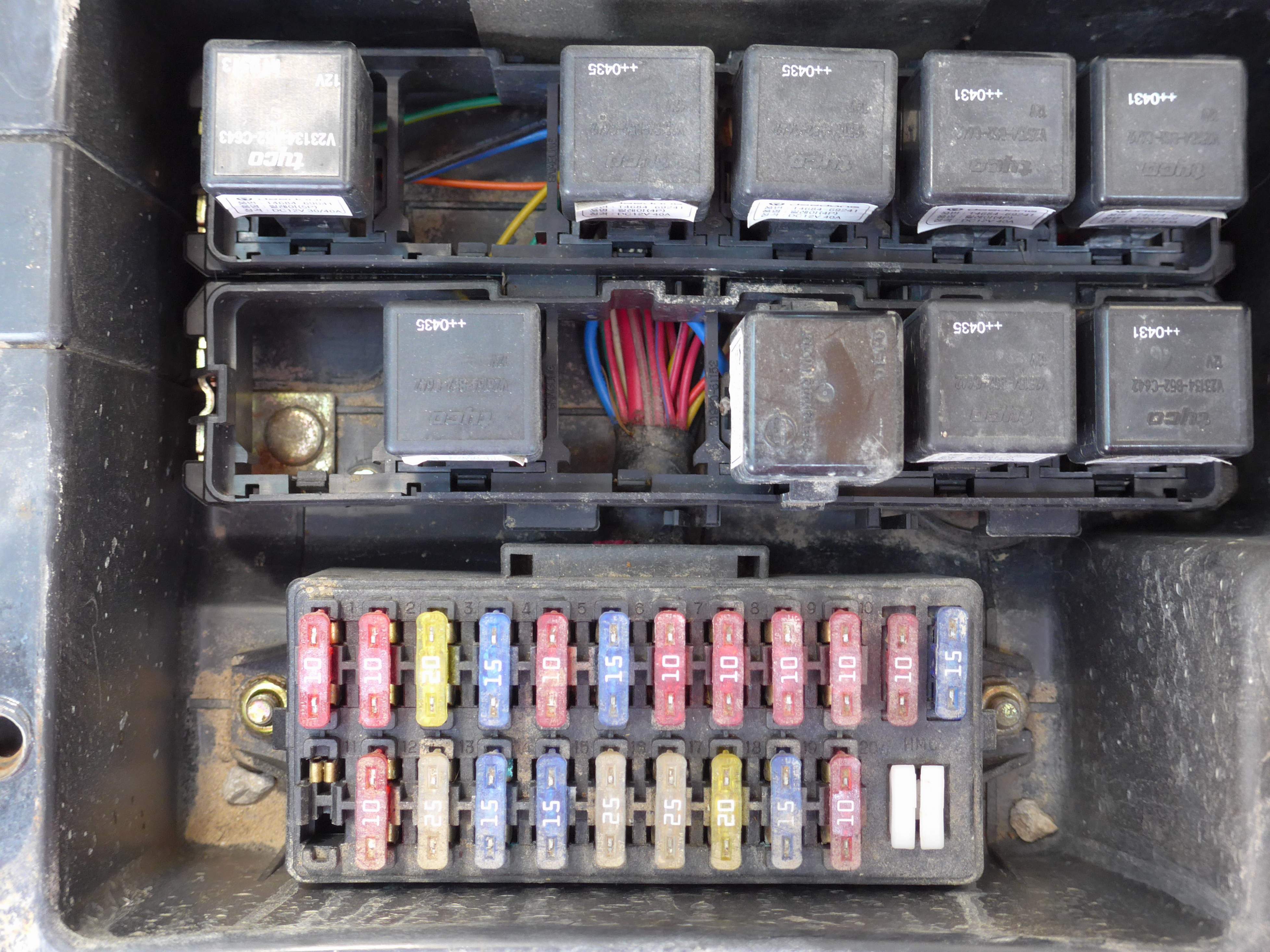

Just got my tractor back from the dealers and the ac will not work. Called dealer and he of course said, "it was working when it left here." Well, I of course starting with the fuse and put in a new one but ac will not come on. Next I went to check the ac relay and I can not find it. According to the picture on the fuse panel box it shows I should have a relay. I have attached pictures and hope someone can tell me if I am missing the ac relay and if that is the reason why my ac will not turn on.
Second question, I want to swap out one of the other relays to see if I can get the ac to work. But for the life of me I can not get one out. I see there is a little clip in
the front of the relay and I am pushing in out to release the relay but it will not come up and out. It will let me push it down and out but I still can not get it up and out.
Thanks to all.

My guess , from looking at the fuse and relay box is your going to find a connection (corrosion ) issue.
