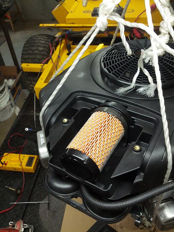

I also need a fellow Z Force owner to help me out with a picture of a wiring connection behind the seat.
Mine is a 44" with the Briggs and Stratton 18HP Intek. I am in the process replacing it with a 23 HP Intek.
I have an issue with what was connected to the termination under the big red wire in the pic below.
The color of the wire(s) A Cell phone pic would be great. Its right behind the seat.

I am trying to figure out where the double red wire termination goes. I am migrating a 23HP B&S into the 18HP's place and the wiring termination is different. The new motor is a 445577-6187 G5.
I figured the gray is the furl cutoff. The black is ground or motor cutoff?
It looks like I tie all the reds to the new motors red side. But the double red wire has me perplexed. I think it for the oil cutoff 98db speaker I hooked up but shame on me for not documenting better at disassembly. I'm going to be very careful with it.
Any help with the wiring would be great.

Much better air filtration then the old 18HP that lost a cylinder.

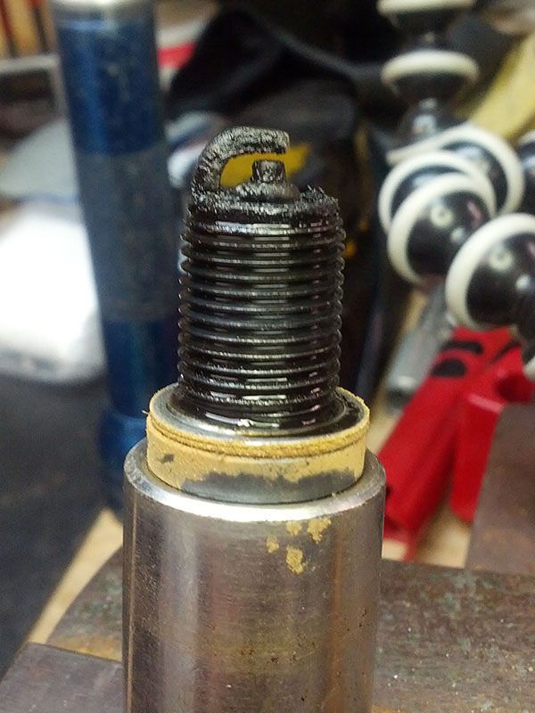

intek_headgasket01_zps668b9a5f.jpg~original

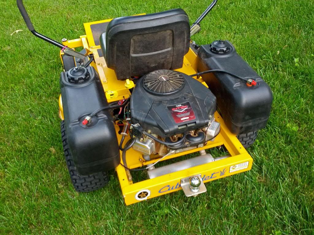

A Before Pic / I added the Right side tank when I purchased it. Its the first year they came out with the Z Force.
