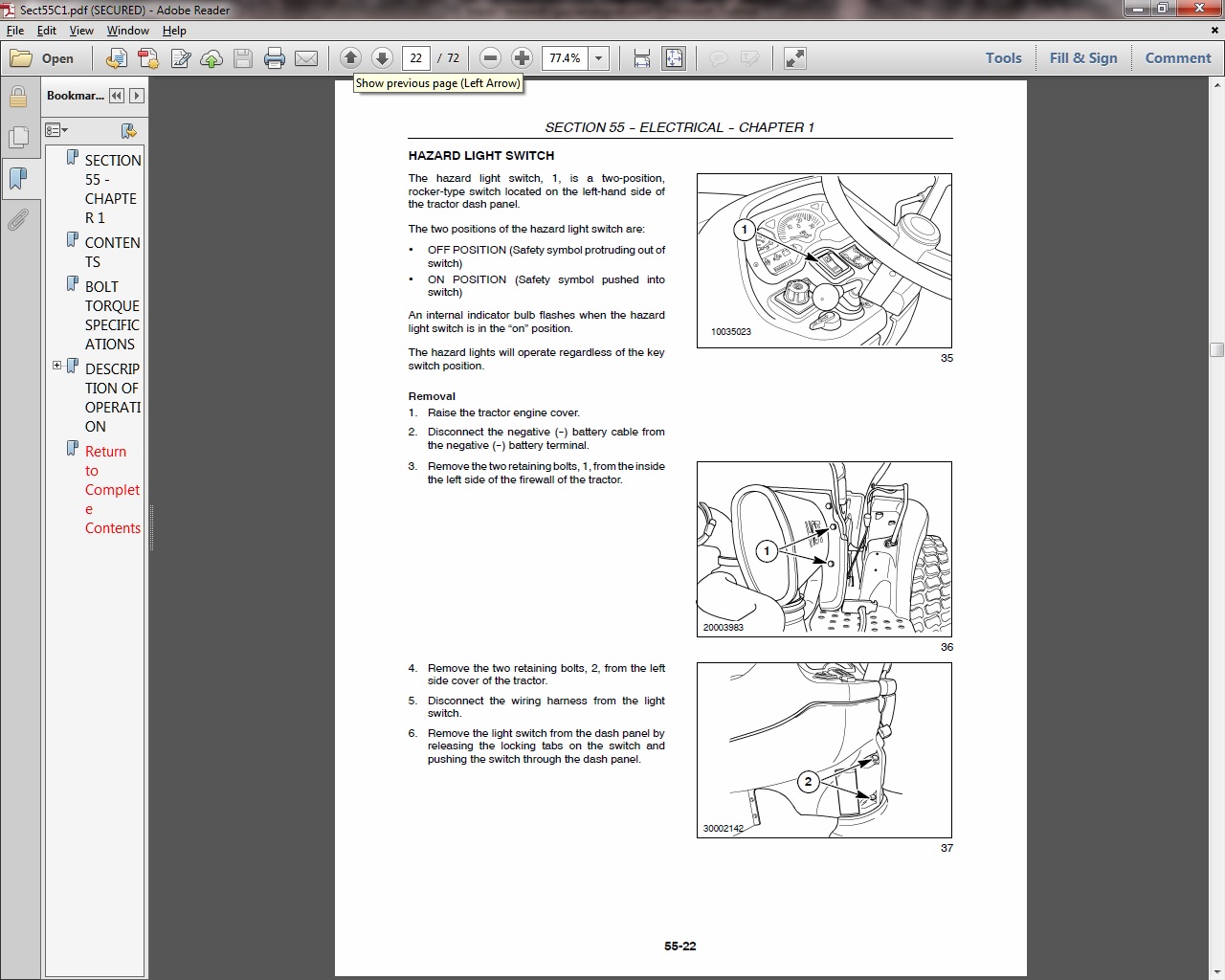

It actually isn't an automotive type flasher, it's a control unit that is a NH only part and it isn't cheap. Here are the relevant pages on that from the service manual.
Does the service manual show how to test the dash switch, as to witch prongs should have power going out when in the on or off position? Thanks again Don If only I could be so lucky that it's the switch!!!!!

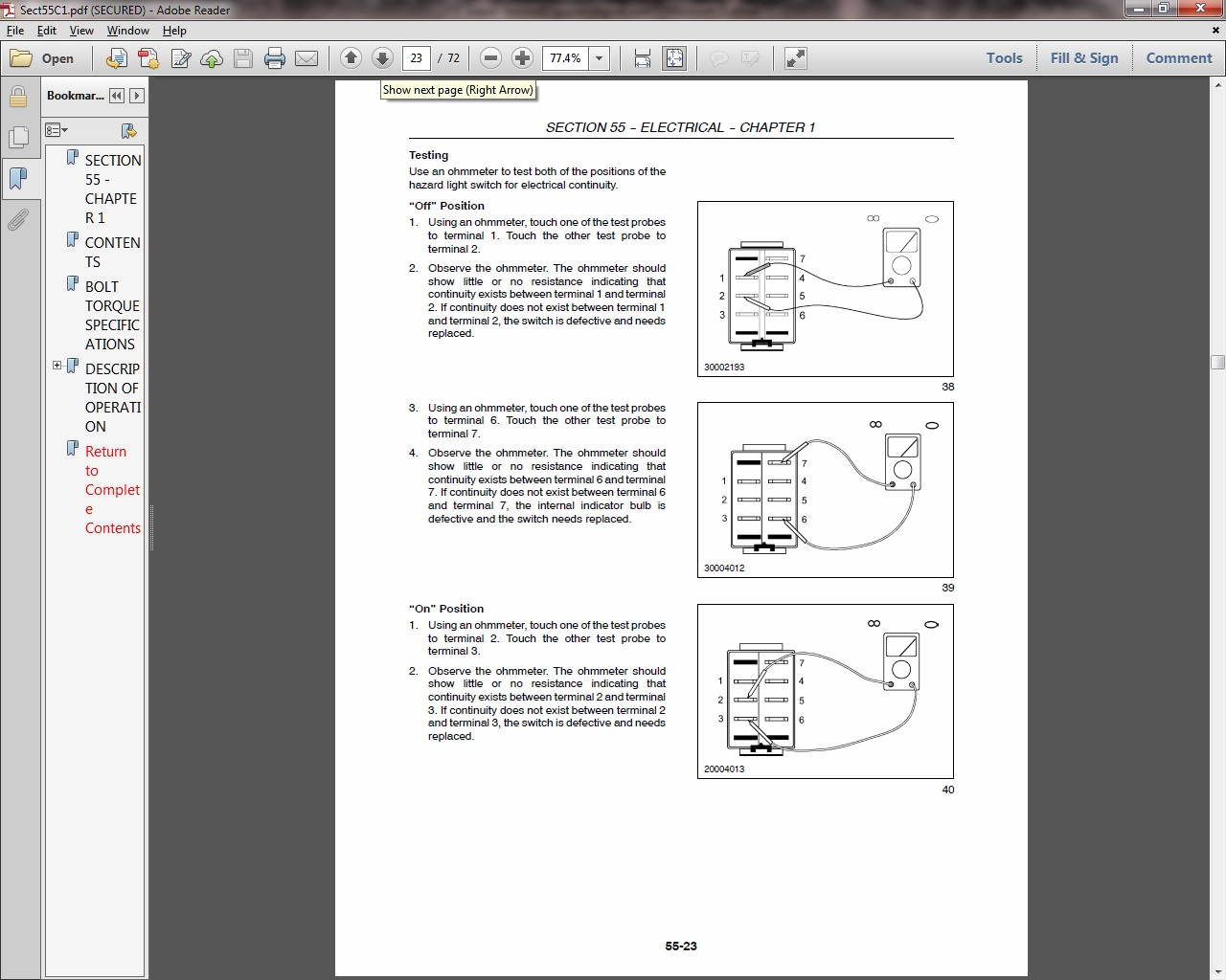

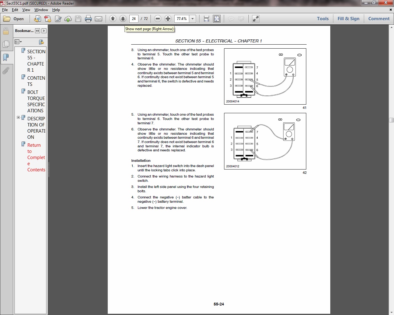

Here are the relays and instructions for testing the switch. Glad it ended up being something easy for you.
