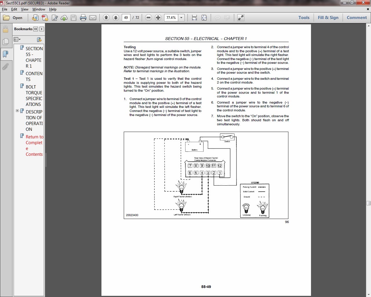

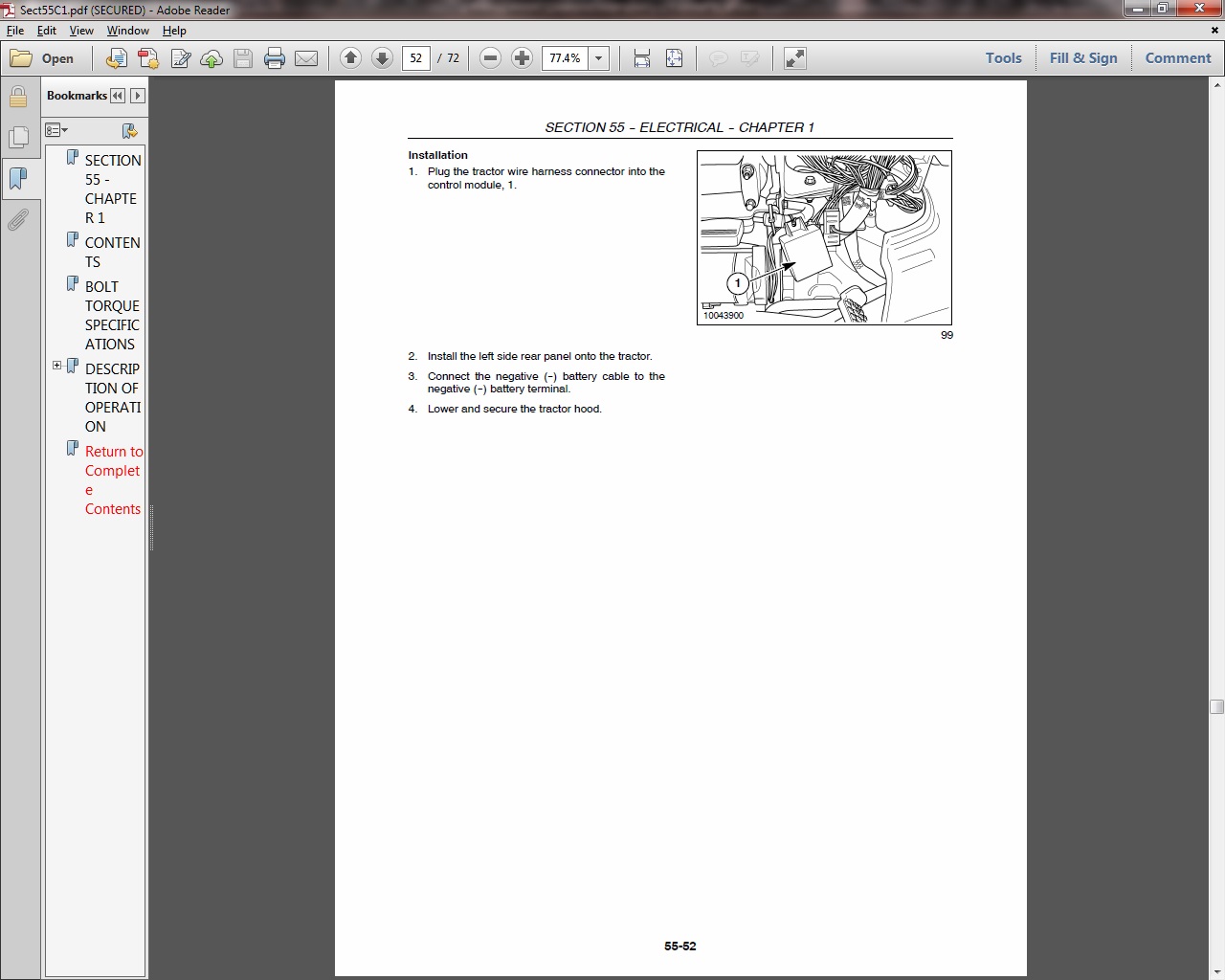

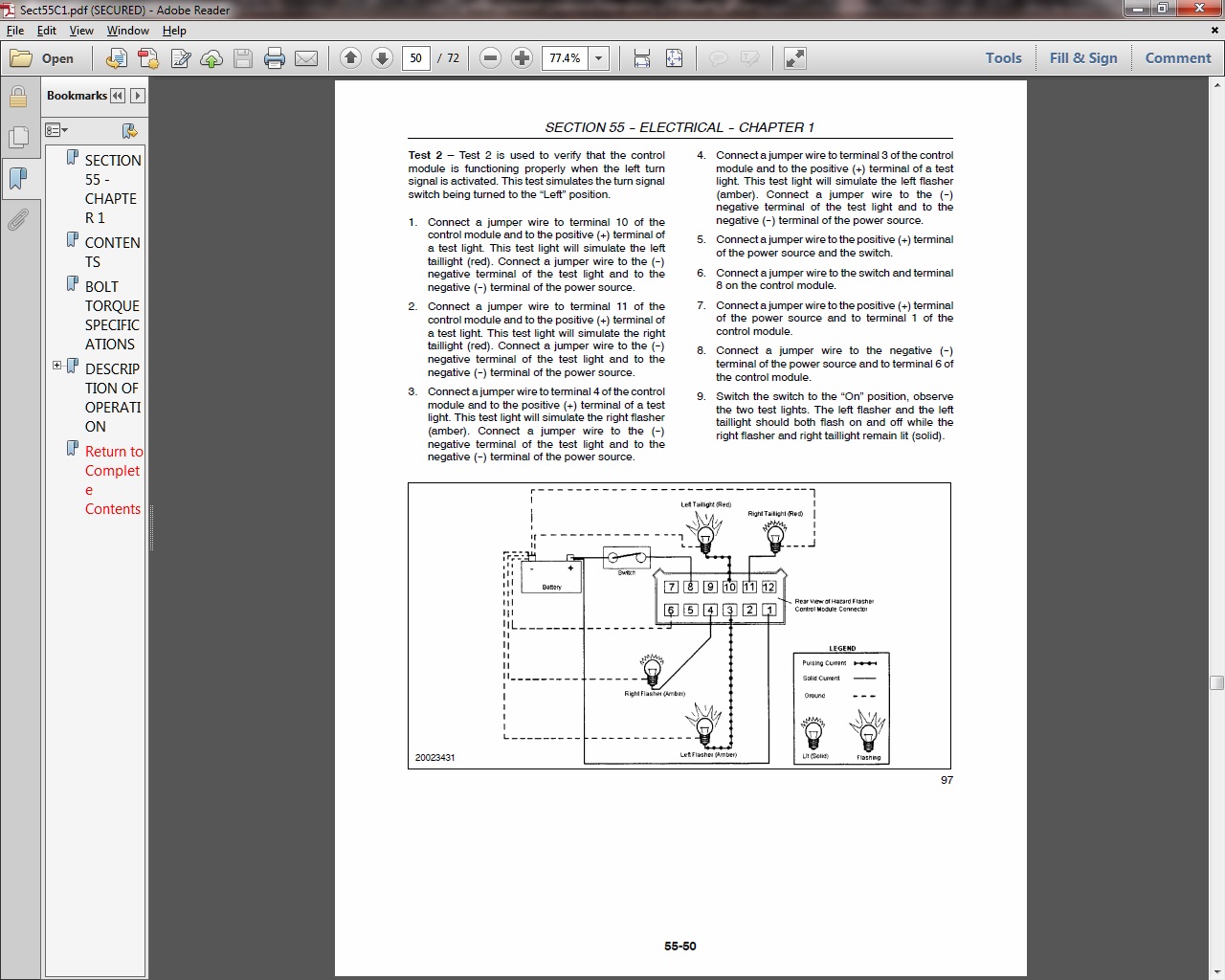

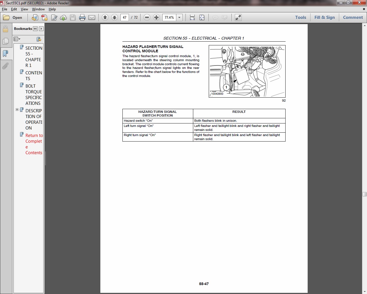

STx -I also downloaded that manual this evening, and I also want to THANK YOU for making it available. Sometimes it's so much easier troubleshooting something from the computer before digging into the tractor to fix it, and this helps.
