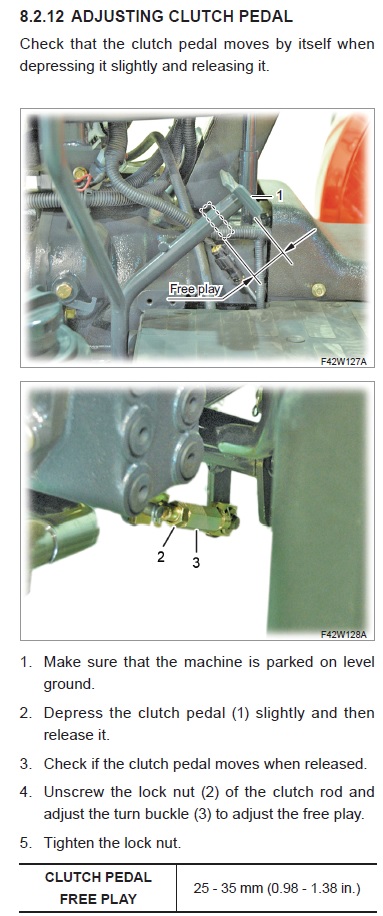

I hope this is the best place to post my question. I have a 2004 3510 shuttle shift w/FEL and backhhoe. The backhoe is a 3375 model - heavy duty - does great work. Here's the question. I recently started having issues getting the tractor to go into gear. I was hoping it would involve a simple shifter cabel adjustment. Sent it to my local dealer - 45 miles away (not the one I bought it from - they are no longer in business). They told me the synchronizers are bad. Quoted me $5,000 to replace. I distrust them, because they did some unauthorized repairs to the tractor (telling me they adjusted the cable - said it worked much better, charged for a hydraulic fluid change and two hours labor (when the bill says they simply "topped off" the fluid, and since I had inquired about a replacement moisture cap for the ignition, they put a whole new ignition on it. Sent it back to me with a $2,000! bill. Tractor wouldn't go into gear, it was undrivable. I told the delivery guy to take it back - it wasn't usable. That's when they said the REAL problem was that the synchronizers needed replacing and wanted an additional $5,000. for that. I haven't paid them anything yet, but started talks with them about "trading up". They offered me $7,000 as is for the tractor and FEL. Don't want to give me much of anything for the backhoe, as it will "only fit a tractor with a subframe", claims it limits its usefulness too much. We are kind of at a standstill. I treat this tractor with "kid goves". It has about 600 hours on it. Don't understand how the synchronizers have gone out on it. I did have to replace the clutch within about two years of my original purchase, so I am wonderiing if they had a kid driving it around their lot before I bought it and was "crashing" gears, and overusing the clutch. I've had it 13 years since then with no further issues.

Does the tractor use a dry clutch?
I'm wondering if the clutch is out of adjustment and not releasing completely. To test this, shut off the engine, push in the clutch, shift the trans from gear to gear. If it shifts easily, and then is impossible to shift with the engine running it would be caused by the main shaft in the trans trying to turn all the time when engine is running. That would relate to a clutch problem.

Not if it's a dry clutch. Simple linkage adjustment. Not sure about maintenance adjustment on a hydraulic oil clutch.

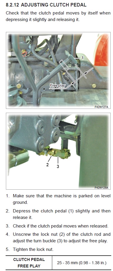

Yes the 3510 is a dry disc clutch. It's actually made by TYM apparently.
This is for my tractor but it's pretty much the same for any tractor with dry clutch. Just the linkage will be different.

You need to adjust the clutch. I have a 4110 Mahindra and I just did it after years of hard shifting and the problem was solved. To get to the adjuster I took the loader off then the loader mount which then gave me easy access to the link .I tried to do it with out removing the mount and couldn't get enough swing on the wrench . Good luck
