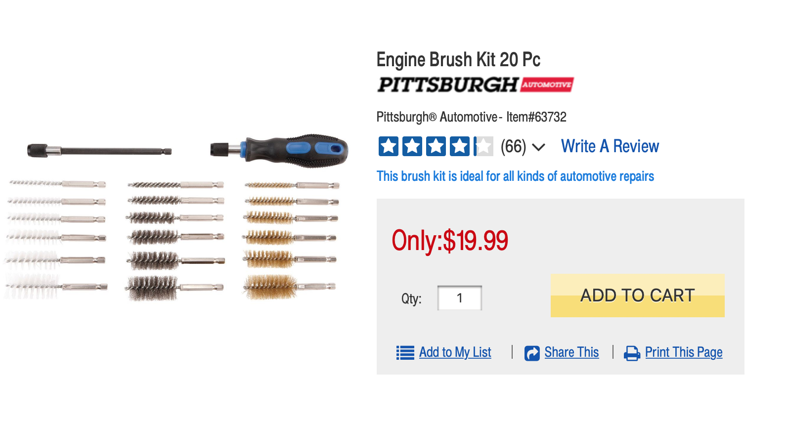

Oh ! I like the brush set you have . Remember where you got them ?
   / 2003 Kioti CK20HST FEL slow to operate, reduced lifting capacity.
#32
Harbor Freight, worked great for this project.
