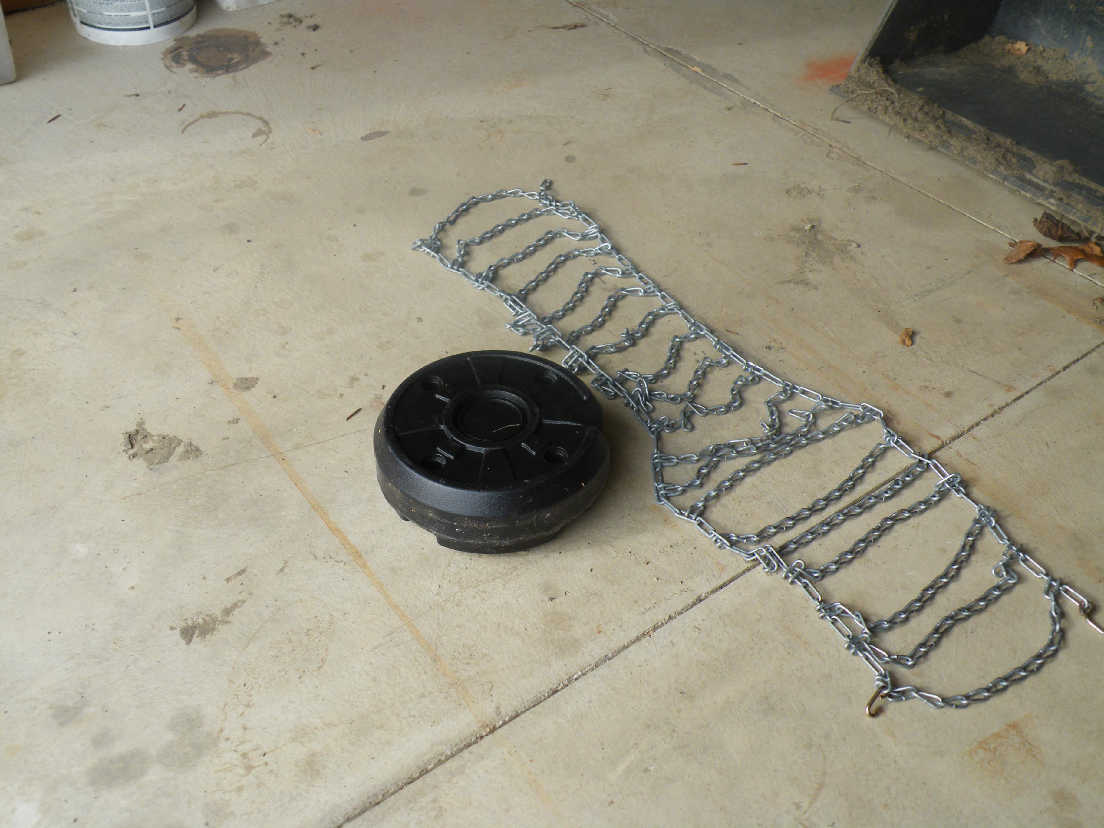

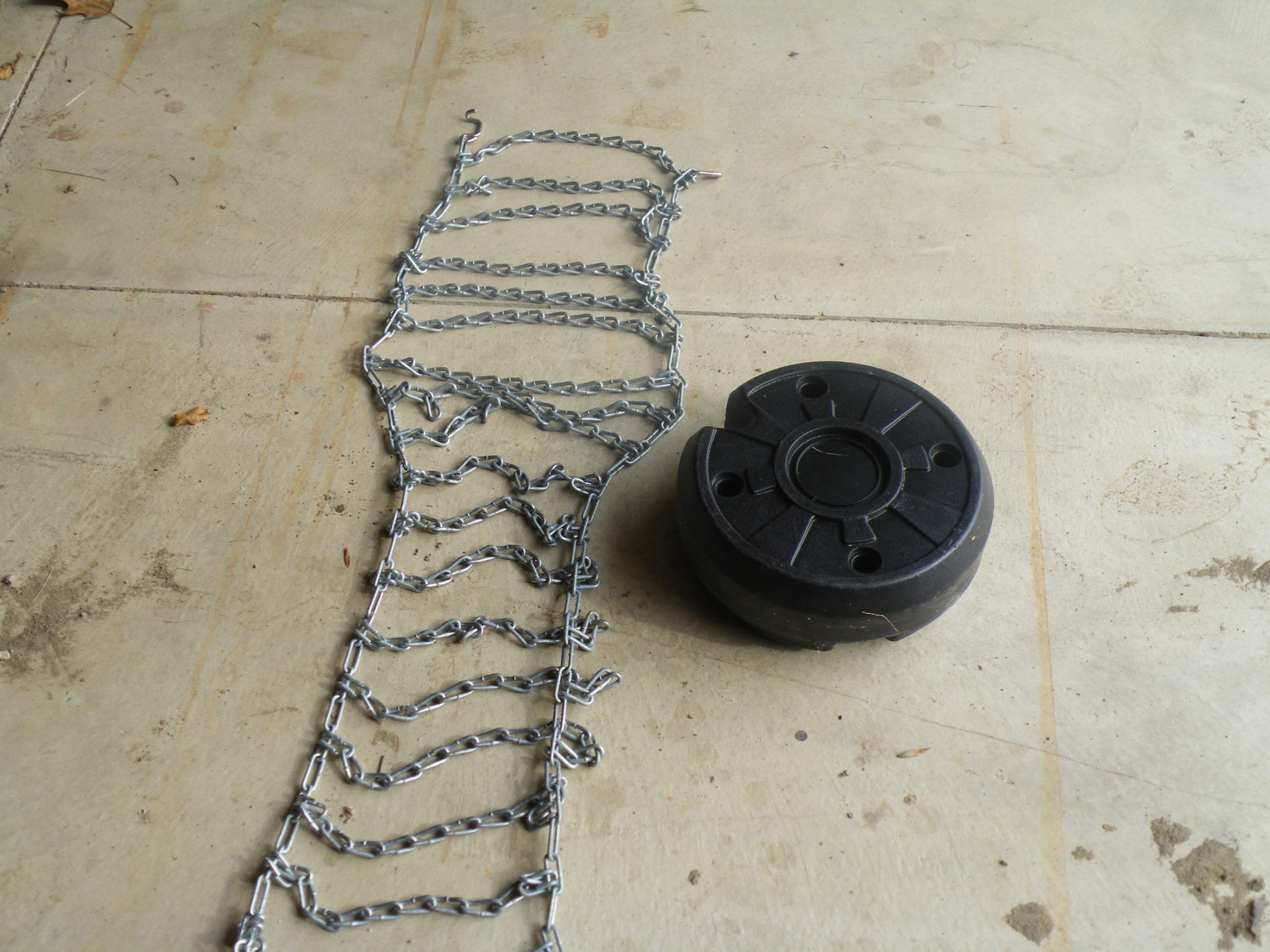

Could they fit in a 12" x 12" x 5.5" flat rate shipping box (one each, of course).
/ 2003 Broadmoor attachment lift kit #12
You think?
