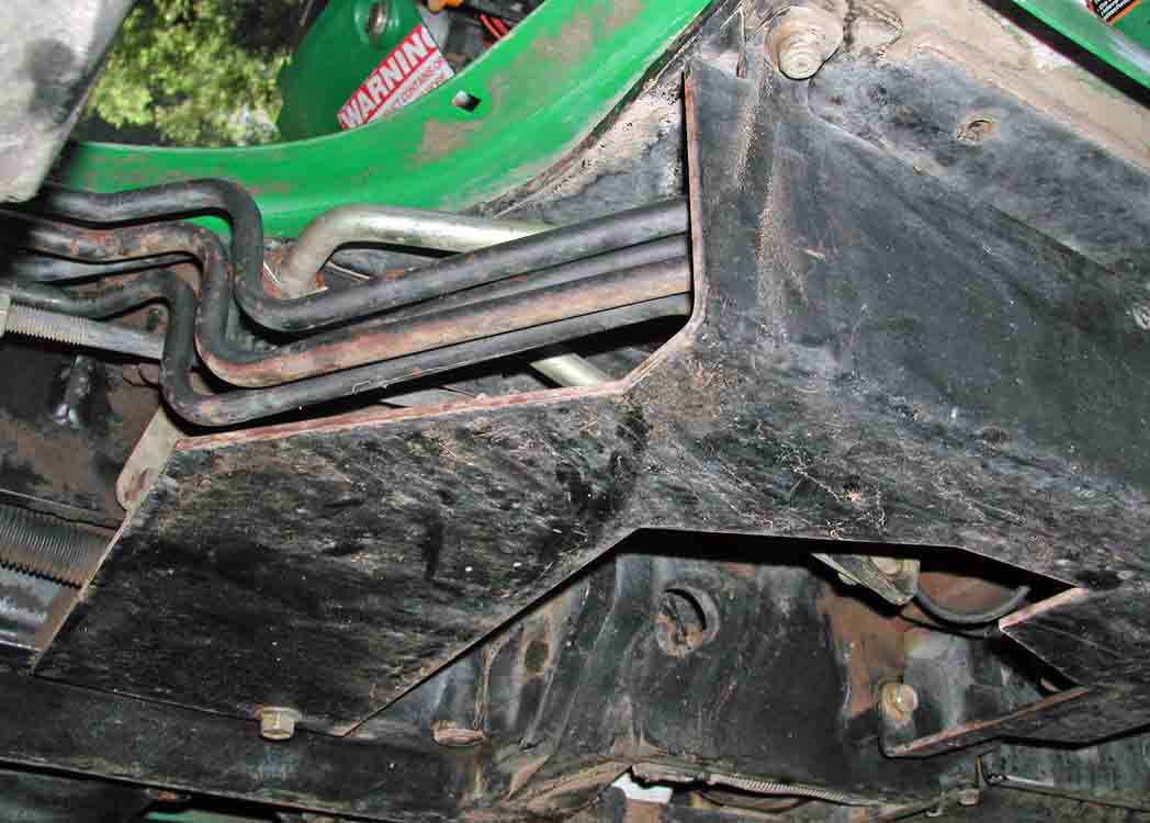

It also has protection armor underneath (pix). Notice the pristine
FEL hardlines. My last 4300 has no such under-armor, and the hardlines
were a bent-up mess. Nice setup.
In the same photos, you can see that JD has gone to a totally different
HST control, vs. the older units. The 'go' pedals operate the round
shafts in the top of the 1st photo. It was hard getting the older controls
adjusted properly.
