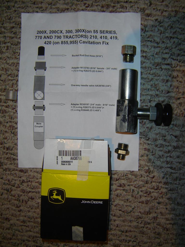

Glen said:
I'm coming into this late, but I had this mod done last summer, early, and the difference was dramatic. My dealer, JD Equipment, picked up the tractor, did the repair, and brought the tractor back, (round trip is about 25 miles) and didn't charge me a penny. I had about 100 hours on my 2305 at that time. Maybe I'm lucky to have an exceptional dealer, but doesn't sound very 'Deere-like' to me to try to duck the issue.
Glen
Hi Glen, did you get the fixed orifice solution or the needle valve? Could you possibly post a picture of your installation of this kit? Here's a picture of what my sales guy brought over for me today. He couldn't stay to install, so I guess I"m on my own :eek:
If I understand the Solution description correctly, I need to install this at the "bucket rod end circuit". Basically, I'll be restricting the flow of fluid out of the cylinder, which currently undergoes cavitation when dumping heavy loads.
Anyone have any thoughts/comments.
Do I need special tools. Looks to me like a crescent wrench is really all I need.
Gord

ducati996 said:
Never had an issue with either holding its back blading position or fast dump (that i could notice). Sounds interesting and I will pay close attention next time on on it, to see if I can pick up on anything -
Hi ducat996, the problem statement on the JD Solution record # 35065 states that 'featherig or metering of the control to dump slowly will increase the amount of cavitation'. So rather than trying a fast dump, try it slowly.
Once the load is dumped, curl the bucket back up and see what happens. Or, once dumped, try to back blade the material you just dumped and see what happens.
Note: This only happens while dumping heavy loads. It was happening to me many times this evening as I was laying heavy sand down on the slope of a pond I am building

Gordnovo , please install the fix. and post pictures of the installation . and let us know what you think. to me it seems if it restricts flow out of the Cylinder. seems like it would make the bucket dump slow....:(
let ou know what you think and how it works....:)
Gord
Gord this kit you are showing i am seeing only one. is there 2 valves one for each side. like the one you posted? well there has to be. one for each cylender...:)
Gord
Gord,
I don't see anything resembling what you show in your picture. Since the dealer did the work, I didn't see it happen, but I'm almost certain it was a fixed orifice that was installed, at least that's what was talked about when I talked to service about my problem. There was a service bulletin on this issue, but I can't tell you what the number is. If you like, I'll contact the dealer and find out what it was, and how they fixed it.
Glen

Glen said:
Gord,
Glen
That's Ok Glen, I'll get in touch with my dealer's service guys here. If it's not difficult to do, I'll take care of it.. if I need special tools, I'll need them to do it for me.
