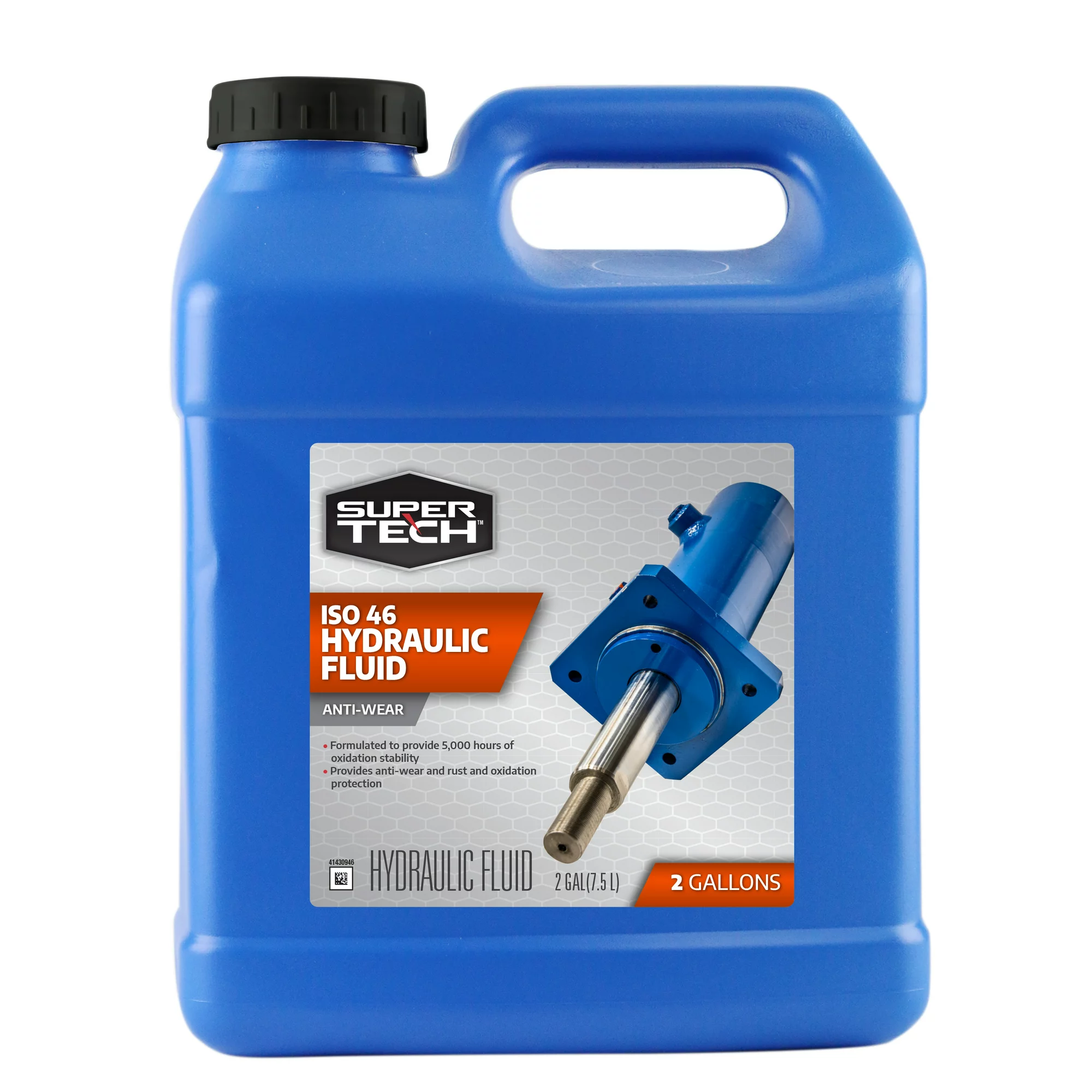

/ 20 Weight Hydraulic Oil #11
Super Tech Heavy Duty Rust and Oxidation Anti Wear Hydraulic Oil, 2 Gallons​
(4.6)4.6 stars out of 25 reviews25 reviews
$33.2713.0 ¢/fl oz
