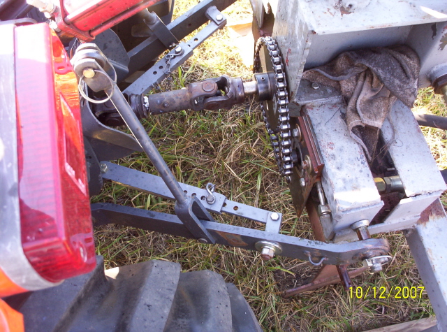

Yes I did, but I only had to go 3 to 1 my pump is a single stage. I used #50 chain.

Leejohn, if that is a Barnes 2 stage pump ( can't tell from the pic) did you have any problems with the side load on the input shaft? I didn't think they were made to take any kind of a side pull with the 1/2" dia shaft.....Mike
   / 2-Stage pump driven by PTO?
If I do it, I intend to use an out-board bearing on the pump shaft. I will incorporate it into the bracket that will hold the pump. I intend to bolt the bracket to the tractor above the PTO output shaft with 2 bolts into the rear-end housing below the turnbuckle bracket.
