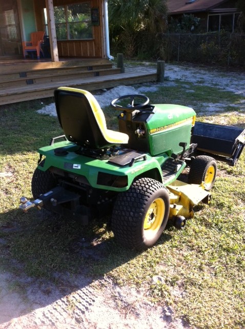

Howdy All -
I am getting ready to pull the trigger on trading in my JD425 AWS on a new X749. One of the things I use my 425 for is jockeying trailers around for storage on my property. One of my trailers has a 2" ball and another has a 2 5/8 ball. As you can see from the picture of my 425, I had a buddy weld a 2" receiver to the rear weight bracket which, allows me to swap out to the correct ball size.
It looks like there is an add-on 1 1/4" receiver for the X700 series but that will never accept the ball sizes I need and is way too low to the ground. Can anyone out there help me with any ideas on how to get there? This is by no means a show stopper...I just hate to spend that kind of $$$ on the new machine and not have the utility I have with the setup on my 425.
Thanks in advance for any advice!

Dutch - They are aluminum boat trailers and I only move them around empty (boats are on lifts at the dock). The 425 moves them around just fine. You can also see from the pic that I have a JBSr bucket on the front of the machine...couple of cinder blocks in that and the front stays down just fine when moving the big trailer around. The ball is up a tad high but works just fine because I usually set the tongue jack on a block and only have to come up the height of the ball to get it off.
I guess I could have something welded up...I just notice that the receiver adapter they sell for the X749 goes on the bottom of the current hitch plate so whatever I have made up will have to come up quite a bit higher.

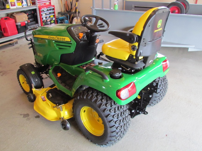

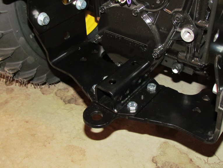

   / 2" Receiver Solution for X749 #6
In this pic you can see the JD hitch they make for the X7XX's that I installed on mine. The directions say to mount it under the hitch plate and I agree it's to low. With the holes that are in the hitch it self you can mount it on top of the plate if you want to make it higher and it should be stronger sitting on top of the plate vs hanging under it.
Like the others have said I just got a adapter that goes from a 1 1/4 to 2" and you can run what ever size ball you want.

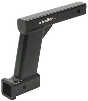

There's some fairly large "drop" hitches out there,
turned upside down they become a "raise" hitch huh?
From E-trailer website:
Yep...thanks for the pointer to the e-trailer website. Looks like I'll be able to find everything I'll need to make it work there!
