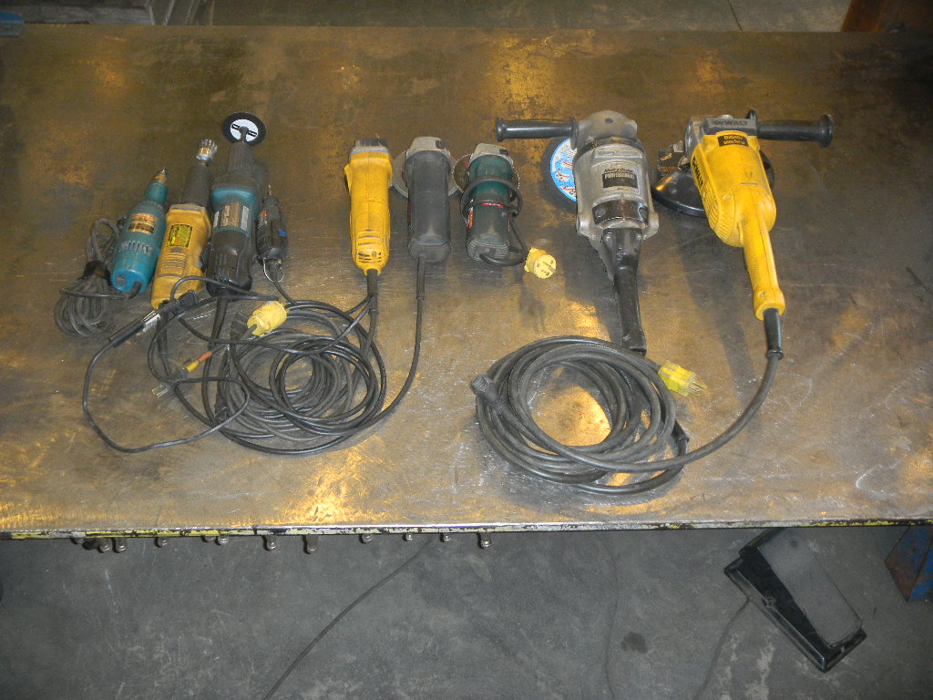

Really depends on exactly what I want to do, then I pick one of these to work with.
