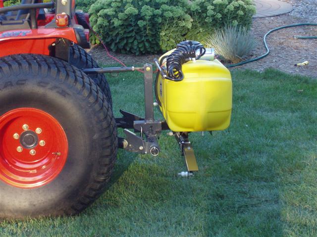

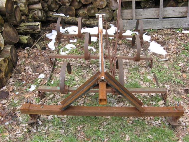

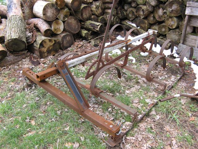

In addition to the trailer ball I usually have in my reciever hitch, I have a sprayer I made to fit the receiver. My last project was making a hitch for my pull-type spring tooth drag that I use for the garden. It is lot easeier to make something for the 3pth with just a piece of 2" square stock than to make a complete 3pt attachment with lower link pins and a top link yoke. For light duty implements the reciever hitch is plenty strong and is easier to attach to the tractor, too.

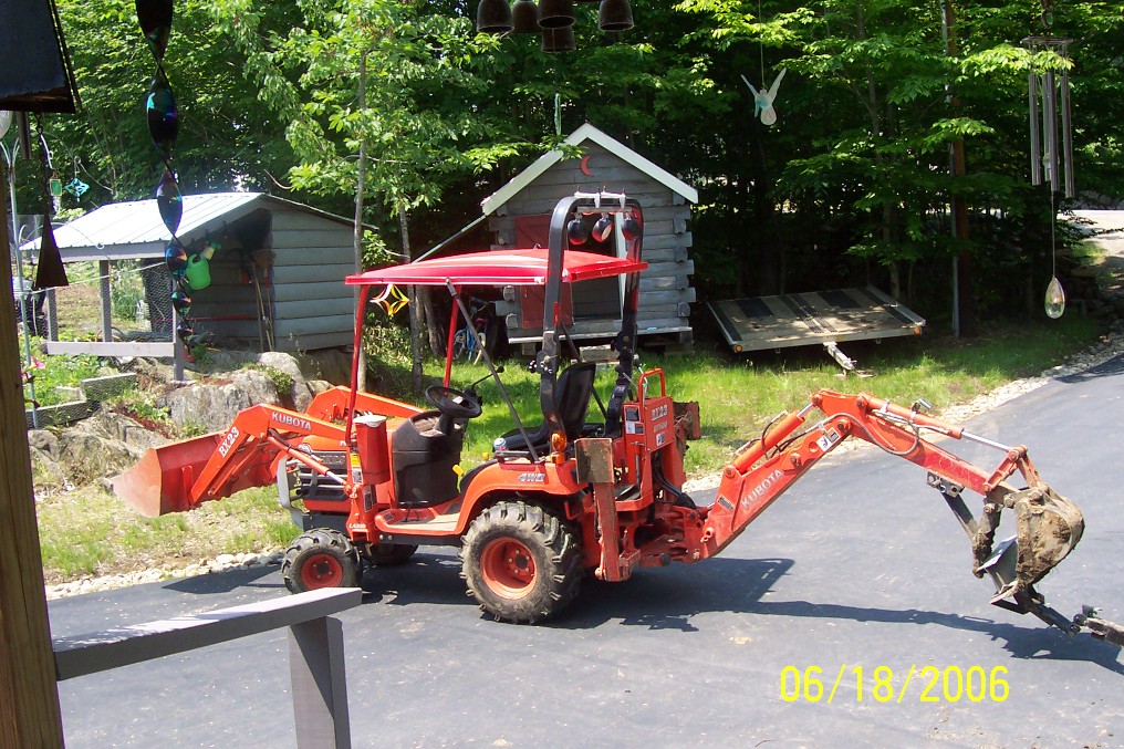

Well this probably seems silly,but i welded a reciever hitch to a chunk of i beam so i can haul my trailers around with my hoe and thumb.I use the 5 ft dump trailer alot hauling off debri that i load with the hoe and thumb.Never have to get off the tractor-grab the i beam and go

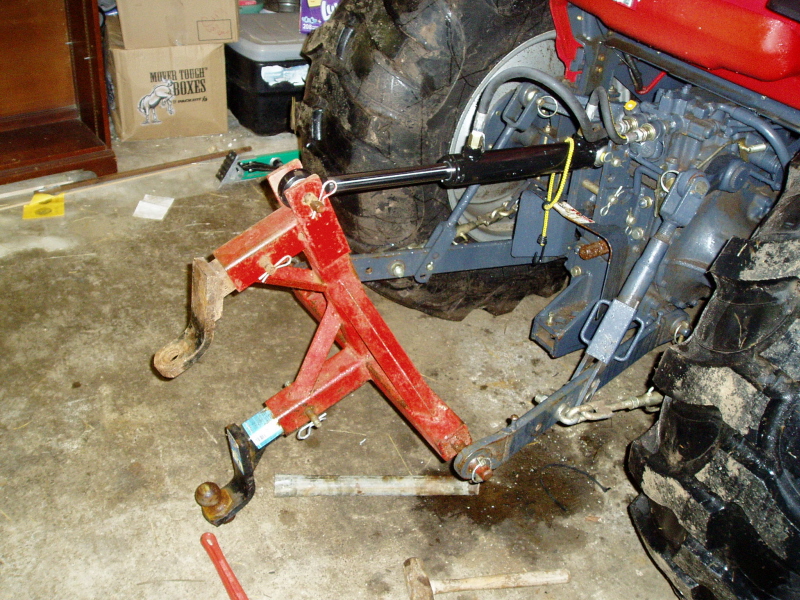

I have about a 6' long lifting boom, and a subsoiler (made from and old bush hog blade) that fit in this. Both attachments use both sockets.
