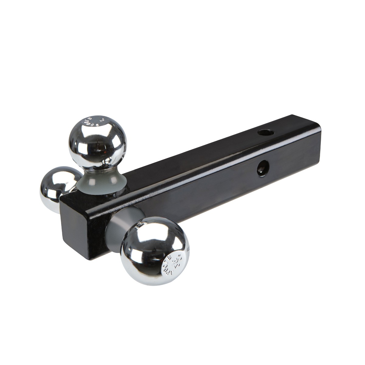

is this the most common size ball for a back hitch i want to put on my tractor? is this the normal most used size? i forgot what my last truck had on it.

2” is the most common. 1 7/8” is for light stuff that get pulled behind little cars. 2 5/16” is for heavy trailers like car haulers and big cargo trailers.
Beyond that it’s into the commercial stuff.
Edit to correct 2 5/16” size.

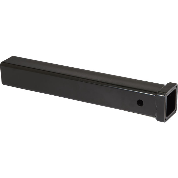

It depends on what hitch is on your trailers. All of my trailers are 2 5/16". If you have different size hitches on your trailers mount a 2" receiver on back of your tractor and get a tri ball hitch to plug into it.
Agreed, for a tractor that is probably going to be used as a "tug" for all sorts of stuff, a tri-ball is the way to go.
