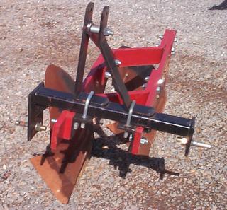

I found a 2-12" plow. the dealer wants $400 for it. Can I do better or shoud I grab this one, In my area it's very rare to find a 2-12".
2001 Outback MPH212 Plow
Stock number: n/a Serial number: 326010895
USD 400

DDT, make sure the plow will fit your 4300. I had a 2-12 Ferguson plow that would not go far enough to the left so the right rear wheel would ride in the furrow. An older JD 2-14 fit fine.

That price seems high, as this plow has very little means for adjustment and it appears to be without coulters to cut the sod ahead of the plow. Condition-wise, this plow, however, looks to be in good shape. The comment about it fitting your tractor is an important one to consider too.

This plow should fit left to right, I it just like my 1-14" plow. I don't think I can pull a 2-14 so a 2-12 would be a good choice for me. In my area this is a very rare find, but I have not found one any cheaper. I have not talked to the dealer yet about coulters or a manual. the dealer is 130 miles away but my brother lives very close, I know he could deliver.

You may do a lot better at an auction for a 2-12 complete... they are rare here in the NE US as well...
If you have to buy the "rest" of the pieces... it would end up economically unfeasible... /w3tcompact/icons/crazy.gif

I checked out farmstar and they list a 2-14. again I would fell better with a 2-12. I have priced a howse 2-12 there about $550 with the freight.

A little patience... an auction... some luck for a 2-12... ~~ $150-250... complete.../w3tcompact/icons/grin.gif

Before you pay a lot of money for a 2-12" plow, let me ask what you are going to do with it? If you're going to be breaking new ground every year, then 2-12" is probably what you need. But, if you're like me and re-plowing and existing garden or something, then you could get a 2-14" and take one bottom off the first year. Then, every year after that your tractor could probably handle the 2-14" plow in the already broken soil. Just a thought.

I plow alot of small and large gardens for hire. A 2 bottom plow would get it done lot faster. most of it is broke ground, but there is alot of new every fall so I need to keep my one bottom for those places.
