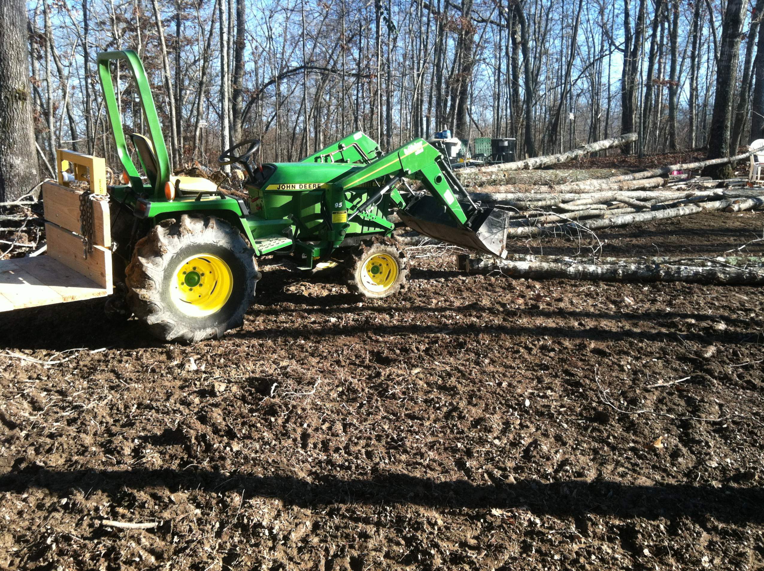

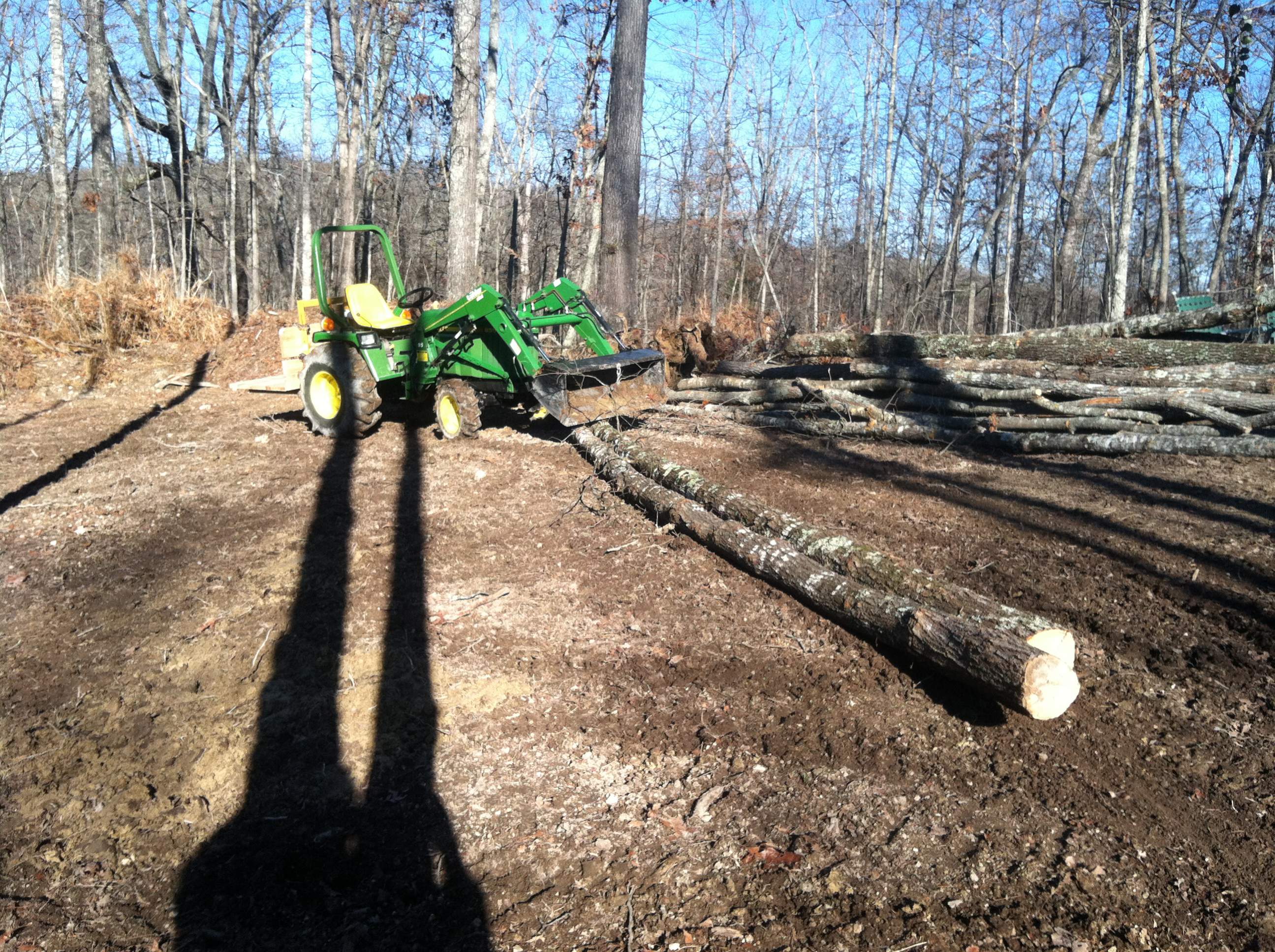

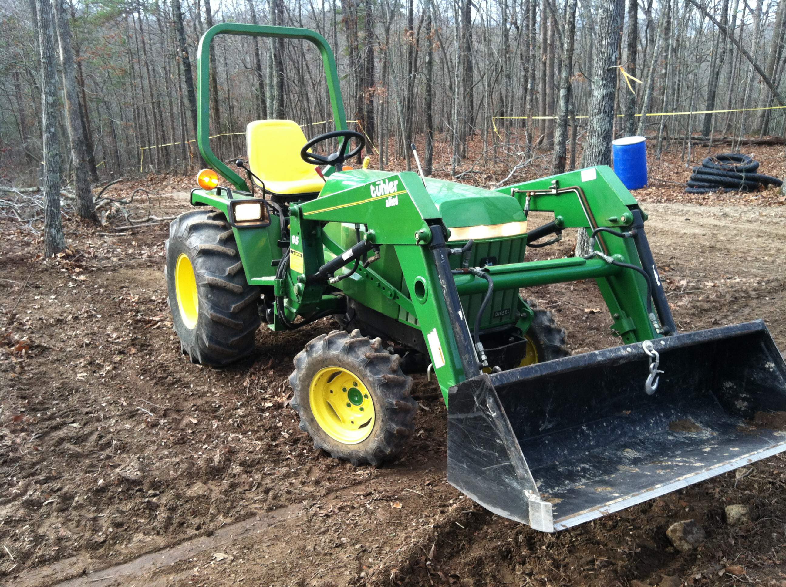

I recently got my 855 and love it ,way stronger than I even imagined it would be and I have 2 properties I'm clearing at the same time and it skids logs with little effort , I filled the rear tires with anti freeze and the fronts are foam filled and heavy ! and mine will lift the front tires off the ground easily ! I want the #7 hoe and will have one as soon as I find one in good shape and reasonable priced . I found all the books on cd in ebay for $10.00 and free shipping ! Post some pics of your 855 we don't get to see alot of them because so many people finance their tractors and that leads to most posts dealing with new machines . 001.jpg008.jpg007.jpg011.jpg
