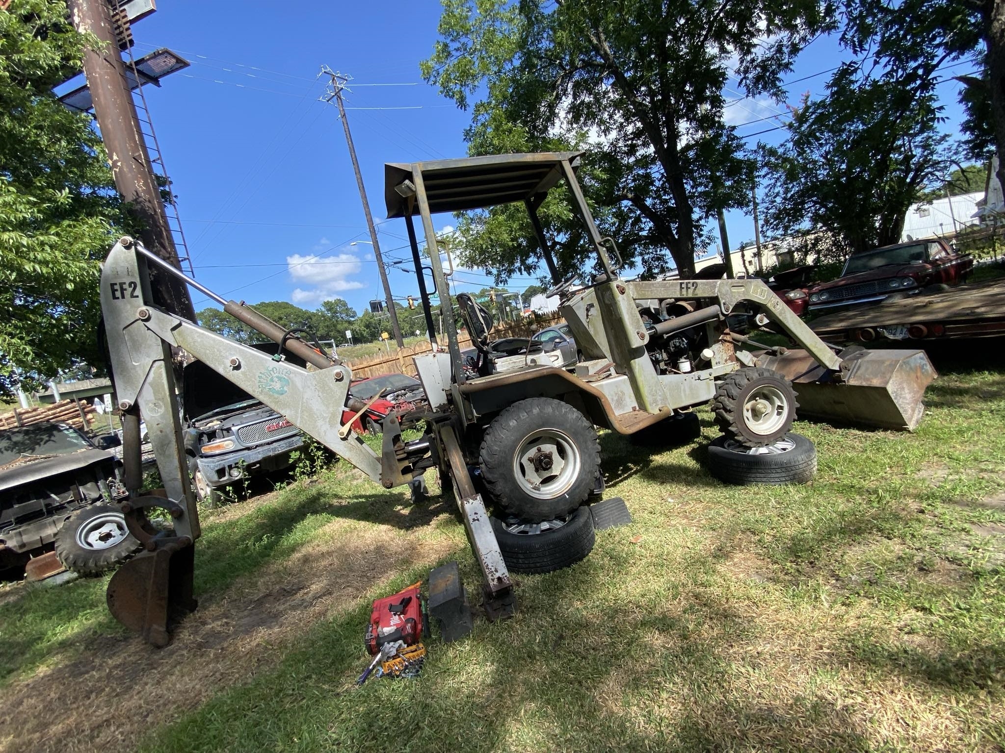

1998 EarthForce EF2
Got my first tractor/backhoe yesterday..

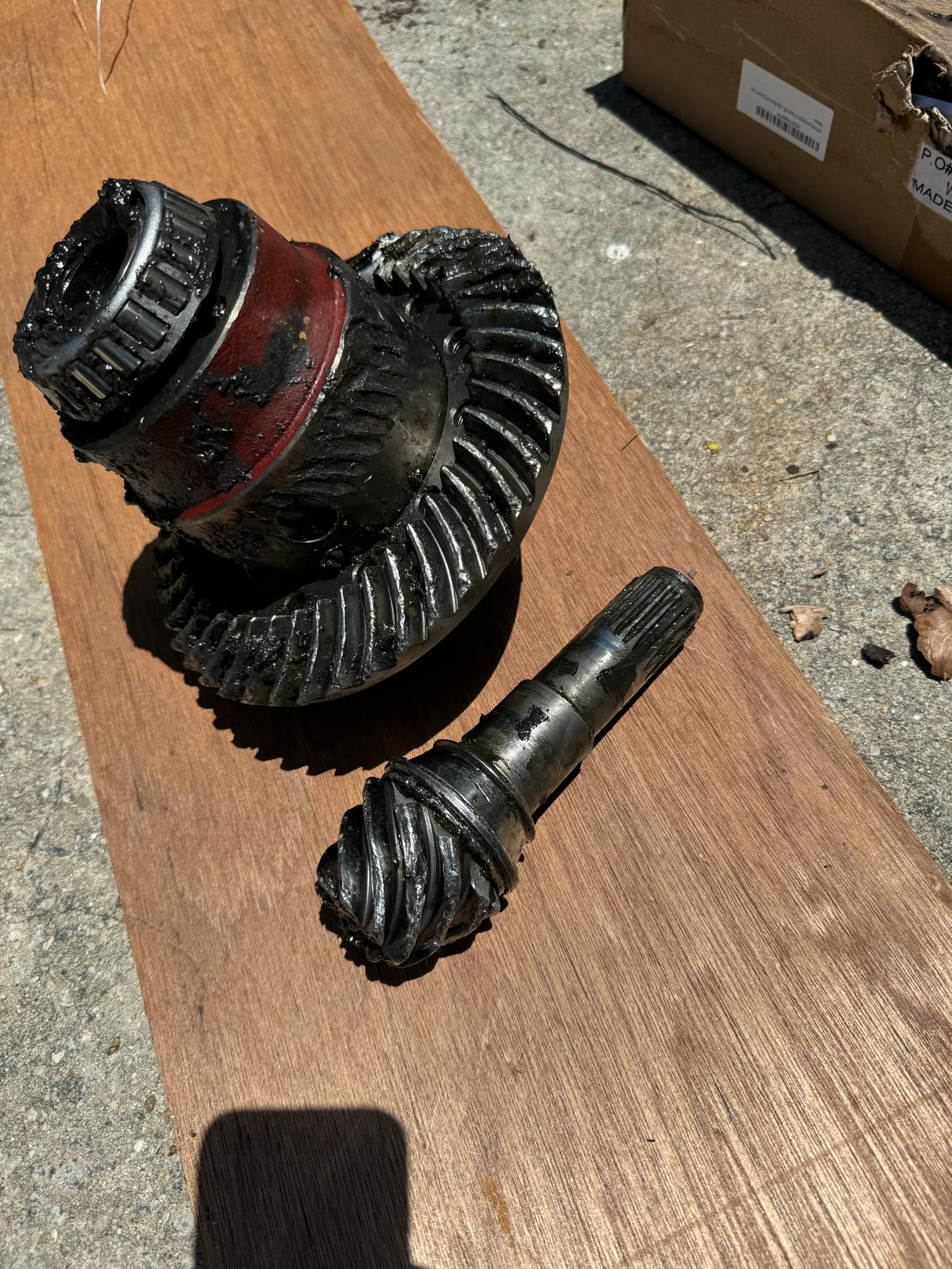

great price because the rear end was bad (poping) ring n pinion shot..
I have noticed one or two things that dosnt seem right and would love to see and exploded parts diagram for the drive to rear and the rearend itself
its a 1998 EarthForce EF2 2wd 3cyl kubota
sat for maany year and runs great !
I yanked the rear out last night but no luck finding parts or a manual yet.
has the Carraro Rear 140557 HS 8.06

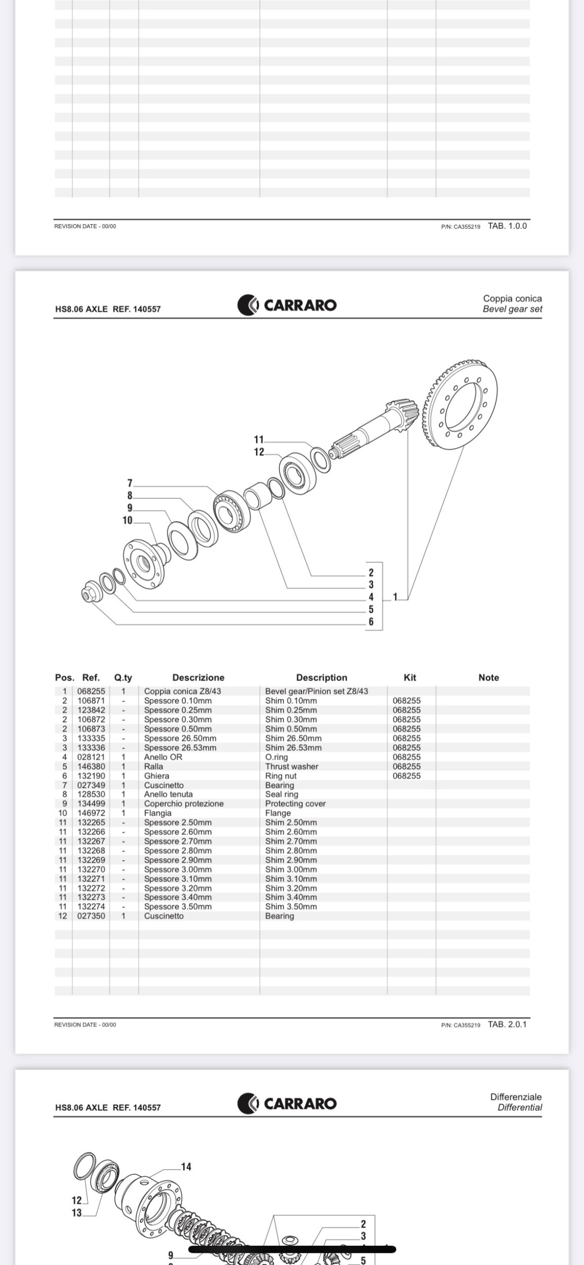

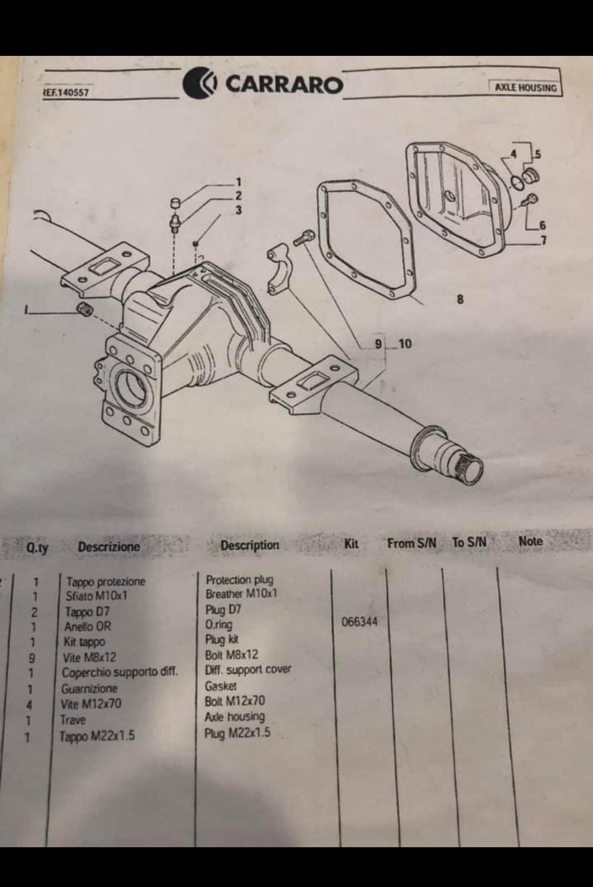

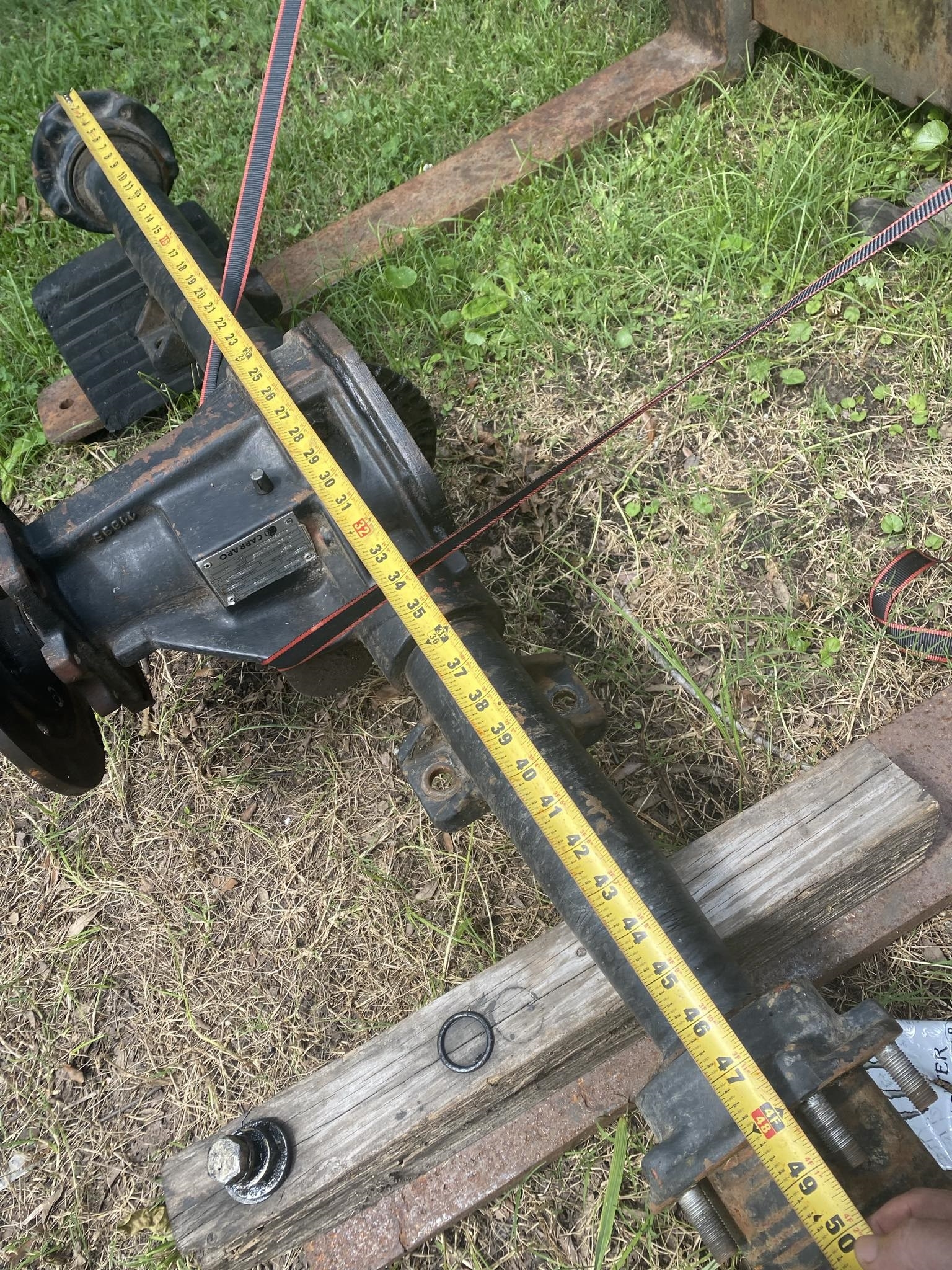

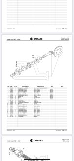

I got the diagrams with part numbers ... all parts are over sea's Joseph wants $5k in parts for the bevel kit (ring n pinion) and $4k to do the service .. hahahaha yea NOT gonna happen.. sooo Looking for a decnt used rear that will fit near the Savannah Ga USA area.. 4foot from hub flang to hub flange with a 4 inch off center.. can be a little bigger
