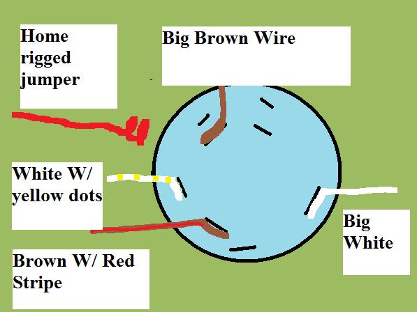

Here's a little pic of what I have. Still Can't get the bleeding thing to crank though. guy at the shop told me how everything goes back in but still no bones. I'm hoping my nephew didn't let the magic smoke out of something on me. :confused2: The jumper is something my father in law did when he was still alive and I'm not sure where it goes for sure I think it goes to the solenoid but am not sure which wire it is supposed to sit with if it does.

Look on the bottom of the fuel pump (right side of the tractor facing forward) there is a wire attached which should match one of the wires at the switch. I suspect this will be the brown/red striped wire, as on my 3430 its a faded pinkish color/brown stripe. The terminal connection on the switch shown in your diagram for this wire attachment, should have constant power with the switch in the on position. This leaves the remaining wire which should then run to the starter solonoid and connect to the momentary contact, (start position) of the ignition switch.
The red wire you mention concerns me since you indicate it was added. This makes me suspect a broken wire between the switch and connected load. (starter solonoid?)
You mention 2 large wires, brown and white connected to the switch, are they both the same size or is one larger than the other? If different sizes then probably the larger of the two will be direct power from battery to switch, and the other carries power to the various instruments. In either case you need to establish which wire is hot, and supplies power to the switch.
At this point you need to, as mentioned above:
1- find which wire supplies constant battery power to the switch.
2- establish for sure which terminal on the switch does what, finding the key on constant powered terminal and momentary on start position.
3- trace the color coded wires to they're respective terminations and find out what the red jumper wire you mention does, where it terminates at.
A test light, and/or ohm/volt meter is going to be needed to reliably check these functions.
keep notes, and draw diagrams if needed and as you sort out each wire connect it to the proper location on the switch.

Relative to the non-stock red wire, the most common reason for added wiring on these tractors is to bypass the neutral saftey switch. The red wire probably runs from the key switch to the starter solenoid coil. Accordingly, make sure the both speed and range shifters are in neutral while you are playing with the wiring on this tractor.

Thanks for taking the time to help gents. I'm good at tearing an engine down and can wire a house or factory and at one time was a lineman ( some irony there huh? ) but for some reason the electrical system on this thing (and cars and trucks) seems backwards to me.
The large brown wire is much bigger than the others and has a larger terminal end on it that matches the big terminal on the switch. the large white wire has the same size terminal as the others but the wire is larger than all of them except the brown one. The guys at the shop said the brown/red striped wire is for the "heat" (glow plugs) and the white/yellow dotted wire is for the safety switches. I have forgotten what he said the white wire is for (don't have the hand drawn diagram he gave me. not a good one at that).
On a slight side note, the guy at the shop didn't really have anything except the same wiring diagram I have I just hope he's right. I hooked all the terminals up like he said and I have the idiot lights come on when I hooked everything up like but still no cranking.
