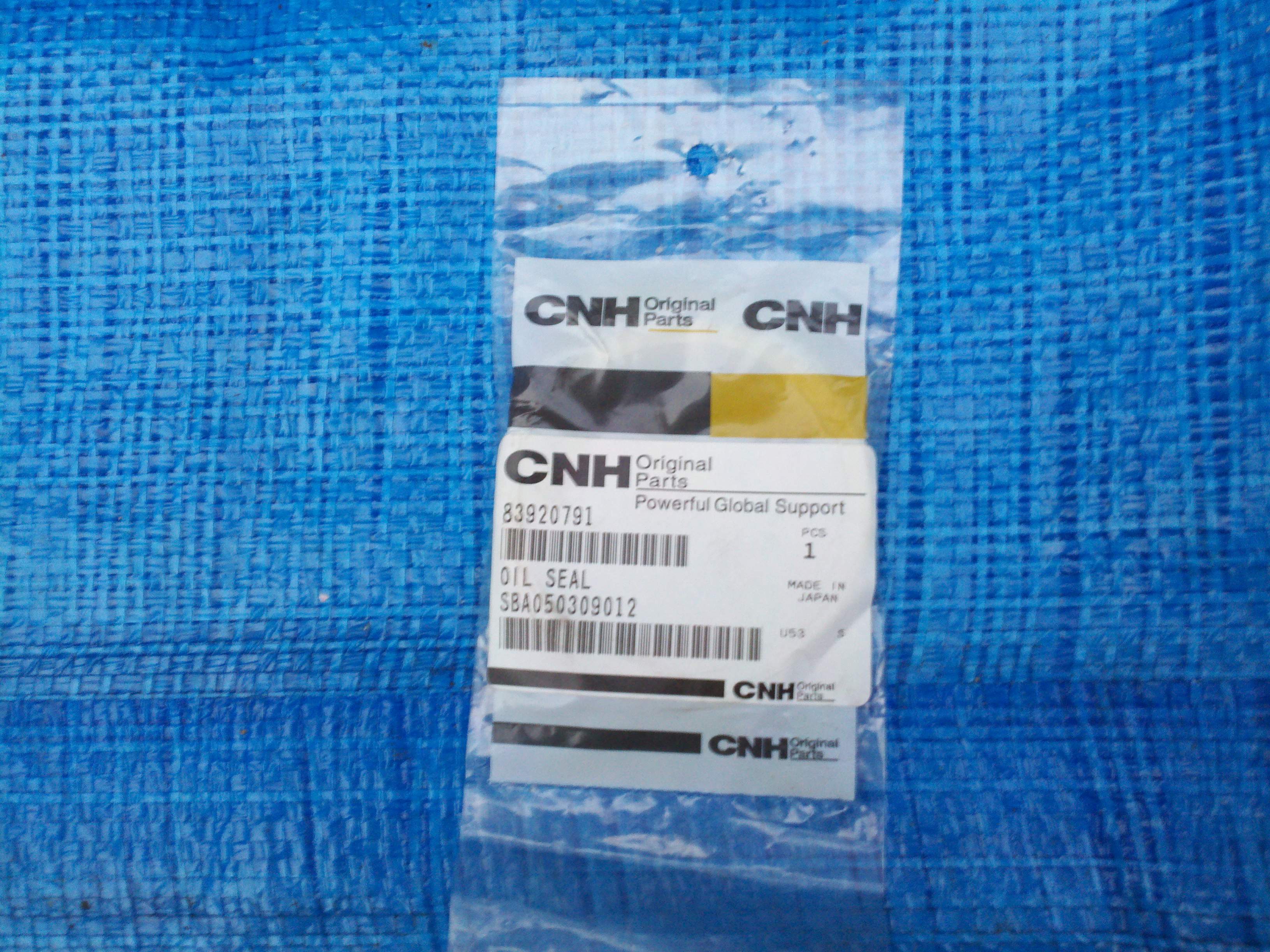

I didn't get my correct seal in this week so I will hold off on taking apart the piston assembly until it comes in.

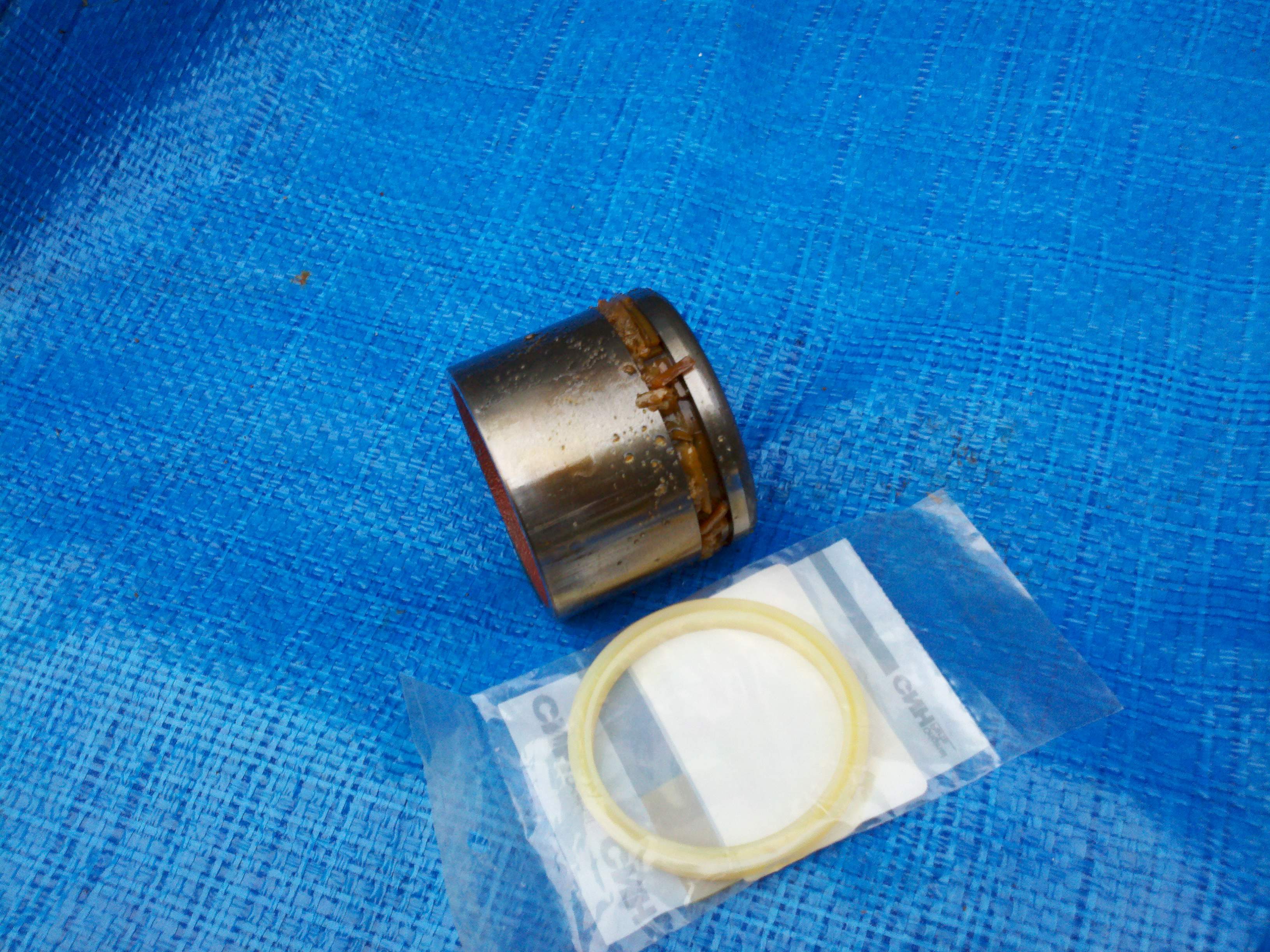

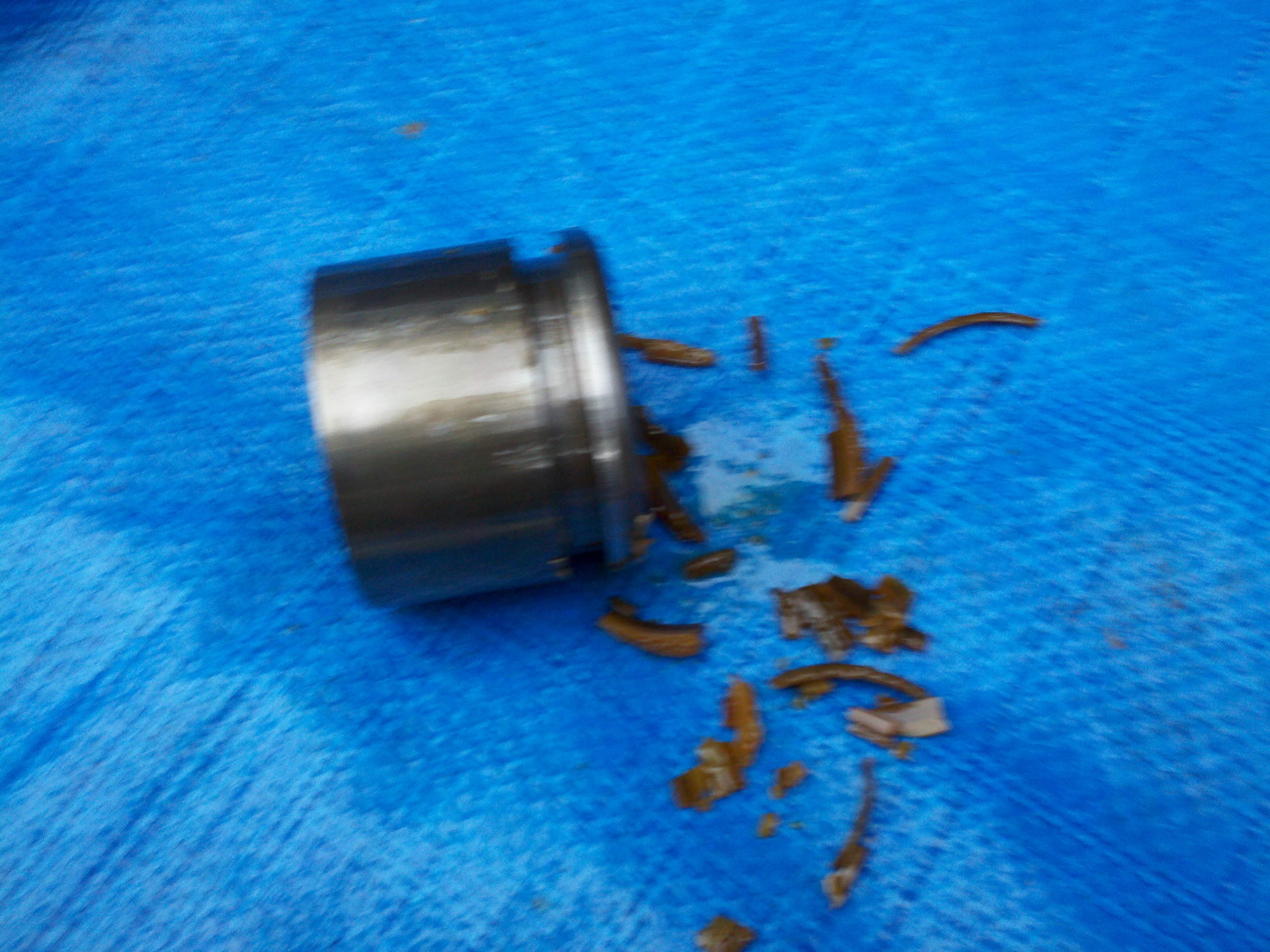

In a way I am happy to know that there is something to blame for the mediocre performance of my lift. The old seal, if you want to call it that, had no integrity whatsoever in its own composition. The only thing keeping it inside of the grove was the cylinder wall.
Once I make sure of the correct positioning of the replacement I will bless it and put it back together.
I don't recall seeing a picture of one so deteriorated.
Do I win a prize?
Thanks for all the helpful posts and photos.

That tells me your piston fits pretty well and once you get a real seal you should have great performance!

That is exactly where it is. There are six bolts holding it on 19mm wrench size. My replacement went flawlessly. It was very easy and quick. I have not fired up the tractor to test my work so keep your fingers crossed. I don't anticipate any problems with my work.
With the old seal on the piston it just slid out of the cylinder. With the new seal it is a tight fit as it should be.
