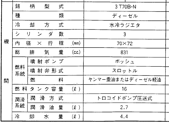

Does the engine still have the ID plate near the starter?
If so, does it define the engine as the 3T70?
The 3T70 is extremely rare. The only other tractors using this engine are the YM1301, F13 & F14. There was never 2T70 nor a 2TR70 engine ever made. So, there isn't common 70mm piston, sleeves, rings to be had easily.
I do have a 3T70-B engine manual should you need it.

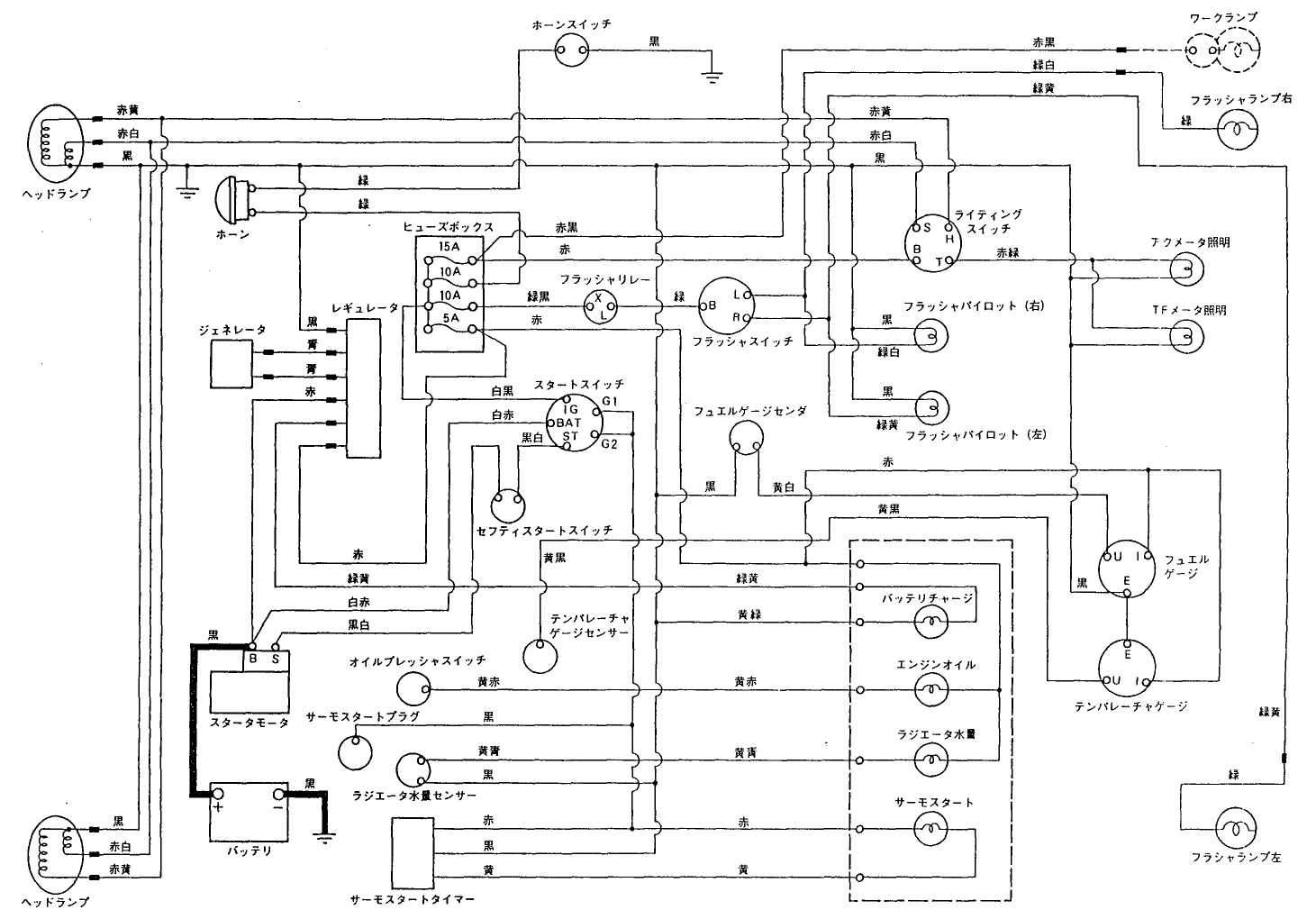

The electrical is very close.
It does have the ID plate, I’ll take a look this week and report back
