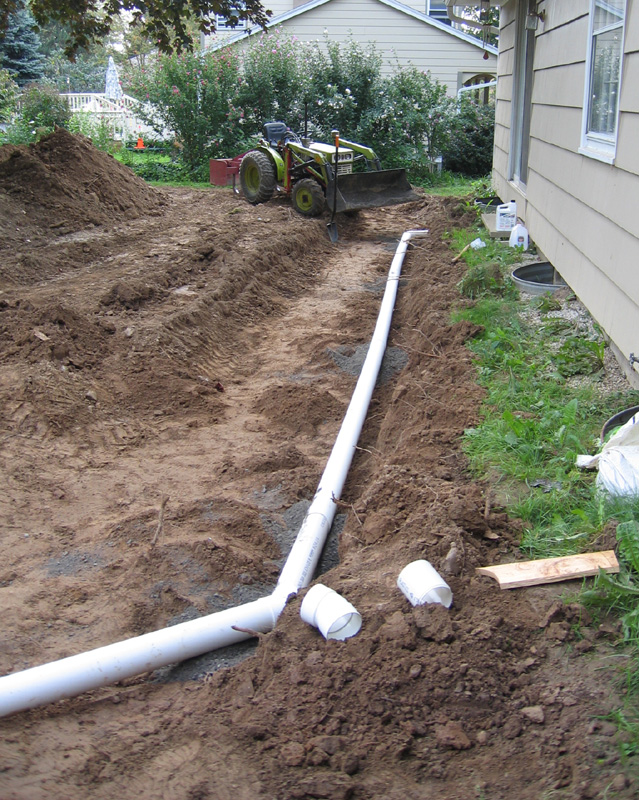

I bought a 155D last year and it's great for my small property. I paid $4200, 720 hrs on meter (probably 1720 but seller swore it was 720) It came with loader and 42" bush hog. I'm 6' tall and I fit OK. Good luck! In my opinion, it's much more useful than a garden tractor.
