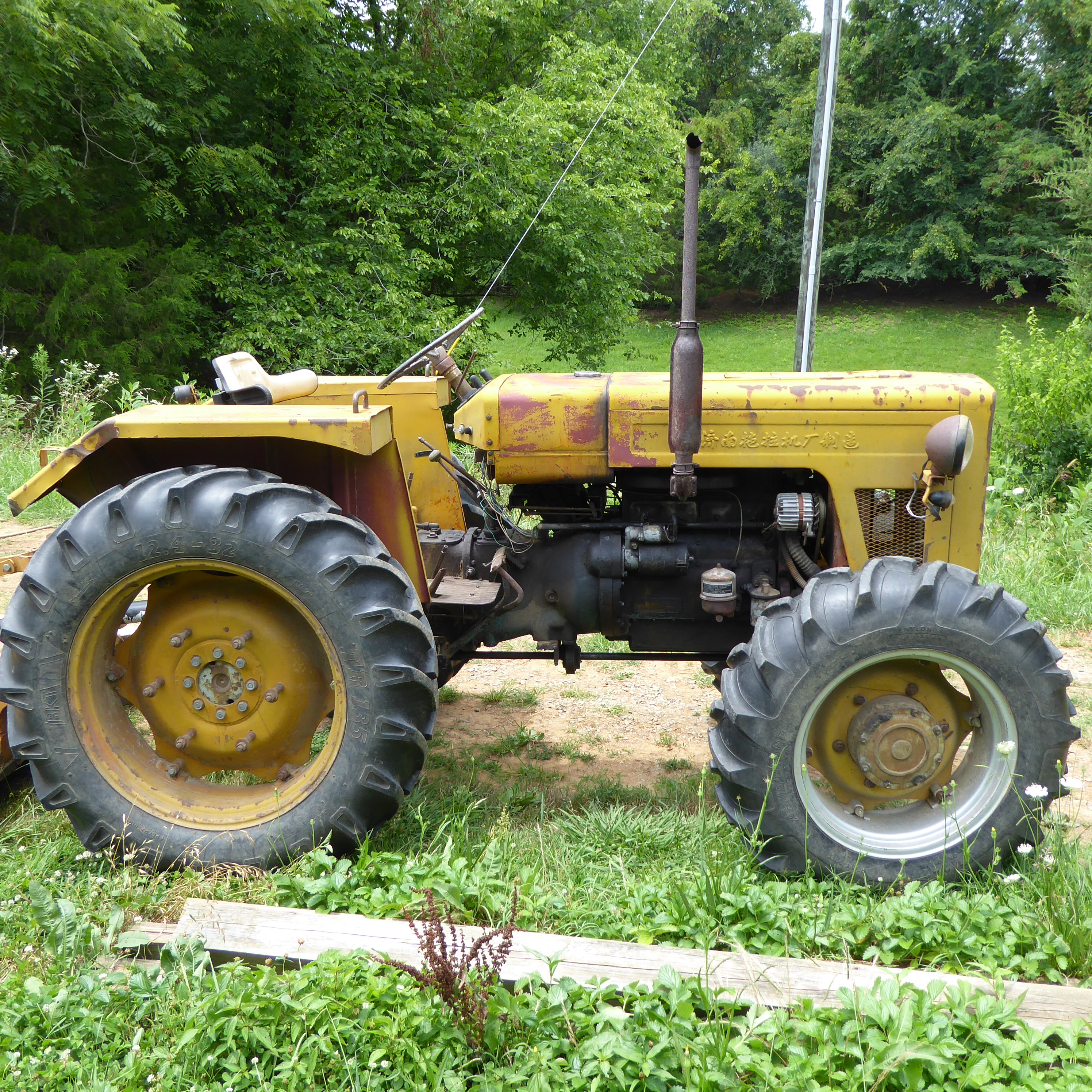

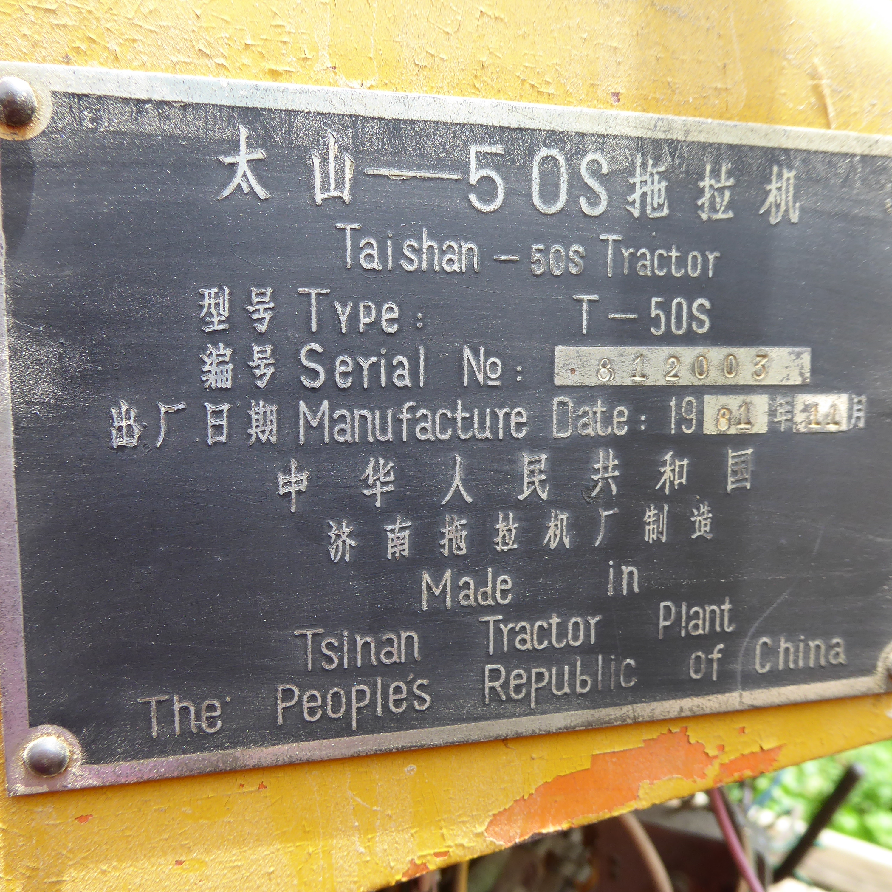

Hello all, new member here asking for ANY help finding parts. It is one of the first Chinese tractors brought into US in 1981. Since the factories and companies have changed so much, the dealers I have talked to can't or won't help. It has been and still is a hard working farm tractor that's starting to need parts.

Welcome to the forum, that looks like a pretty decent tractor. I am of no help regarding parts, perhaps others can help. It's very unfortunate that some of these products are marketed here without setting up a spare parts system. It may be a knockoff of a more common brand, hopefully for you a close enough copy for parts interchangability.

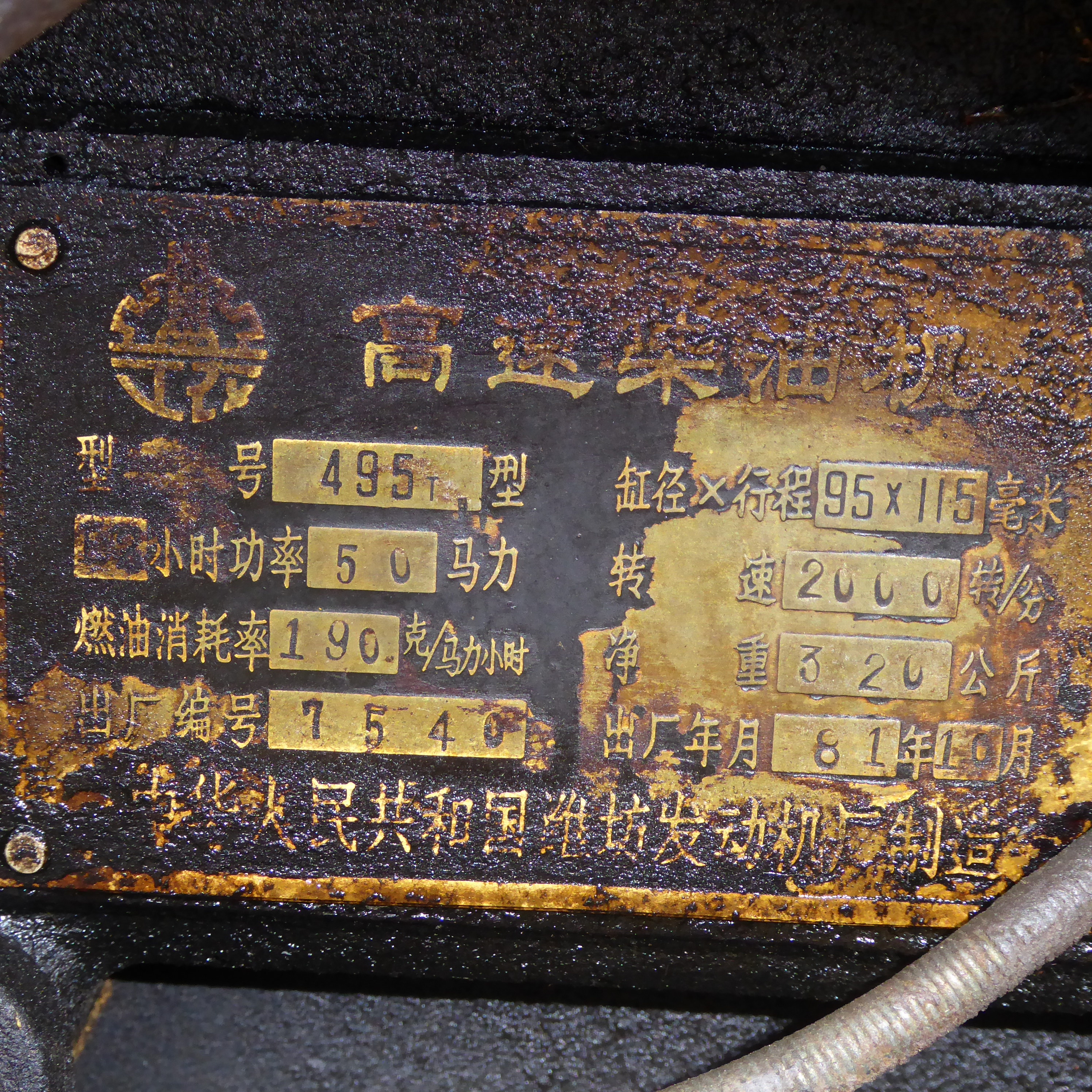

The "495" engine model indicates that it is 4 cylinder with a 95 mm bore, which doesn't really mean too much. But, speculating that it is a TY-495 adds to the flavor. So, then it could be a Jiangdong (JD) engine. Look for a diamond with JD inside inside it on the left hand side of the block. Most parts for these engines are plentiful because of the commonality with the TY-395 engines.
/ 1981 Taishan T-50
#11
The cast emblem on the left side is a circle with a w and a big T going through both. (sort of)
Mark at Tytan said he was pretty sure it was a old 504 engine, but was not sure what the new engine equal is.
